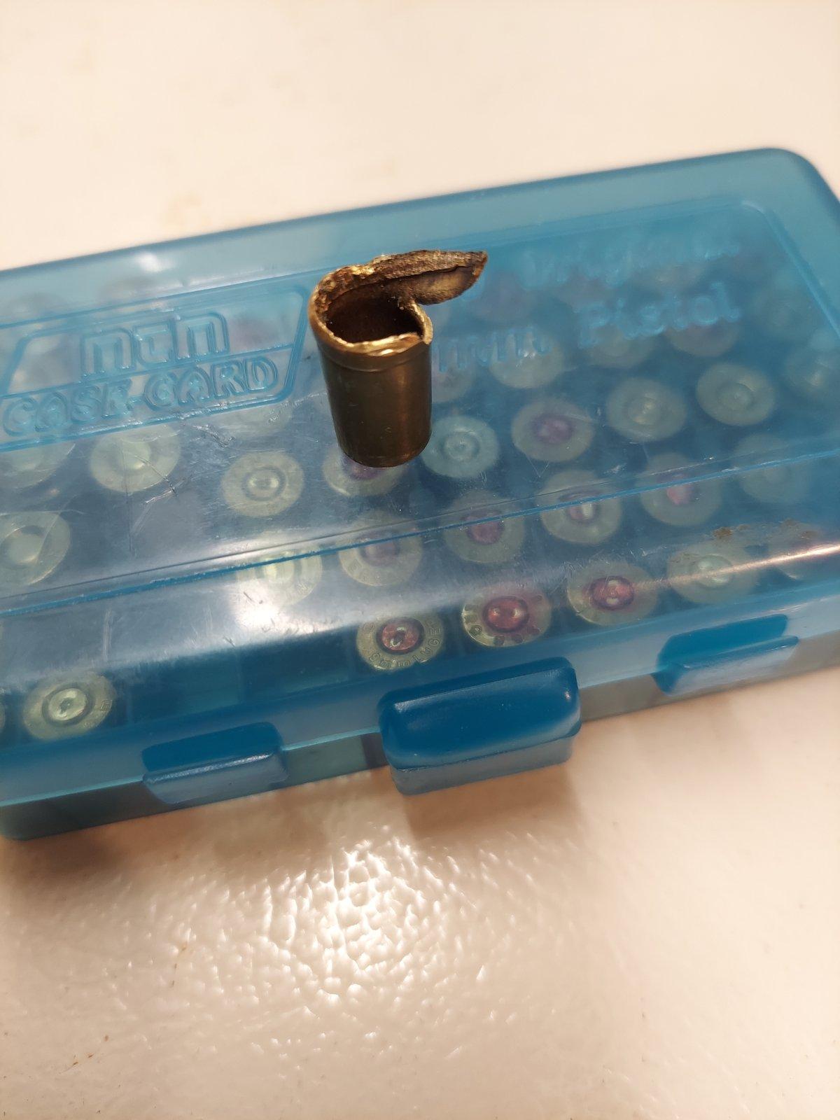

This stuff did the same thing in my G19 X. I thought I had pulled the bullets in all of it and dumped the powder. Evidently I missed a few.

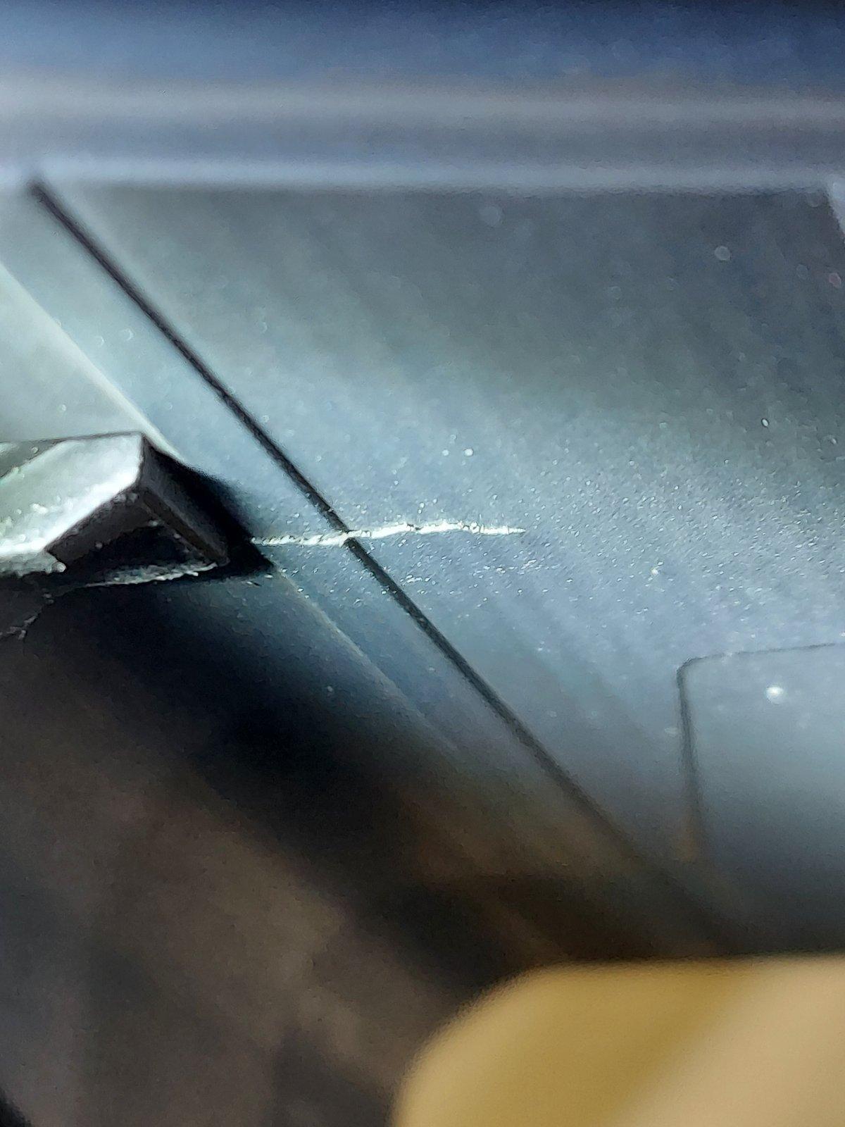

Anywhoo, got me a new RXM yesterday morning, grabbed a box of mixed rounds and hied me self off to the sand pit. Topped off both magazines and proceeded to make small pieces of blue rock out of big ones. Six rounds in and, damn, my hand stung a bit!
Blew the mag out and there was carbon marks on the tip of my trigger finger, the base of my finger by the mag release and the heel of my hand at the bottom of the grip.
Picked up the mag, stripped the rest of the rounds out, looked things over and saw no apparent damage. Reloaded with known factory rounds and fired a magazine full.
Went home and stripped things down for a closer look and found this.
Bottom right corner of mag catch.

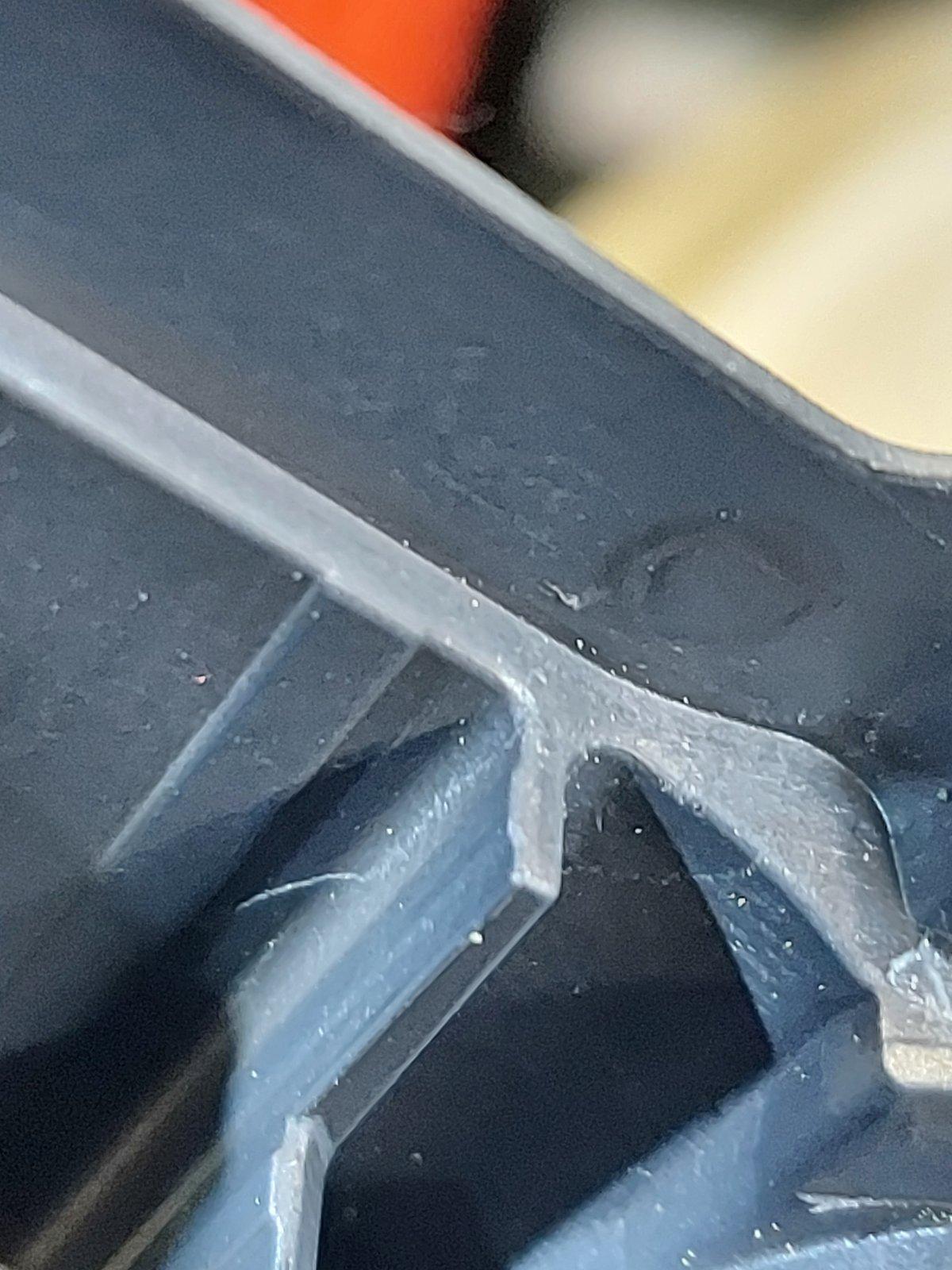

Top right of mag well.
At least a new grip module is relatively cheap.

On the bright side a new grip will only cost $39.00 from Magpul and about 15 minutes to change out. Over the years I went through many fractured grips on LCP's. Later moved to the Pico with the modular design and so easy to change out the grips or work on. (even though the Pico never suffered a crack with thousands of rounds shot through it).

I'm glad you are ok. On the bright side, you got a great piece of bench brass to remind yourself of your error. Looks like it could be used as a tool as well.

Not handloads per se. "Remanufactured." Loose in a plastic ammo can.
Okay, to be clear, these were "remanufactured (handloads)" that had ALREADY caused you a problem, is that what I'm getting? Suggest editing title to: Here are reasons why you need to KNOW what you're feeding your (fill in the blank_______________:)
