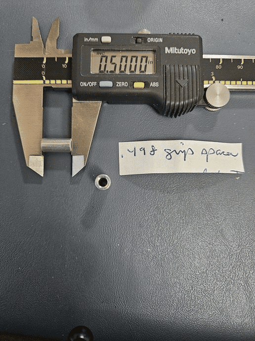

You can find these at most any hardware store. I usually file them down to .498". That can vary, though. Try them at .500 and file just to the point where your grips are tight. Go slowly!
Hi Cholo, The spacer you showed looks like it is metal, like aluminum. Am I right ? If so, do you like those better than the typical white nylon ones?
As noted,, the ones shown are aluminum. They work just fine. Cary used to put them with all his grips he'd make.
I prefer the nylon ones as they tend to be easier to find, easier to work down, and do the job. I also prefer to cut them down to .495 due to the varying frame thicknesses I've found over the years. The grip frames are polished a bit after casting,, and come in often a tad under .500 in width. Using .495 has worked quite well for me.

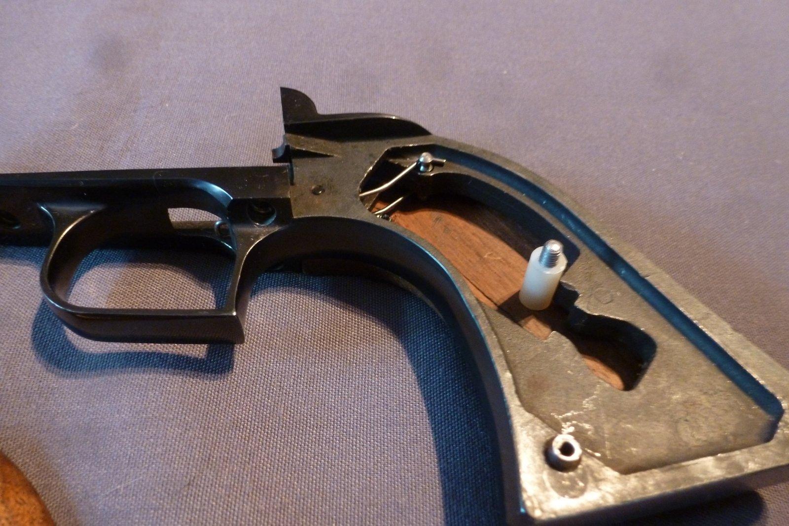

A pic is worth a thousand words…I didn’t have a chunk of nylon or aluminum handy- but you can get the idea of what I’m talking about.

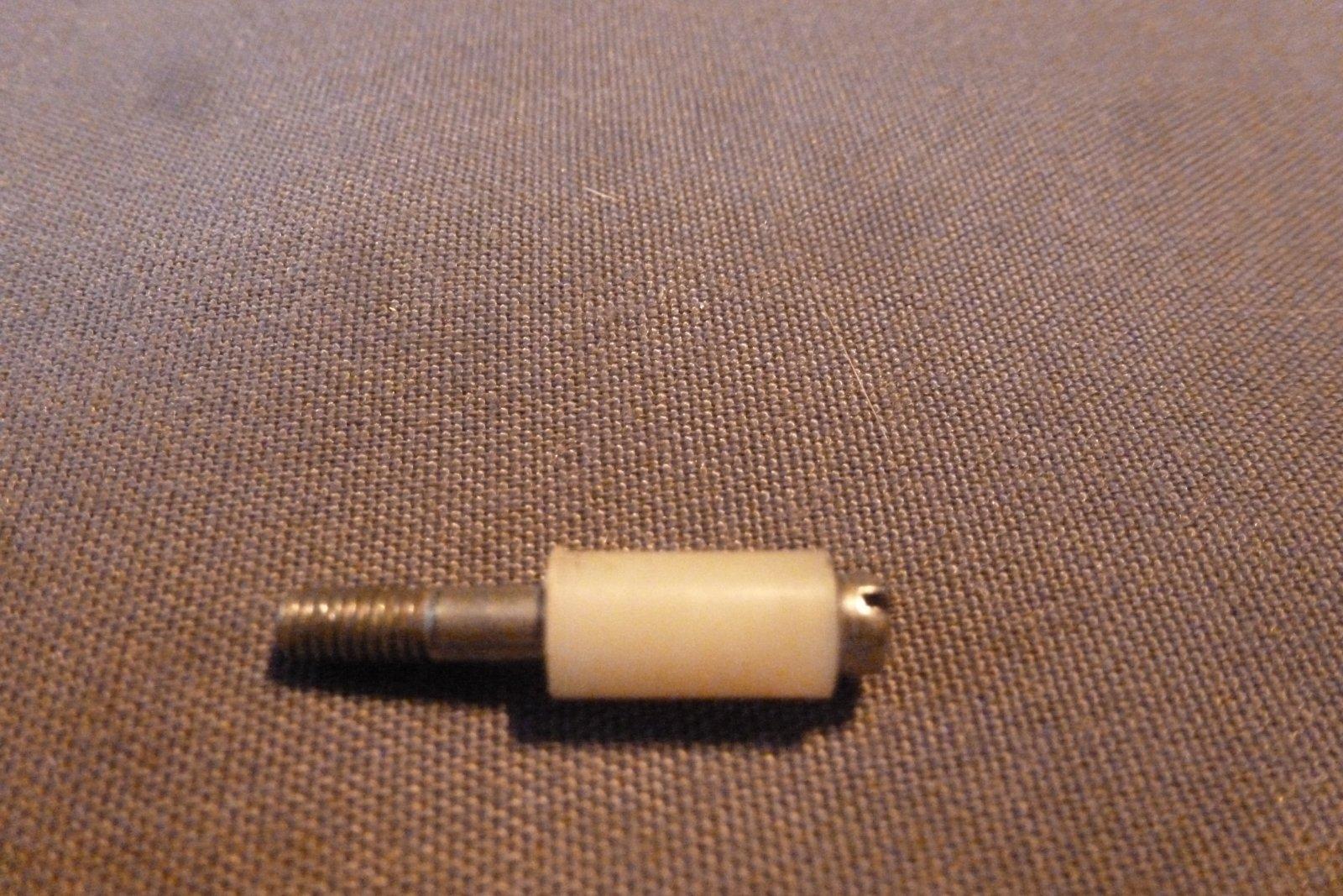

I know a lot of you guys have been doing this a long time and have your own systems. Whatever works, works.....For me, I think I have found the way to go, so far at least....Last week I went to a large Ace store. I looked through the different types of spacers, all nylon type. Prior to this I was using the standard white nylon 1/2 " spacer. Then I tried to apply a spacer on an old model SS. That standard spacer could no way go thru that small space area. I thought to myself, I have to find a better way...hence my trip to the Ace store.....While there I looked and picked out some possibilities that might work. Well I think I found the way for me anyway. They had a black nylon spacer close to a 3/8 " size in length (but I think it is metric?) I also picked up some small thin white nylon washers. Anyway, I inserted the screw through the panel and when the screw poked through I put one of the washers against the wood and then put the black spacer over the washer, then put another washer over the end of the spacer. Then I screwed the screw into the other panel. Presto. It fit solid, flush, and square with that spacer right smack dab in the middle of that old model SS grip frame. Not loose, not tight, just right. The grips are flush and solid. No cutting, no grinding, & no sanding.....It works for me......I did this just last night ....Then I tried the same system on my NM SS. This one in 32 H&R. It worked ok, but it wasn't exactly perfect as I noticed a very slight little play movement on the top of the grips. I then took it apart slightly and added just one more washer onto the gun screw. So this one side had 2 thin washers on it. I screwed it back together and it is perfect. Tight, square, and flush all around. Again no grinding or cutting.....It works for me !!! Again, I know everyone has their own style on how to do these spacers, but for a new guy, or a guy with very little or no tools, I think this is the way to go .....I will go back to this Ace either Wednesday or Thursday and will get a few more of these spacers. When there, I will check the part numbers on them and even the washers if anyone is interested. 👍
Yeah, that 2nd photo shows like it was manicured to fit in there. That sure looks like a custom job. As far as the busted wood panel, yes I have seen that before, I am sad to say, on 2 of my guns. I caught on your last post about the Bearcat being hard to do. I guess you did it though ?? Looking at your spacer, wow that sure is a thin one...Wait, is this a photo of a Bearcat ? No, it's too big. I wouldn't really know as I don't have a Bearcat.....Thanks for sharing these photos. It is true a picture is worth a thousand words. What gun is this ? It's hard to tell looking at the trigger area ?? Just wondering....🙂
Yeah, that 2nd photo shows like it was manicured to fit in there. That sure looks like a custom job. As far as the busted wood panel, yes I have seen that before, I am sad to say, on 2 of my guns. I caught on your last post about the Bearcat being hard to do. I guess you did it though ?? Looking at your spacer, wow that sure is a thin one...Wait, is this a photo of a Bearcat ? I wouldn't know as I don't have a Bearcat.....Thanks for sharing these photos. It is true a picture is worth a thousand words. What gun is this ? It's hard to tell looking at the trigger area ?? Just wondering....🙂
I just noticed the SBH , and I don't have one of those either. I have to be satisfied with a regular Blackhawk. I did look up and saw the inside of the Bearcat grip frame. That is a tight fit from what I can see. I have never shot a Bearcat. Maybe some day. You never can tell.
I just noticed the SBH , and I don't have one of those either. I have to satisfied with a regular Blackhawk. I did look up and saw the inside of the Bearcat grip frame. That is a tight fit from what I can see. I have never shot a Bearcat. Maybe some day. You never can tell.
