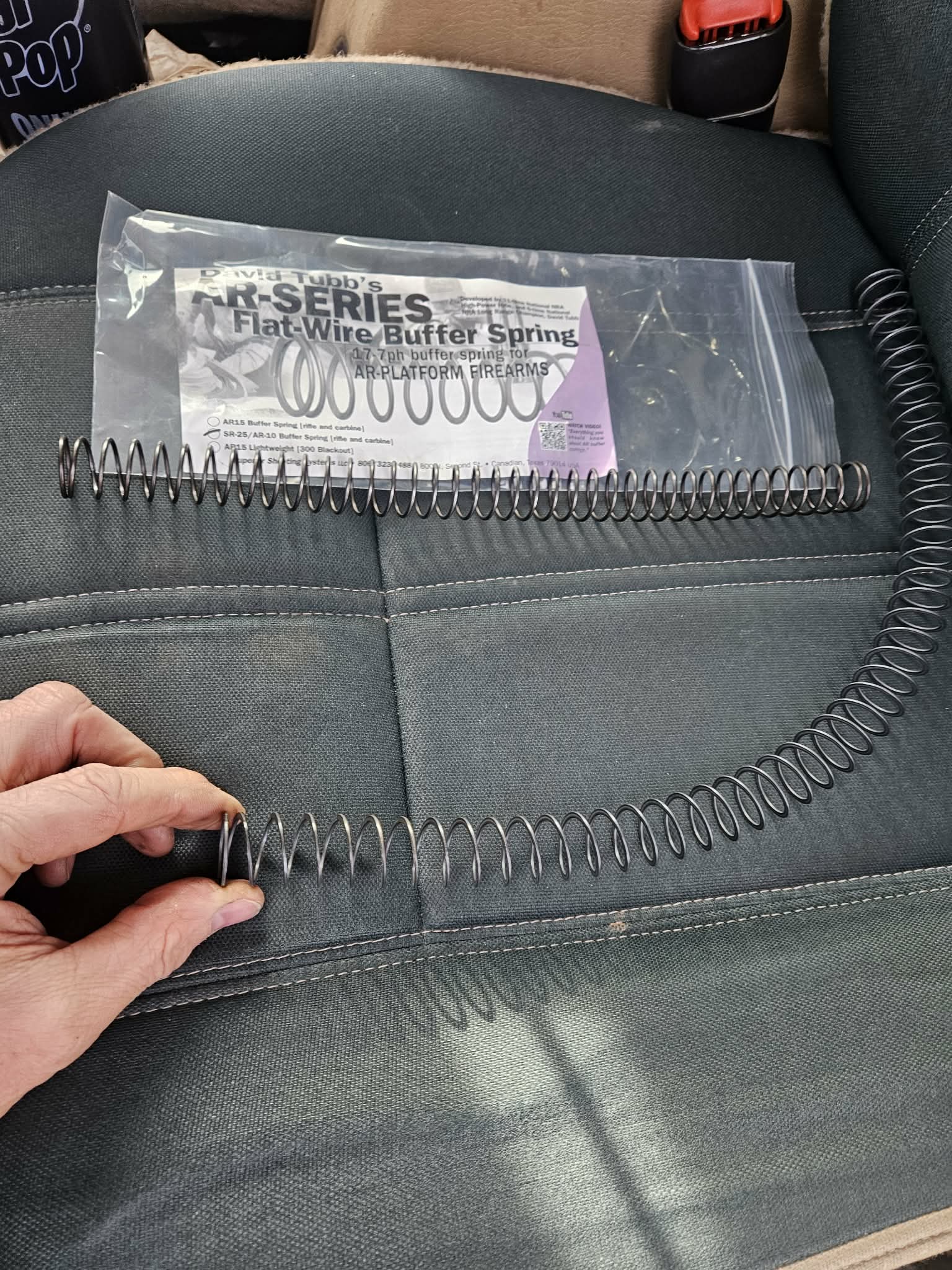

Looking for a response from @LDH or anyone else who went with the Tubb's spring.
I had a heck of a time getting the whole spring to fit in the buffer tube! I'm wondering if you guys went with the AR-25/AR-10 buffer spring or maybe an AR-15 spring? The AR-25/AR-10 is what Tubb's recommended so I went with it but I've found that the SFAR seems to be a mystery to a some retailers so who knows...
I am 99.99944% sure I used an AR15 spring. When I get back to the house this afternoon I will check as I think I kept the wrapper for just this scenario and of course I can easily pull it out of the rifle as well.

For clarification I did go with a gas block and would agree it is the answer to getting the SFAR running right. Which gas block did you go with @Mobuck ? I had the SA already, but I really like the Riflespeed one better.
Like I said above I had already ordered the spring so I still used it when it arrived and can't really say it made any difference. I ordered it because on some forum somebody measured theirs out of their rifle looking for suggestions on a replacement and we had the same coils but mine was shorter so I figured maybe mine had some wear, which at maybe 1000 rounds seemed odd but for as cheap as springs are might as well just replace it.
When I called and talked to someone at Tubb's Springs he said they've been using the same spring that they use in the SR-25 for the SFAR.

I have to think the guys at Tubb's know what they are talking about but it just seemed like that spring was way too long, again it was a real pain getting it to fit in the buffer tube.
LDH: Did you call in and follow their suggestions, or did you order whichever one you have on your own?

My apologies for latency. Confirmed I used a Tubbs Flat Wire AR15 spring 17-7ph
Did they recommend that one, or did you pick it out yourself?
I was leaning that way but they said the one I got was the right one for the SFAR.
I kinda wonder if retailers just don't really know what a SFAR really is vs an AR-10
I did my own research and made that choice on my own. I am not an armorer, but I have built more than my share of AR platform rifles in my time and what I have learned is NEVER trust a customer service rep as none of them have the experience of the workers in the field whether we are talking about Plumbing, Firearms, Guitars, Computers or whatever. They simply don't have the intimate knowledge to pass on to you.
