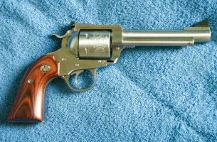

I reordered another Wiley Clapp which arrived today. The sights were straight, fit and finish initially looked great, trigger was crisp but heavy. However, once I got it home I discovered something that I mistook for grease on my cursory inspection. On the left side of the top strap, there's what looks to be a milling mark where the tooling that was intended to make contact under the top strap actually hit the side...or, the milling created an indent/crack in the frame. While the end result might be purely cosmetic, again I have to wonder about the QC on the SP101 assembly line. And in this case, I also wonder if this is safe to shoot for the long haul. I realize Ruger's tend to be overbuilt, but it is almost as if a stress fracture has been built into the gun. Provided this one shoots to POA, I'd like to keep it and I'll just live with the imperfection, provided it is safe. But, I also wonder if I should send it back to Ruger before shooting it and hope they can send me a flawless example. I do shoot reloads and don't want them to come back at a later date and refuse to warranty it based on that fact, when it is imperfect straight out of the box.
I've attached a pic. What would you do? Shoot the crap out of it or keep pushing until I get a revolver worthy of full retail?

That is a casting flaw, air pocket, pin hole, or the like. It may not affect strength gut personally I'd not want it.
Make the call, Ruger will give you an RMA #, & in my experiences UPS will pick it up & they will have the shipping label. They will usually take care of it quickly.

Appears to be a casting flaw. It, by itself, on the surface may be just cosmetic. But if there is one, are there or could there be others? I would send it back.

Second the casting flaw, don't believe it's a machining issue.
No way to know how many other flaws are in that casting, without x-ray/radiograph. I'm not too particular but I'd
be returning it.
By itself it may be cosmetic, but if it's got a bunch of other inclusions hiding in the same area, then not so much.
I’ve got a few Rugers and from what I’ve seen Ruger doesn’t make a perfect gun, but looking at yours I don’t think I would except that one.
Casting issue, likely minor but i've followed them (grinding them) a good long ways too. Contact Ruger and show them that photo. NDT should have failed that part and scrapper or repaired it prior to building on it...

Well, here's an update. I sent pics of the SP101 to Ruger and they strongly suggested that I not shoot the gun. They sent me a return label and on arrival the "revolver guy" inspected it and they informed me they'd be sending me a new revolver. I asked the very friendly customer service rep if someone who really new revolvers would look over the one they were sending to ensure there was nothing wrong with it, especially given that this was now my 3rd try to get a properly manufactured 3" Wiley Clapp in my hands. She informed me they'd be manufacturing the gun, not picking one from stock. Fast forward 2-3 weeks and I'm told the new gun is headed my way. It arrived last week. Barrel was straight, fit and finish was spectacular and I thought to myself...this is it!
But then, while doing a little dry fire with snap caps I noticed that once about every 10 fires, it would jam up. So I start down the path of identifying the problem and discovered that every time the gun was tilted up and to the right, the transfer bar would wedge into the right side of the frame. I'm used to guns with transfer bars with fore and aft play...that's normal, but this one has significant side to side play and is actually very loose where it attaches to the trigger. I compared it to my other SP101 and they were night and day different. So now, I have a brand new gun that I can't count on because if it is ever pointing up or tilted to the right, there's a better than 80% chance it will lock up.

We always sort of questioned the dove tail on that model. It just seems to be a weak spot. Now seeing a void in the casting in the same spot is alarming. What if a large void was there, just under the surface and it didn’t get machined into? I always thought they must xray the frames I guess they don’t.
I've had Rugers & S&W revolvers that would "jam up" when dry firing with snap caps while pointed up but not when cylinder was empty. In my case I found the problem to be the head of the snap cap was hanging up on the recoil shield. Where it bound was on the left side where the recoil shield is sloped to accept the end of the ejector rod and when I pushed the case head forward the cylinder advanced. Try dry firing tilted up without snap caps to see if it's the problem.
IMHO, I'd see if at this point (having taken delivery) Ruger might replace it and keep me from always rubbing at that spot and it giving me indigestion. However, if you are less concerned with the cosmetics, it doesn't seem likely that you'll run into reliability issues due to it.
