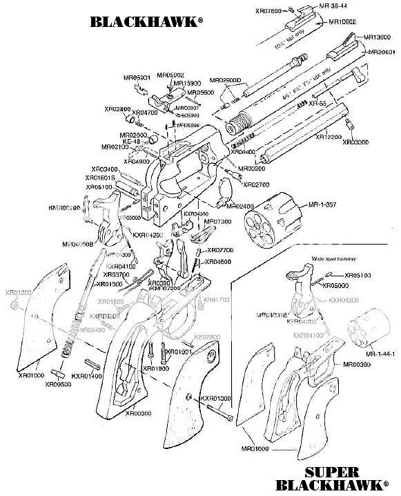

Here ya go. Look closely at the shape of the frames.

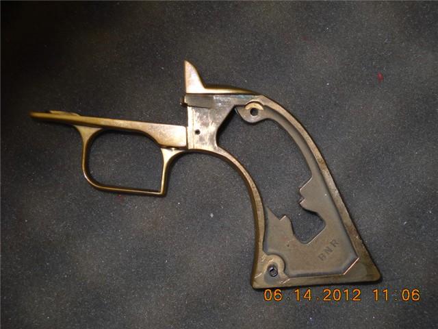

I have a Super Blackhawk grip frame with wood grips that came off a 3 screw gun. This is the square back trigger guard and has the hole behind the trigger for the plunger and spring. Whoever had this before me had it ceracoted with a brass color but that can be buffed off and reblued. I would take $100 shipped if interested

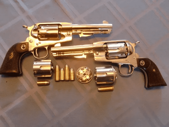

A couple of nickel plated Old Armys
