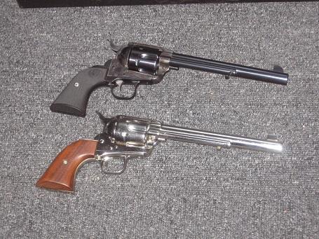

I saw this one Gunbroker , seller says he thinks it's a NM but I'm not so sure about that , i think his price is high but you might think otherwise
Cool! Thanks!
I get home, I'll try to glean the information on which cylinder crosses over between the NM and OM. One fits the other but not the other way?
You won't regret it. The bottom one is a New Model Blackhawk Flattop .45 Convertible
Cool! Thanks!
That looks like an old model cylinder because it has the clearance cut thru the chamber mouths for the firing pin (not needed on new model chambers).
If you find a new model cylinder, you want one from a large frame size, not one for the mid size frame like the New Vaquero or Blackhawk flattop.
