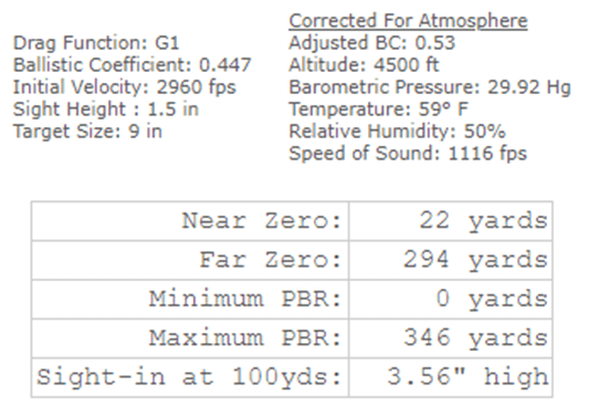

I do not own a single rifle zeroed at 100 yds. Before switching everything to MPBR my 30-06 hunting rifles were all zeroed at 200 yds.
This is where my M1917 is set up now:

https://shooterscalculator.com/
