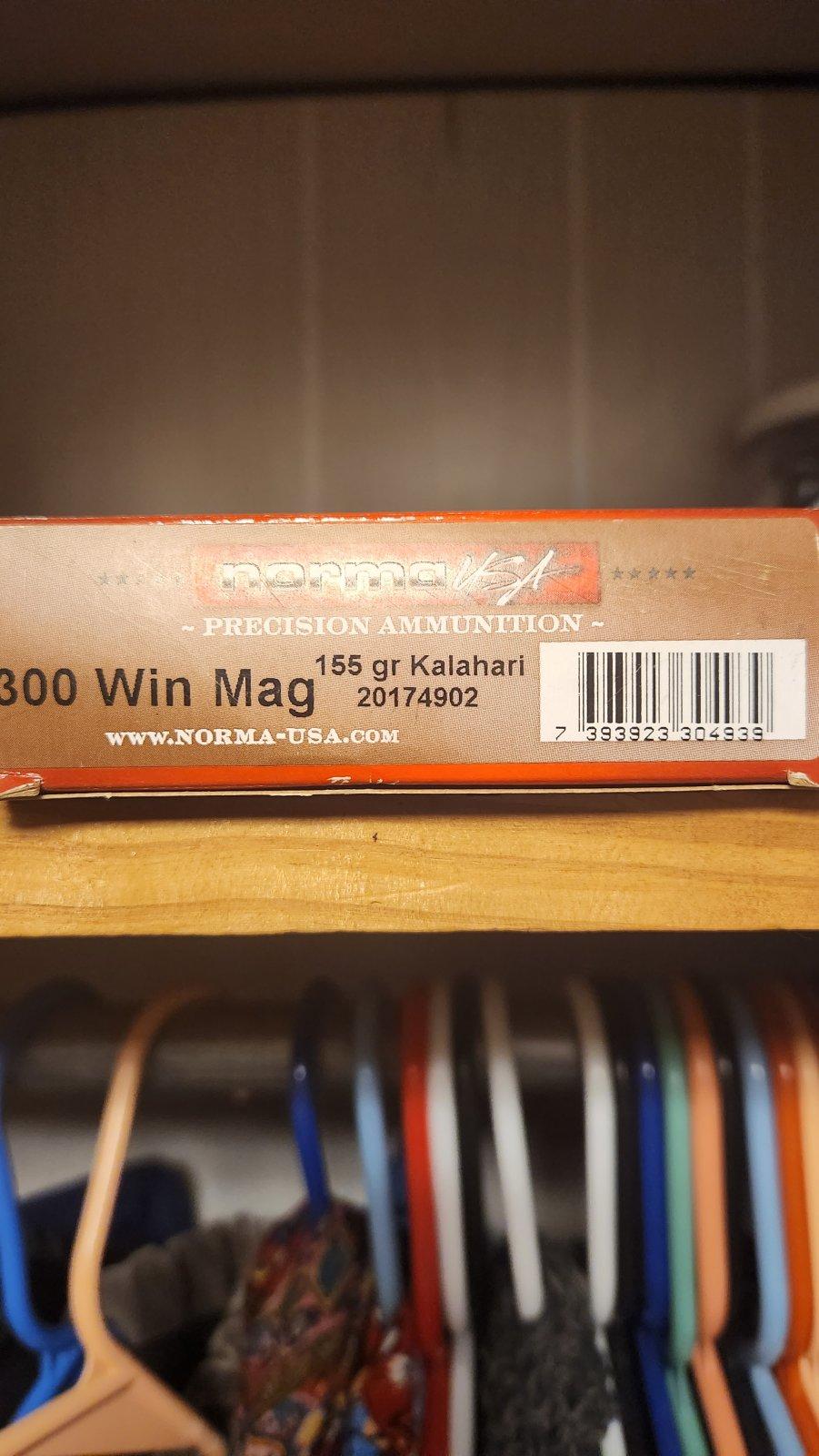

Hello , new to this forum and forums in general.
I recently acquired a Ruger M77 MKII in 300 win mag.
I topped it with a Arken SHII 6-24X50
My local Gunsmith and I went to sight it in tonight using Norma 155gr and couldn't get it under 3MOA .
I've read most folks are running 180-200gr.
Any input would help .
Thanks

I've never used 300 Win mag with lighter than 180 grain bullets. Also, getting small groups from a 300 magnum can be more difficult than with a lighter recoiling cartridge.

From what I'm reading it seems like those heavier bullet weights are the ticket !
Thank you for the information!

i use 190 grain in a high quality ammo such as Nosler or hand load
Thank you ,
In my 308 I've always used 180s.
When I got the rifle in the trade it came with ammo .
Starting to realize why the box of 180s is almost gone but the 150s only have a few missing
