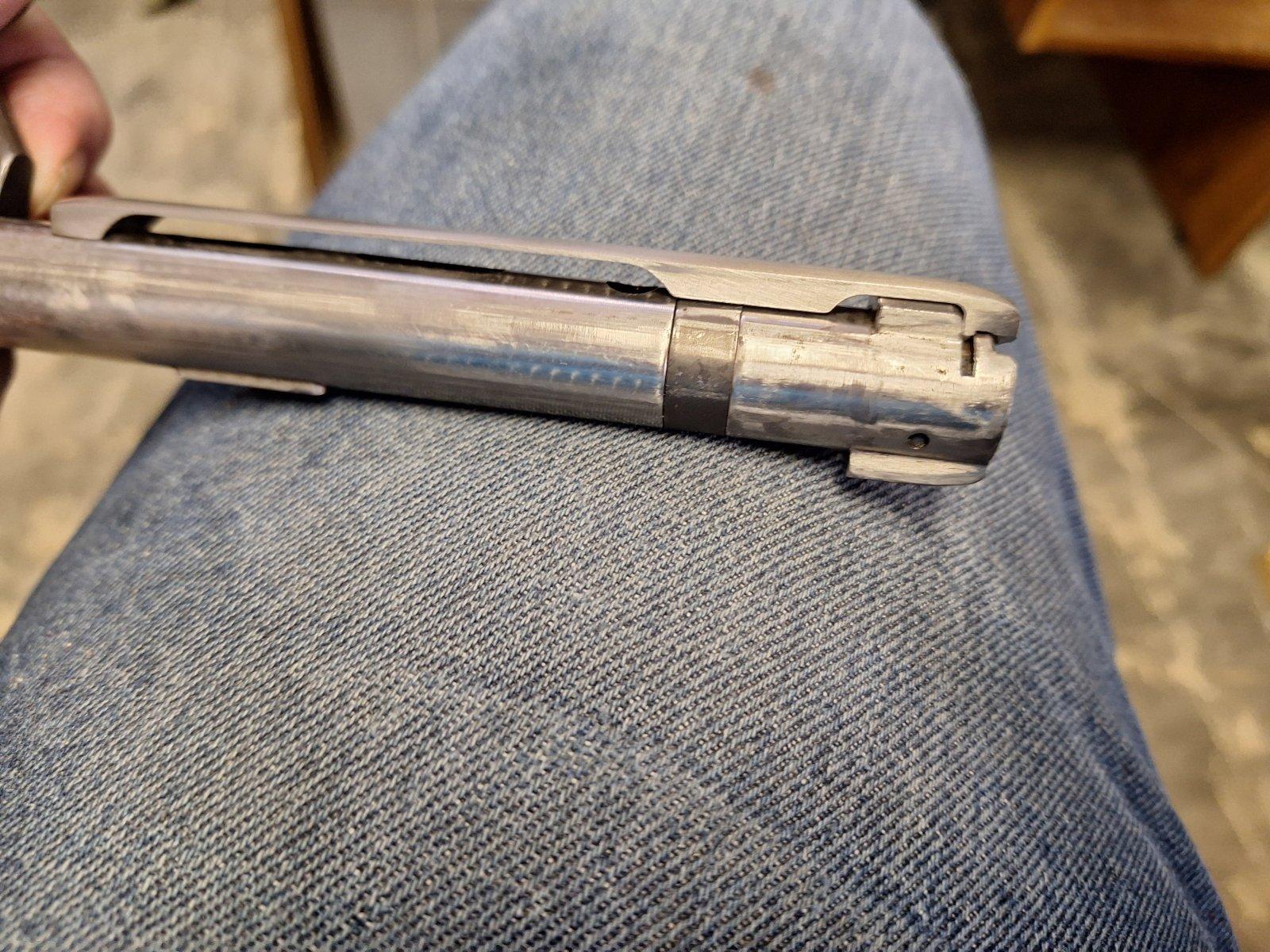

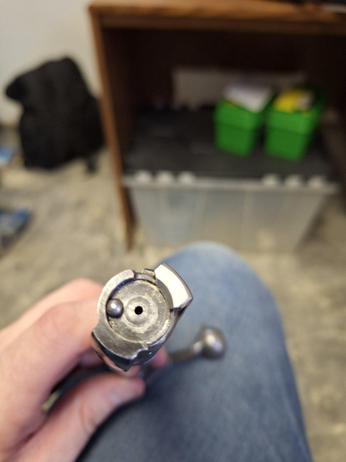

Photos of bolt and extractor

I am not a student of the claw extractor but before seeing a photo it really sounds like the extractor has a tension problem, or the inside of the hook is worn or rounded. But seeing the photo, it's hard to tell if the extractor is sitting into the face of the bolt quite enough. A visual of another 77 might help.
Aging memory tells me claw type extractors are adjustable by actual bending & thinking Brownells might even have a tool for this. If the extractor hook is sharp, not broken or rounded, I'd look for a Mauser mechanic or possibly a replacement extractor. Numrich-Gun Parts Corp. doesn't list one. Also, an afterthought, make sure the ejector plunger is moving freely. If it's stuck or sticky in the extended position it could be knocking the case off the extractor too soon.

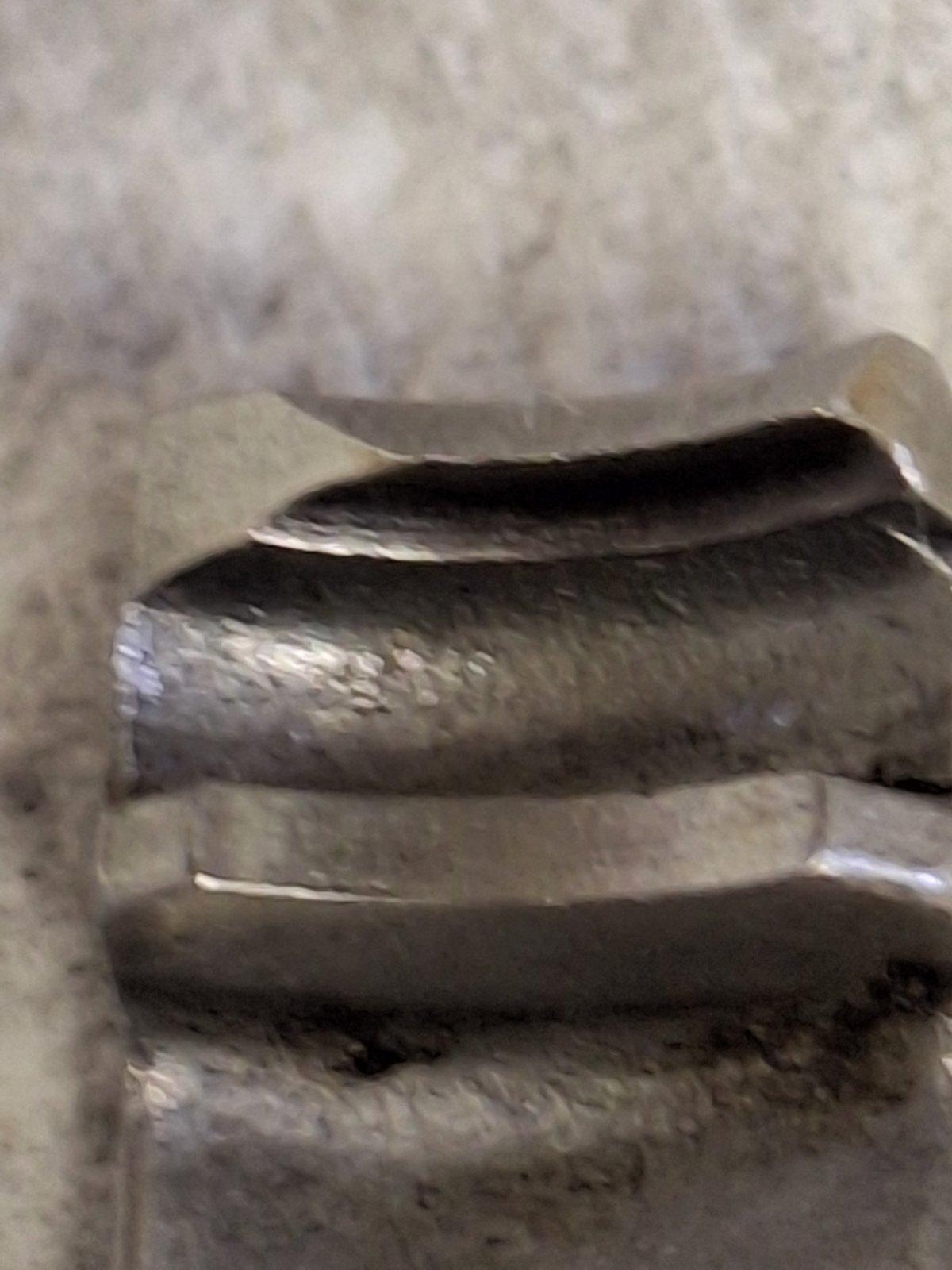

First off, that claw type extractor is a Mauser style extractor adapted to work on a push feed bolt. The tip has been altered just enough to let it slide over the rim of the cartridge case. Sometimes a bit too much has been removed and the claw will not hold the case to the point where the ejector will kick the case free of the rifle. I had a tanger M77 in 7x57 Mauser with that same problem and I had to replace the claw.
You can bend a spring a bit with a screwdriver and that will sometimes fix the problem. If it doesn't, a new claw will fix the problem. I used one from a 98 Mauser on mine bit ti took very care ffitting on the edge of the claw so that it would slip over the case rim. Just a slight polishing with a Dremel and Cratex tip.

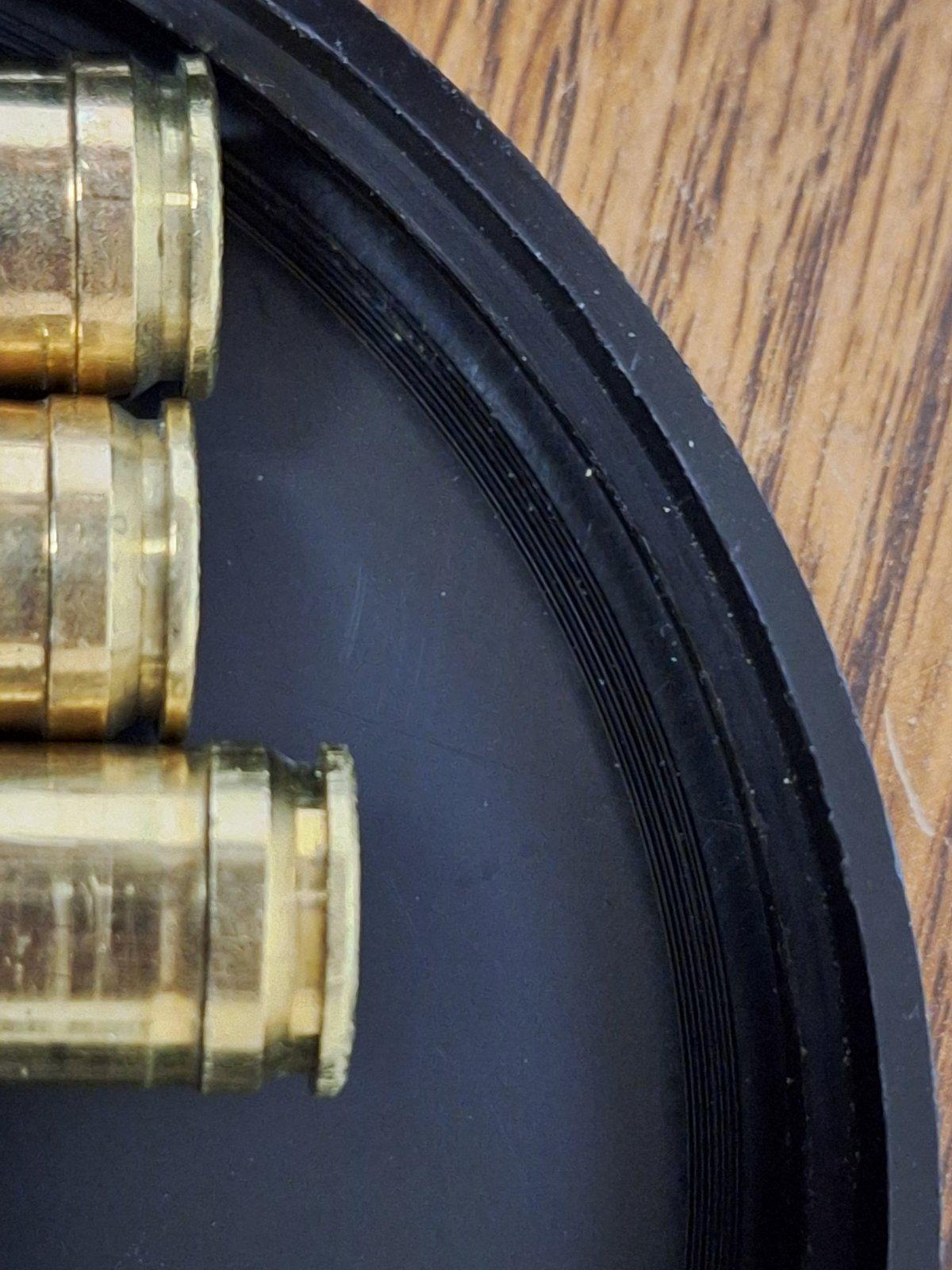

Pics of brass. 2 on left empty RP brass one on right is dummy round Rp brass does same thing to federal empty and loaded.

Extractor. Definitely has uneven line on leading edge.
