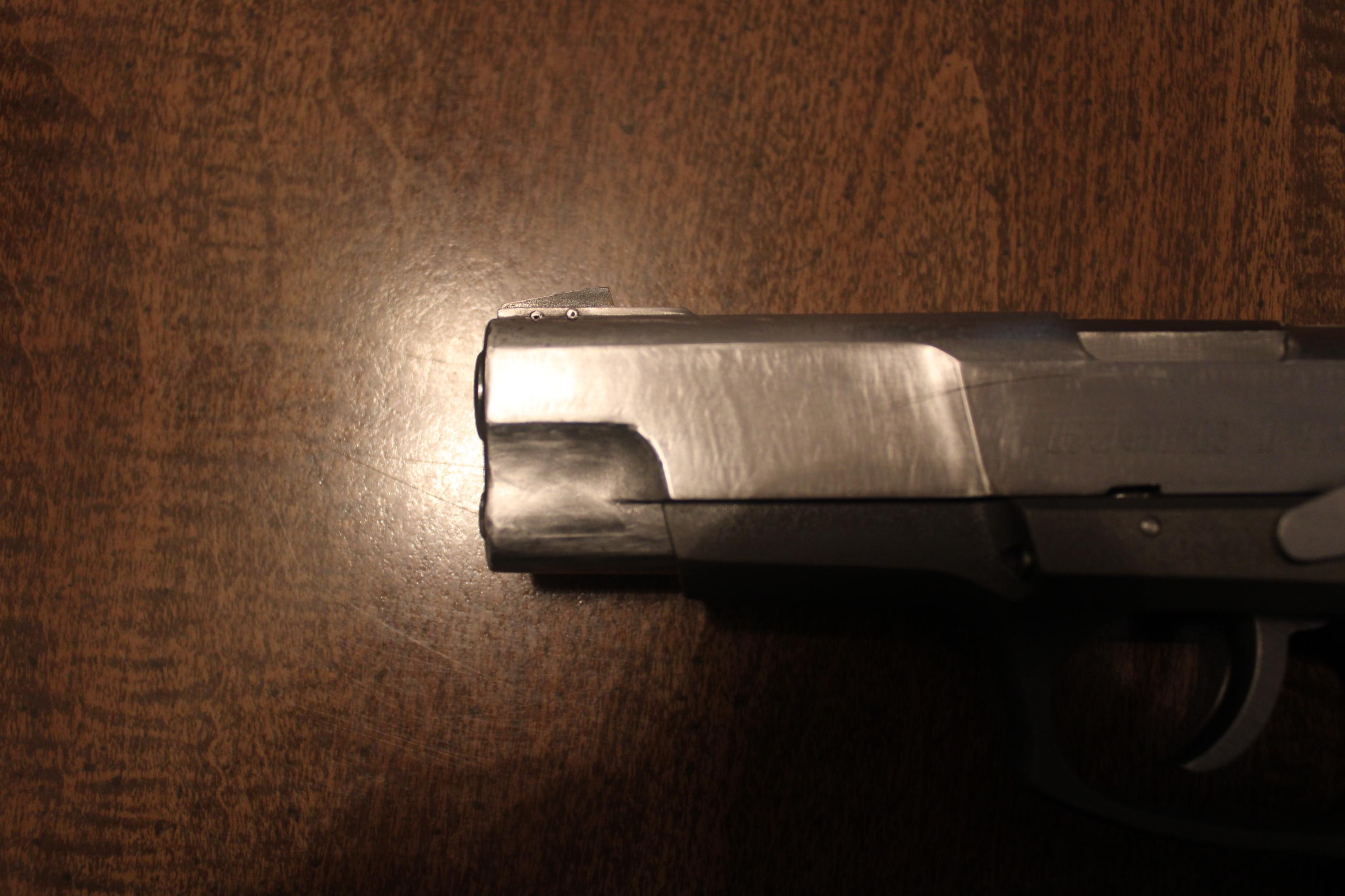

I recently bought a P85 with a stainless finished slide. The previous owner had attempted to polish the slide with a Dremel and botched the job. All sorts of waves in the finish. I would like to get it back to the satin finish that was original. I also was the one who sold him the gun and always regretted selling it. When he offered to sell it back I was very happy until I seen the polish job. TIA

....draw filing is your friend, and WORKS , but takes time and practice,,,wish I had a nickel for every barrel, or slide I have draw filed over the past 50 years and I learned from some of the best....lot easier to do a stainless slide than any ONE of the hundreds of octagon barrel s I've done, and ALL by hand ! finish up with emery paper ( aluminum oxide) and 3 M Scotchbrite pads.....:rolleyes::cool:;)
    400.2 KB
as noted in the picture, the use of a "flat" hard ,large or long surface does NOT work well with any slide that has the "step" from front to back, same with cross hatching for slide "grip", gotta recut the grooves or hatch cuts.....it ain't gonna be simple and easy...........:rolleyes:
from what we can 'see' in the picture, a flat file with various grades ( grits) should suffice, start coarse and work down to finer grits, go with the grain?? ( front to back) seen slides with much worse, deeper rust spotting in them, we've done over the years..........OR if you have a lot of money or have a relative that knows , or owns a machine shop and has a surface grinder,,,,,too costly ,just to even set it up..... :cool:
