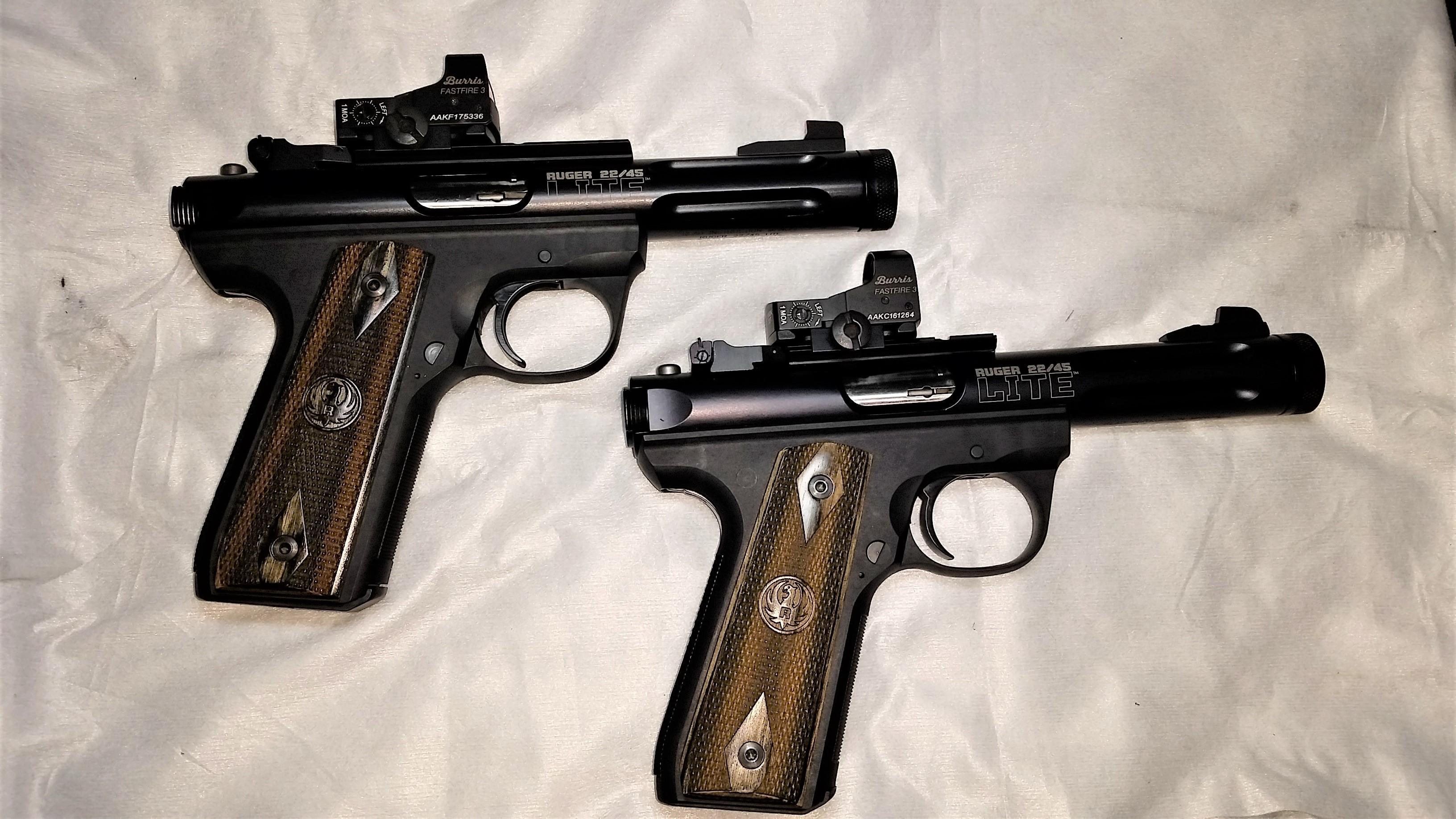

I've found there are numerous dot optics that are good and some that are excellent. The 22/45 beater has a $40 dot on it that hasn't failed me. My 22/45 suppressor host has a Burris FastFire 3 that allows shooting in bright sun or evening shadows out past 100 yards. The 22/45 with attached rail supports a Burris FastFire 2 that has an auto adjusting brightness for the dot-works fine.

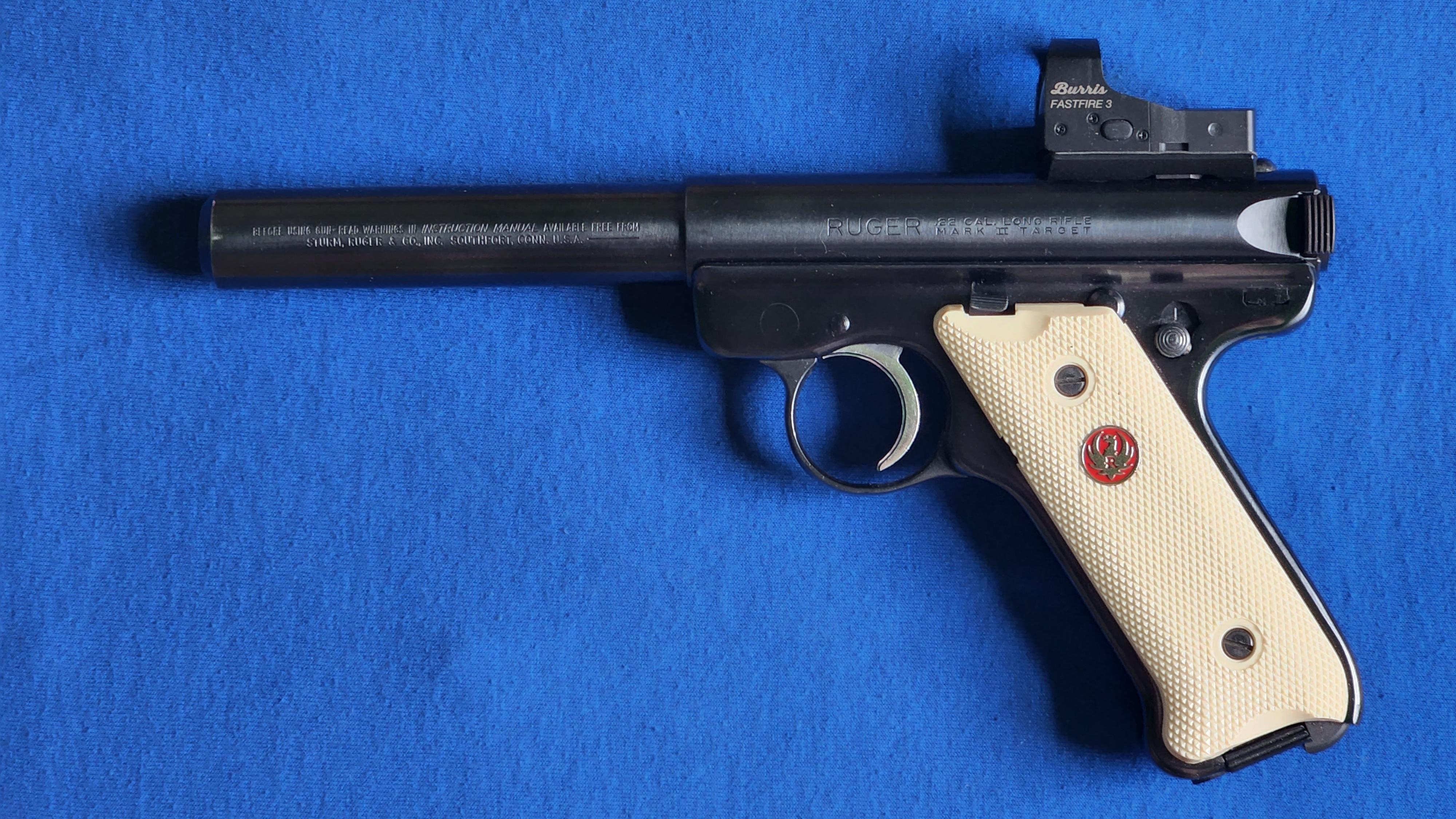

I have several Mark IIs, they are my favorite shooters. With my older eyes, I have fitted most of them with Williams Fire Sights. The one I haven't put the Fire Sights on is my 1985 Target model. That one I put a Burris FastFire III Red Dot on. The FastFire III is available with an 8 MOA dot, but I prefer the 3 MOA. The Burris mount uses the rear sight dovetail slot, making a very nice package.

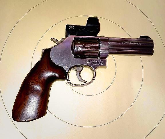

I just picked up a Bushnell First Strike 2.0 for my 617. Same sight would work well on my 22/45s but I have 3 railways for them.
The dot is 3 MOA and is adjustable for brightness that brings it to a very small dot to a larger view.
For Bullseye go with a small dot. For Steel go with the largest you like. My C-Mores all have 12 MOA dots right now but I've played with 6 and 3 MOA modules.
