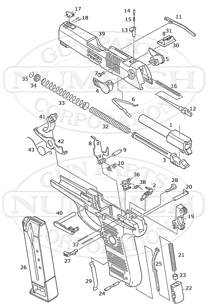

IIRC all of the P95 models had captured recoil springs, so if yours are loose, someone has modified the assembly. As you can see in the parts diagram, there are normally a couple of little widgets (parts 34 & 35) that keep the twin factory springs captured:
Also, I think all of the P-series handguns need to have the ejector (part 8) rotated down into the magwell to remove the slide; if it popped back up while the slide was off, it will prevent reassembly. So, make sure the mag well is empty and the ejector is rotated forward/down/out of the way (and it sounds like you've already taken care of that).
IIRC, the trigger bar (part 42) projects upward under spring pressure, but I think that should just push down/out of the way as the slide is being installed, unless something is jammed or out of position.
