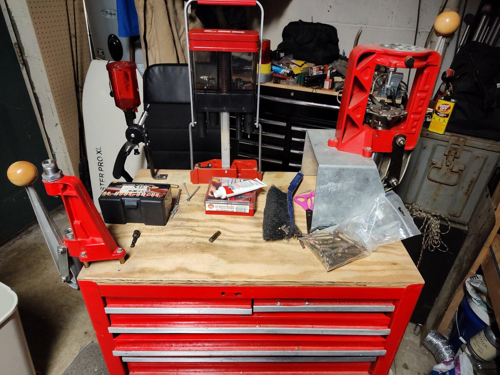

You didn't really mention what you would be using this for. Full length sizing 50bmg or 9mm. The open front design is a big advantage for case, bullet handling etc. It definitely looks solid and isn't horribly expensive. It's way bigger and heavier than most. Which may or may not be a benefit. If I do manage to bust my little Lee I would probably have a new one within a week.
