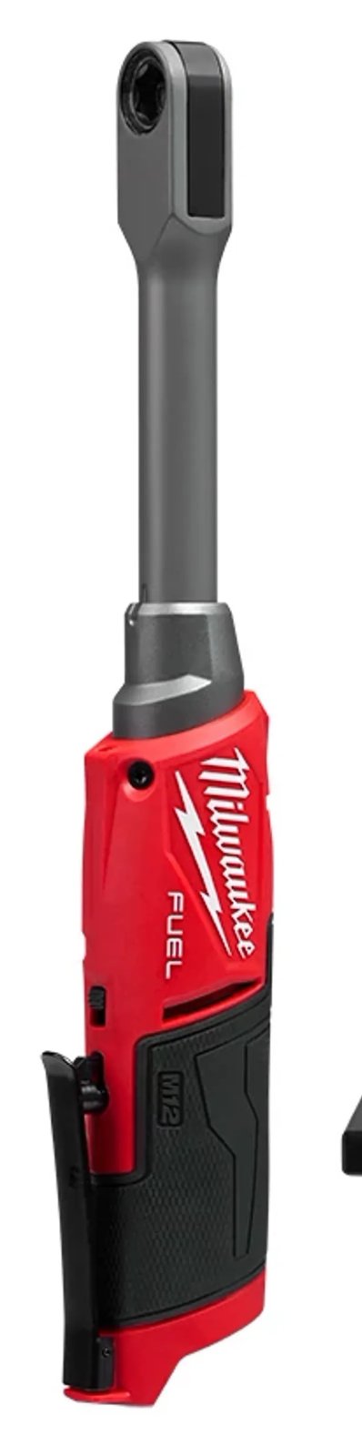

I haven't used one of the little battery wrenches Jeepnik posted but my experience with Milwaukee battery tools makes me like them. That is what a contractor I worked for a lot provided us with.

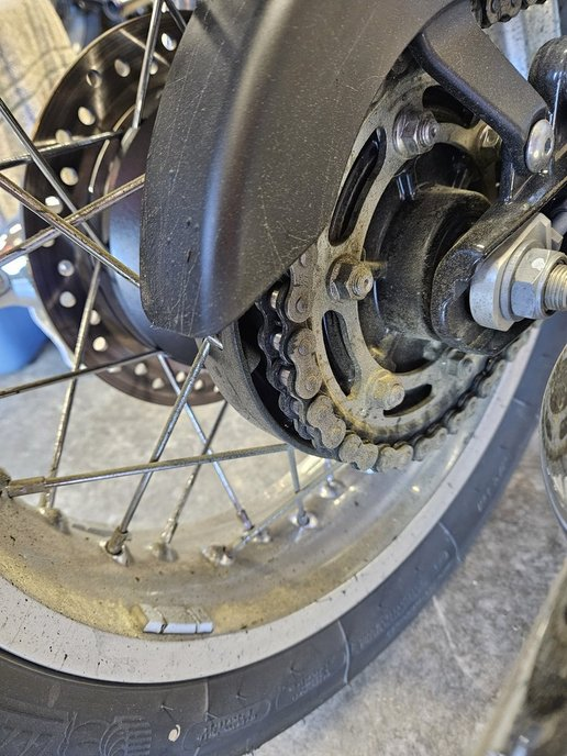

This all came about when I bought a new Triumph Bonneville T120. It's old school, and I'm okay with that. I could buy special Snap-On open ended wrenches to adjust the chain, but you can't realistically do it with a chain cleaning and lubing. To do it right you have to remove the mufflers and passenger pegs. That's where it gets tight, very tight.
I did get by with a regular 12mm box wrench, but how much time could I save with a ratchet box wrench? Anything that makes this chore easier I'm all for.
Chain and wheel after the dealer serviced my chain at the 900 mile service. This was in GA's high pollen season. The lube spray is purely what the Triumph dealer used. You'll see a before I serviced the chain and after I serviced the chain. It looks the same 800 miles later. Day and night. I need the tools to make this unpleasant task easier. I do admit I felt pretty good with the results :)
