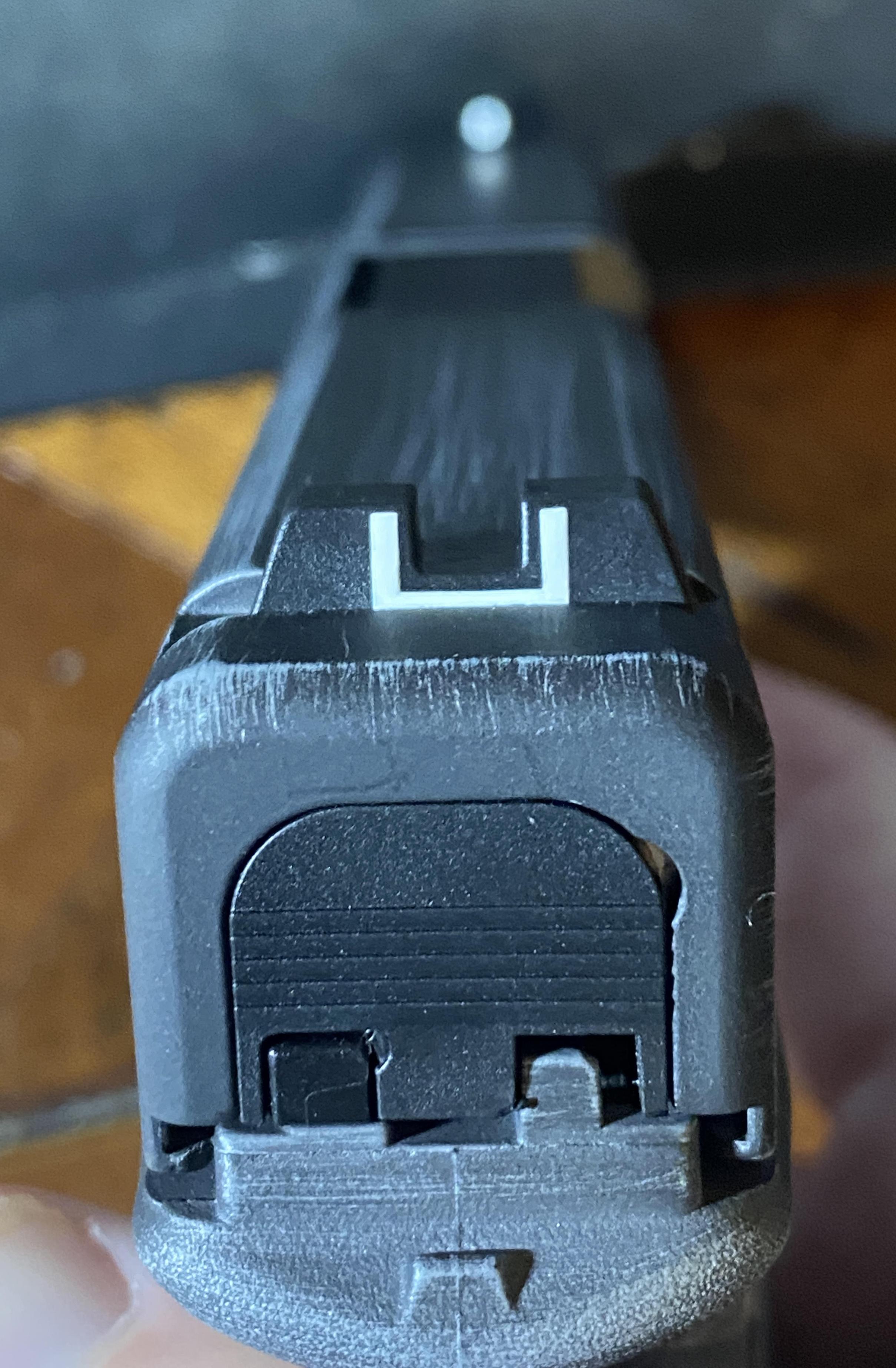

Well, a few months ago, I finally bought a Glock 19. It was one gun I had wanted for a year or so. I finally got a Gen 5. Some distributor exclusive in this distressed finish. It's nice. I bought it, took it home, handled it. Got a holster for it and practiced some.
Finally took it to the range. It was shooting low and to the right. But I figured it's my first time with the gun, and I haven't been to the range in a while. So I figured I'd just go back and try again. It's a nice gun. Nice grip angle, nice trigger etc.
Then I saw the rear sight once I got home and was putting it away. Not sure how I missed this before!
No wonder it was shooting to the right so much. This sight is not centered. Yep, came from the factory like that.
Plus I see why the Glock factory sights have such poor respect online. They are just too chunky and blocky. I don't have a sight tool, so instead of taking it to a gunsmith and having them fix this, I just ordered a new set of fiber optic sights, and I'll have them installed.
It's pretty disappointing really. Brand new gun, and the replacement sights were $100. Then it will probably be at least $50 to have a gunsmith install them.

Kevin, Those sights are easy to "drift" wherever you want them. Lay it on something with a towel under it and
just use a small punch and hammer to tap it over to the left.
As for shooting low Glock basically regulates their sights so the front sight's circle covers the bull. I heard it called
a combat sight picture. I know many try to align them with the 6 o'clock of the bull sitting lollipop style and end
up hitting low.
That's a rap or 2 on a wood bench at the range.
Remove slide, hold muzzle end in had, whack rear site on bench. Assemble, shoot, repeat procedure if necessary.
