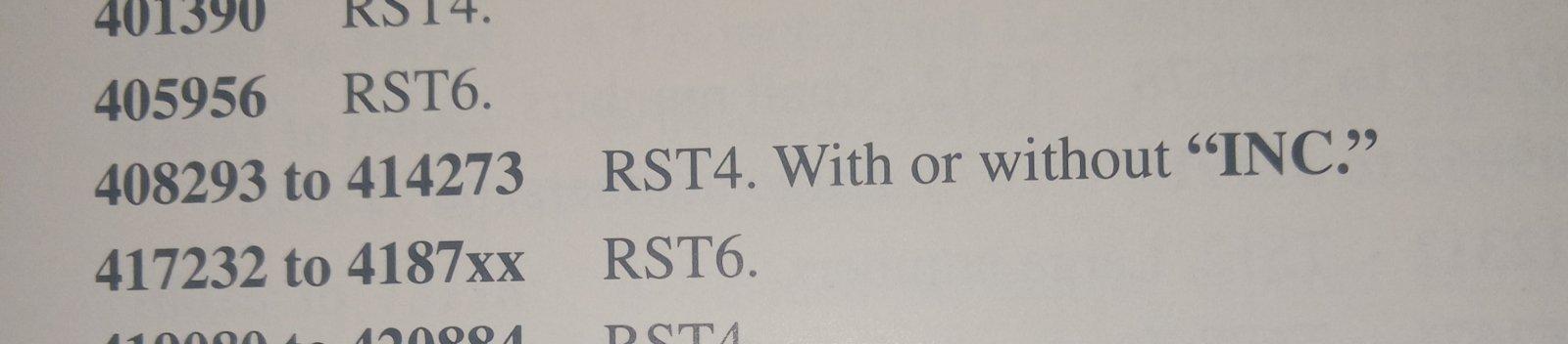

It is not marked "Mark" anything. The frame is marked "RUGER in large text followed by 22 CAL LONG RIFLE over AUTOMATIC PISTOL in smaller text. No markings on the barrel. SN is a clean 415xxx. For some reason my photos of the crown are not coming out well. The barrel OD is .873" and the end of the barrel is flat then at a bit over 1.178" OD it is recessed .040" then crowned at the bore.
The serial number is a 1966 vintage and it falls in either a RST4 or RST6 block. I measured a Mark 1 bull barrel and I got 0.875" so it looks like a bull barrel was used on it. In any case you have a good shooter for the money.

Yeah, not a pre "MARK" since Standards and Mark I's were made at the same time beginning in 1951. If it doesn't say Mark I on the receiver, it was a standard model.
