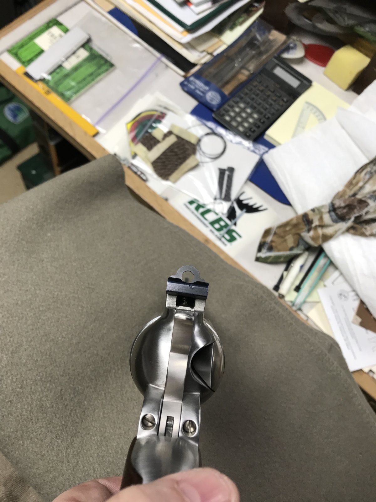

It's more of a ghost ring than a peep. I have used it successfully on hogs. Nice quick sight acquisition. Your eye naturally wants to center the post. Here is a mocked up picture (I just quickly swapped rear assemblies for the pic) and a view of the sight picture.
I haven't really played with it much. I used a friend's gun on the hog hunt and bought the pieces to make my own, but have not played with it. From what I did use of it I see no reason why it wouldn't be a great gun for playing around too. That is one of this summers things to do.
