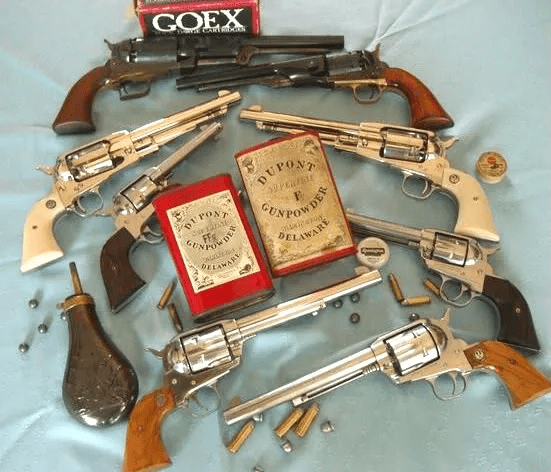

Here are two that I wish I would have kept. They just look COOL MHO I woke up STOOOOOOOPID one day and sold them.
High polish, cylinder throats reamed to correct dia., spring kit, action job, custom grips and Super hammers added later.
Very Nice My kind of shooting irons right there! awesome collection!

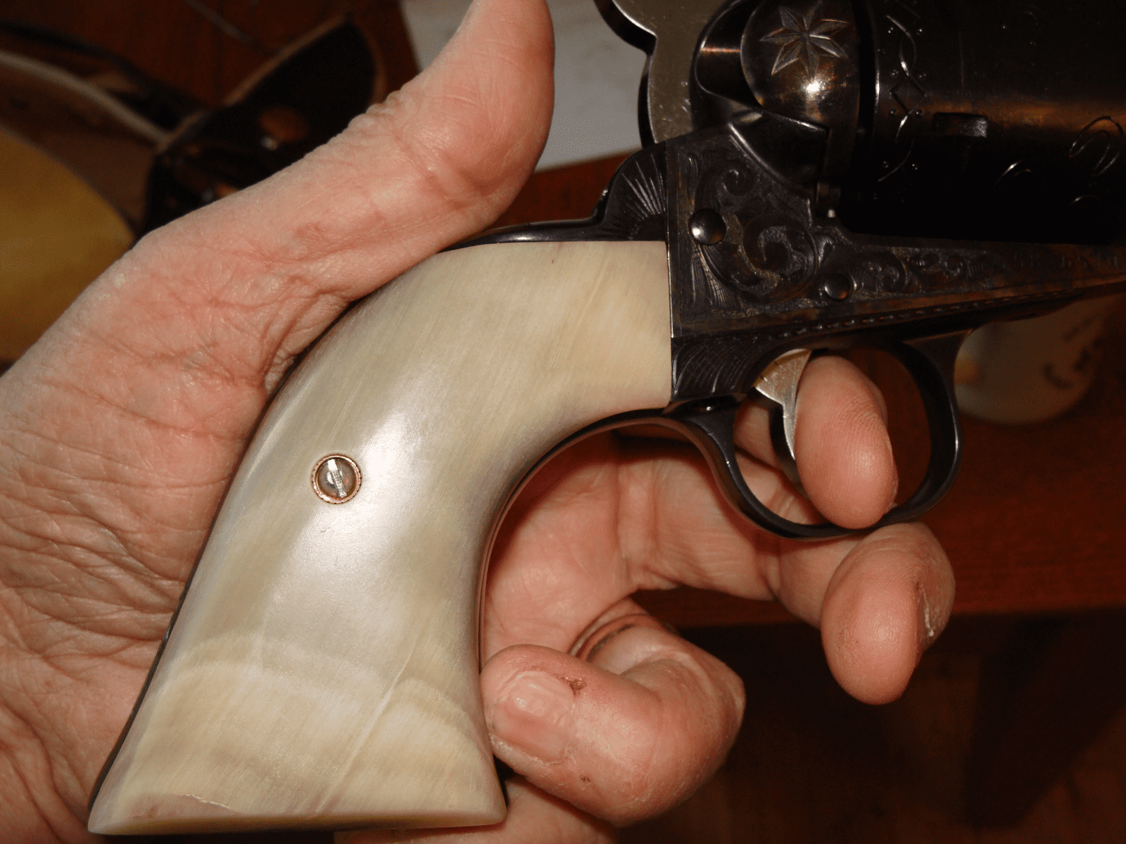

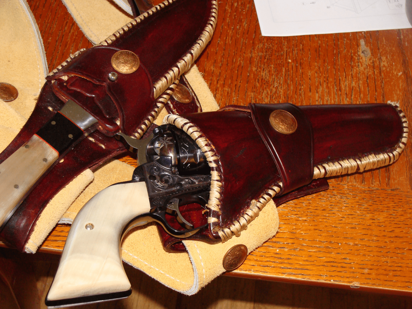

Original Vaqueros are threaded the same as Colt 2nd Gen SAAs. I had Bobby Tyler convert one for me.
Patrick Grashorn made the ramshorn grips. I deconstructed and reconstructed the EPS holster. Added Indian Pennies as conchos. Homage to my Cherokee/Irish/Chickasaw grandmother.
