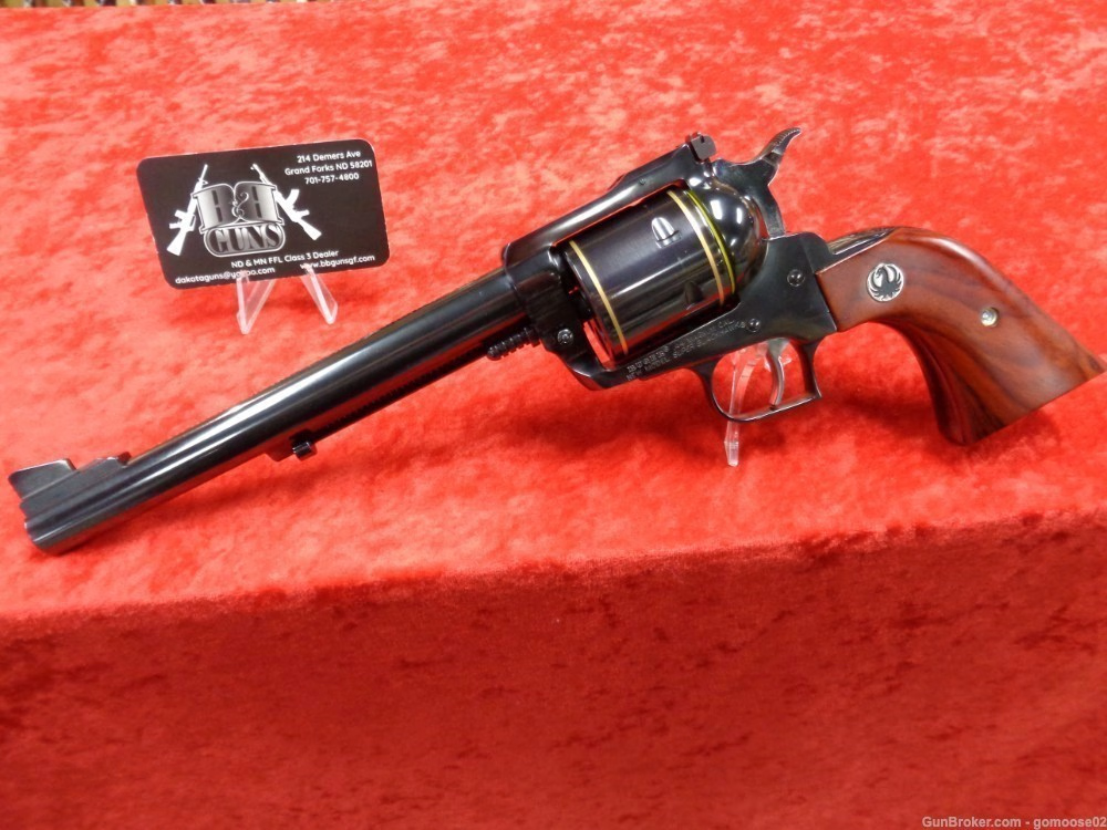

If you want something special to honor your dad: A special New Model was made Roll marked in gold "50th ANNIVERSARY SUPER BLACKHAWK 2009" with a premium super high polish blue finish, cocobolo wood grips, some gold accents and a special soft case, but only in 7 1/2".
See a few for sale here: https://www.gunbroker.com/all/search/completed?keywords=ruger 50th anniversary super blackhawk&timeframe=1&sort=1&pagesize=48
