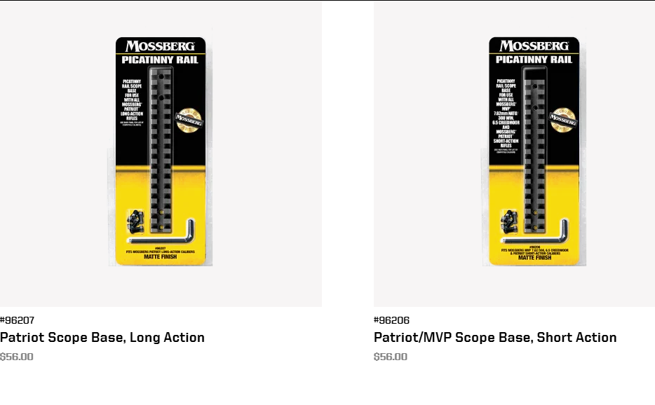

Blind Son handed me his 'new to him' Iowa legal deer rifle so I can make the modifications to allow a friend/co-worker of his to be his aiming assistant. Mossberg bolt action in 350 Legend with which I'm totally unfamiliar so I'll have to do a bit of searching to find compatible mounting bases and such.
One part that would make things go much easier would be a continuous one piece picatinny mount base. Any suggestions?

Mossberg website has some. I put one of these on my Son's Patriot.

Thanks, I found a base that fits and possibly have the rest of parts on hand. Really too busy with planting to do mush with this project at the moment.
FWIW, there are both picatinny and Weaver bases available and this model seems to be a short action. I've had zero experience with either this model rifle or the 350 Legend cartridge so starting from scratch. The deal came with 3 brands of ammo and possibly the first owner didn't have much experience with either centerfire rifle or scope use. :unsure:
Mossberg factory Patriot Long Action Pic base 96207 Simple OEM option if you want plug and play

EGW one piece Picatinny rail for Mossberg Patriot Long Action or Short Action if it’s a compact model is your best bet.
It’s affordable $40-60, solid aluminum, and gives you a continuous rail for easy scope offset red dot positioning perfect for an aiming assistant setup.
I ended up with both Weaver and EGW bases. Looks like the EGW is going to work better with the offset adaptors I have.
