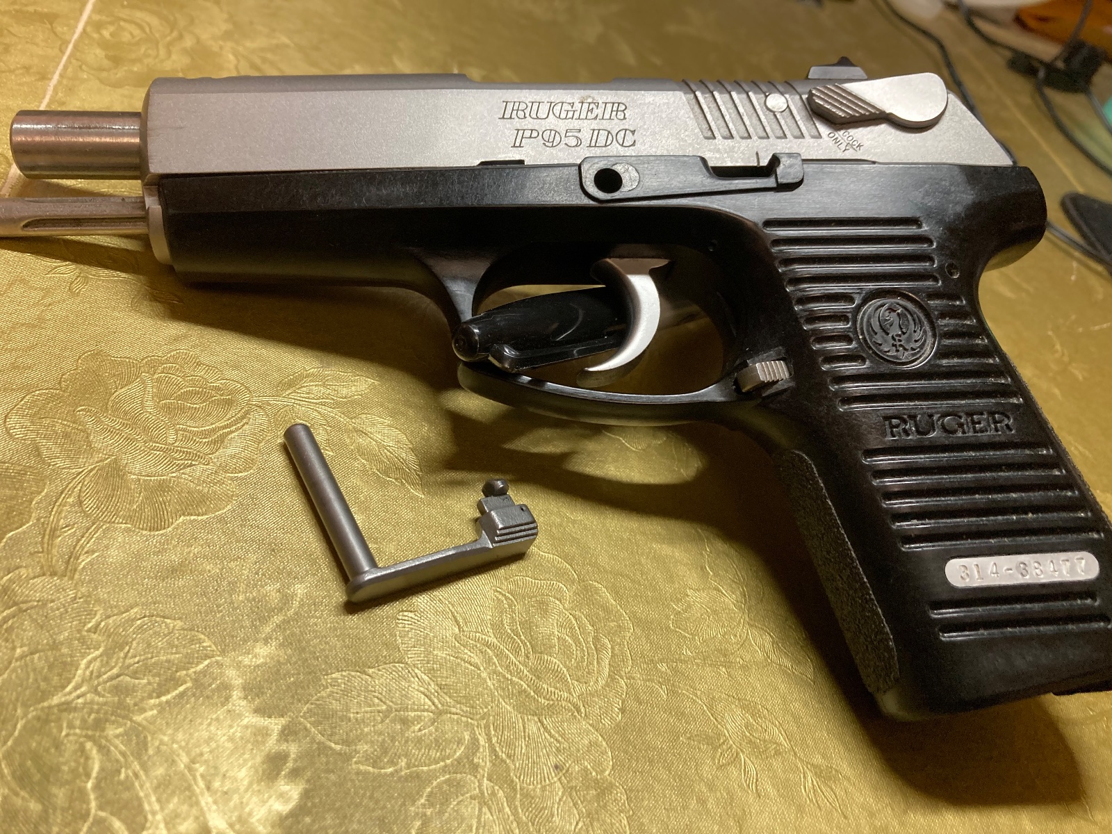

It's been years since I disassembled my P95. While putting it back together again I messed up the process. I have the slide on but not the slide stop and I can't get the slide on or off. Hopefully if the pictures post someone can offer some suggestions.

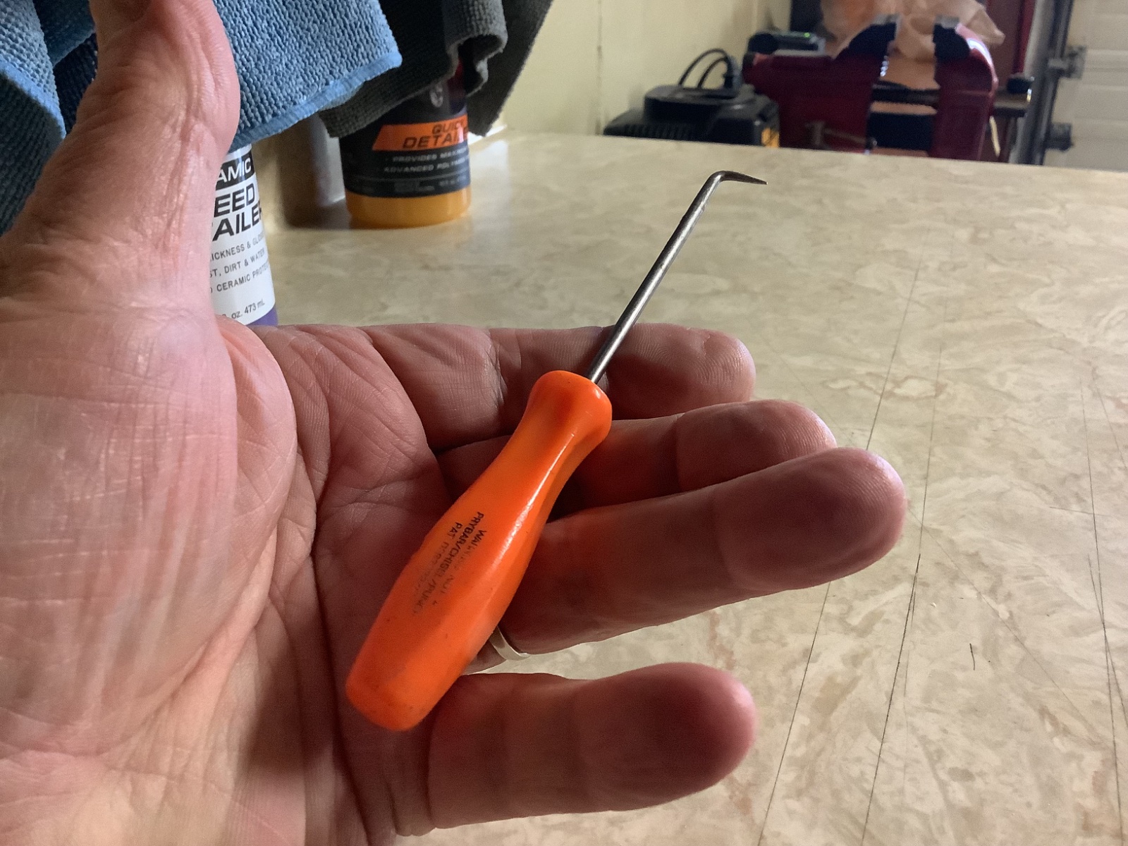

Last night I was laying in bed thinking about this and came to the same conclusion. This morning I looked at it and the thing is definitely flipped up. So far I have not been able to flip it down using the wire from a hanger with a little bend on the end. There must be some trick to doing this. Thanks for the reply. Bill
Wrote the below before reading the OP's latest post.... you may have tot seriously tap on the slid some first:
You can make a metal hook with a coat hanger or such and also pull it down by reaching up through the mag well... but sometimes you still have to knock the hell out of the slide to get it to go forward after this... then make sure the guide rod is centered, ejector is still down and put it back together.....
I'll offer to do this but it will have to be later in the week: I'll lock one of mine up like that and figure out the exact problem and how to fix it if you need me to. I've have a P95 do this about 3 times but it's probably been 10 years since the last time.

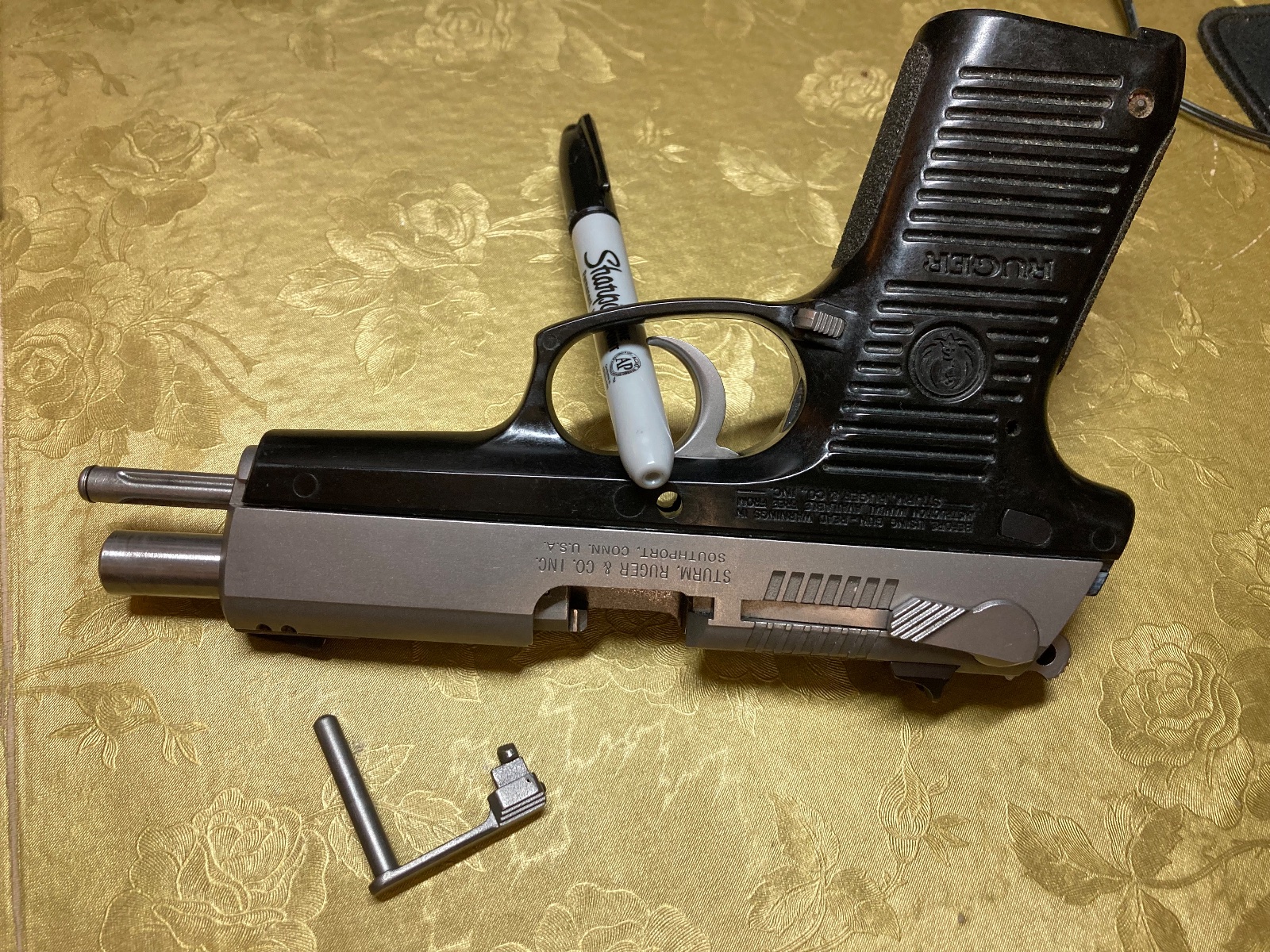

This is where I am right now. Please see picture attached. Bill

Stupid question but ….. have you pushed the ejector back up again, then moving it back down? And ensuring it’s ALL the way down?
Think sometimes I wiggled or applied pressure back and forth on the slide while I did that too.
You’ll win it and will remember next time it happens.
In order to get the ejector to move down I have held the slide forward against the spring pressure. The ejector snaps down to approximately a 45 degree angle. I believe it is all the way down. I am guessing that the guide rod with the hole for the slide stop is too far forward so I don't see it in the hole when I move the slide back. I think this whole mess started because when I put the slide back on I didn't have the slide all the way back to the "witness" mark on the frame. But I am not positive. I'd like to know what I did so I don't do it again. If I ever get this to function again.:)

Thank you blume357. I really appreciate your efforts and all those who have contributed. I can get the slide back far enough to match up the two lines. But I think the guide rod is not moving back with the slide, if that is possible. So I can put the slide stop back in but I am pretty sure it is not going through the metal ring to make the whole mechanism lock into place. I remember many years ago putting a gun in a vice and using a piece of wood and a hammer and hitting it. I guess it was this gun. I'll wait for your video. Many thanks. Bill
My $.02 for what it's worth, that slide stop needs to come out. This picture tells me It looks to be behind guide rod hole. Take the stop out, pull the ejector down till it stops, & start again. As roylt mentioned the slide, guide rod & barrel should stay together as the holes line up. You should be able to insert the stop, then move the slide back enough to finish seating the stop.
PythOn, your analysis is correct. Except that the slide stop is only in there so I don't lose it. The hole in the guide rod does not come back far enough for me to see it through the hole in the frame. The problem is that I can't get the guide rod to move back so I can insert the slide stop pin. Bill
I've had this happen a couple of times & never could see the problem.. After a couple of tries it would go on no problem. My guess is the cam block moves to one side a bit & hits the narrow slot area before the trigger. That seems to be where it gets hung up. The cambloc is the only thing that has to pass through that slot & it has a bit of side movement when installed. Definite maybe.
