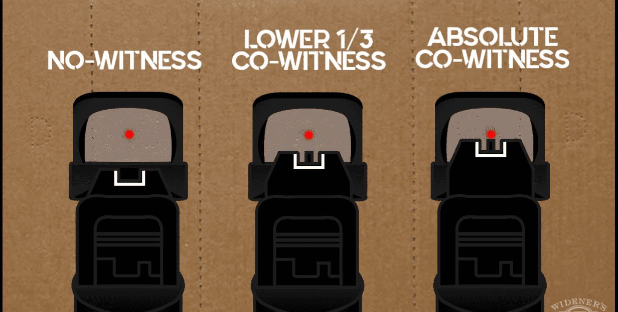

OK, we need to define 'co-witness'.
As I understand this term, it means both iron sights AND optic dot are within view. Not necessarily seen at the same point through the optic(ie: lower third vs center) but both ARE visible.
I'm not in that crowd. My thoughts are: you either use the dot or you use the sights. If you don't trust the dot 100%, get a better one. :unsure:

There are several views of Co-Witness depending on what your purpose or preference is. I know a SRT DM from MCPD and they use G17Ls with Co-Witness. This is very common for LE and MIL. If I were active I'd prefer this over the side mounted optic, less steps to execute in drills and better reaction/recovery time (in my opinion). However this didn't exist too much 30 plus years ago.
It isn't a question of using a better optic. LE/MIL use some pretty good stuff.....but stuff happens.

Whilst I understand the rationale of using the red dot or the iron sights, I only wanted the iron sights as a backup - because, as mentioned above, sometimes batteries fail. In response to the various types of co-witness, I'd select "lower 1/3". So long as both pointed tho the target is all I would want. I have no desire to have a dot and iron sights used together otherwise. This is why it was optional.
