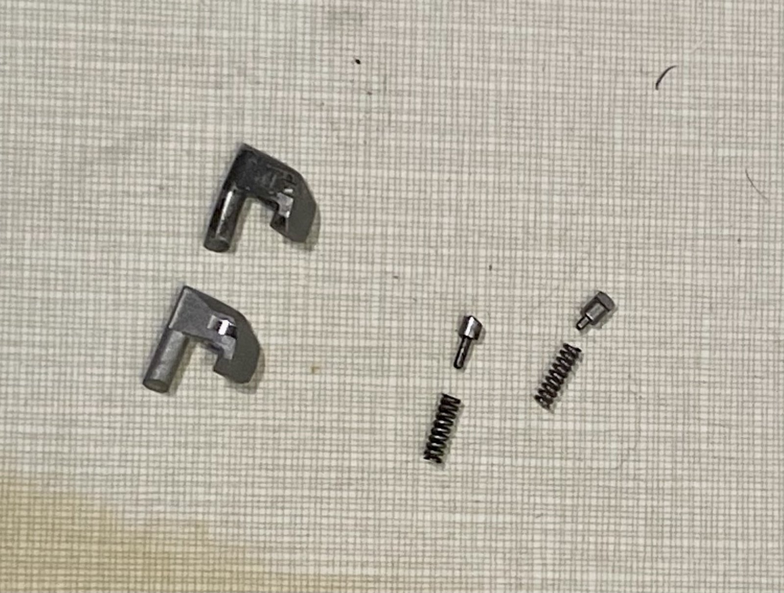

As I was trying to figure out what the problem was I ended up with a spent round stuck in the chamber. I dropped the mag and as I was trying to get it out I realized the extractor had extracted itself. Along with the plunger and the spring.
The most amazing thing is that I found all three on the ground of the range!
I also found the firing pin which somehow also exited the bolt.
I have never seen such a failure on anything. The extractor plunger appears to be broken at the tip.
I called Ruger and I was able to order replacement parts for a few bucks. But has anyone ever seen anything like that on a Mini?

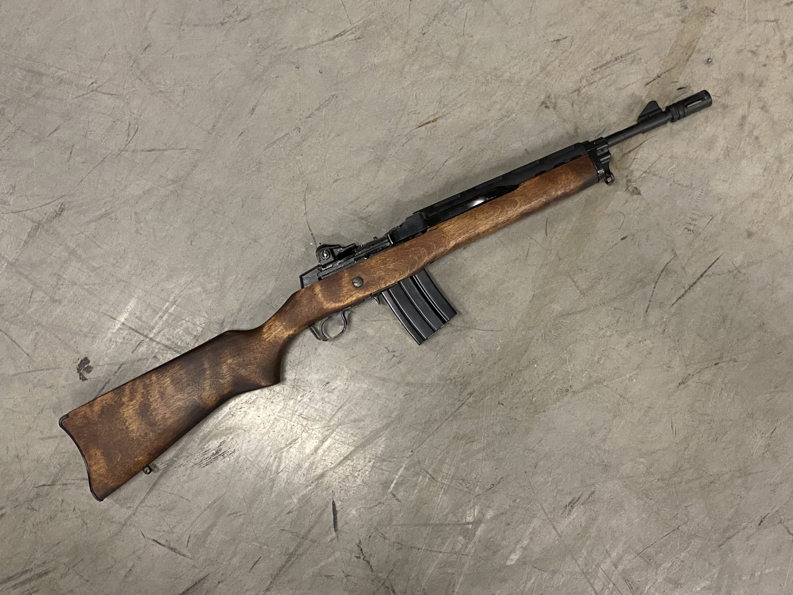

You have no idea. It was a dumpster fire. Now it's… Better. Kinda. Definitely not one for the purists. Filing the front sight was necessary because of the now 14.5" barrel (pinned and welded to make it legal).
Before:
After:
There's a full rebuild thread here:

I received the new parts yesterday and installed them today. They are stainless as they were immediately available and I really don't care if it doesn't match the blued bolt.
The extractor was bent and the plunger's tip broken off…

Update: the new parts seem to have fixed it (extractor, plunger, and spring). I ran about 100 rounds without issues. It even ran a Thermold magazine without malfunctions!!!
