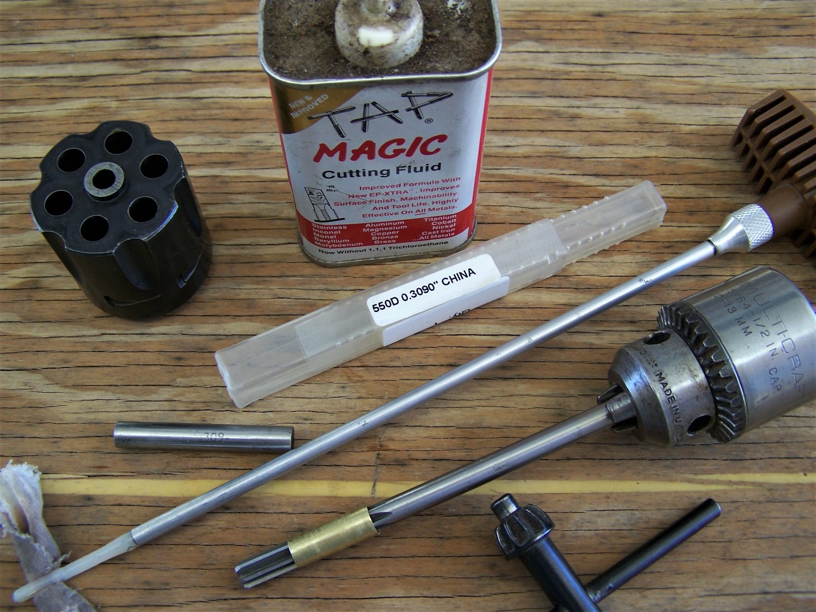

Seriously, pin gauge measure those throats.
Mine were seriously undersized and uneven.
Very bad combo for lead.
But very easy to fix yourself. Takes a $20 chucking reamer and about 20 minutes.
I opened mine to .309 to get them even and they fit this bullet snuggly on the push thru test.
