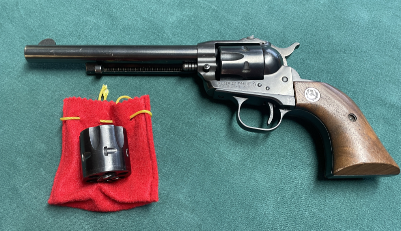

New member here with the result of my latest trade… a 3 screw Single Six. After taking it to the range this past Sunday and putting some Remington Golden Bullet .22LR rounds through it, I joined this forum and, from information learned here and from Ruger, that it was made in 1966, and the cylinder is actually a .22 Magnum The LGS I purchased it from had it listed as a .22 LR.
I experienced no issue shooting .22 LR through it, but that was a close one, if I understand what I’ve read here and other places about shooting .22LR in a .22 WMR cylinder.

If I read the frame markings correctly,, it says; "Single-Six" & not marked as; Ruger Single-Six Win. .22 RF Mag Cal.
As such,, it was likely shipped as an Single-Six Convertible. So,, it's missing the .22 LR cylinder.
You can check the face of the cylinder for the electric pencil etching showing the last 3 digits of the serial number. That will make sure it has it's original .22 Mag cylinder.
Many times folks have shot .22 LR ammo through the magnum cylinder & all that happens is sometimes the brass will split & get stuck a little bit.
As for getting a ,22 LR cylinder,, Ruger did match them to the guns when they were built. HOWEVER,, most of the time,,, if you find a cylinder that will fit, you can easily use it w/o any problems. All you need to look for is the OAL. Measure your current cylinder with a set of calipers,, and measure from the rear of the ratchet, to the front of the boss on the cylinder.
Then find a .22 LR cylinder the same OAL,, or even a few thousands longer. If a little longer,, you can easily hone off the facing of the boss to have it fit.

Lastly,, you have a set of the rarer "neck feather" grip medallions. They were used primarily during late 1966 through 1967.

Thanks very much for the welcome, and for all the information. I encountered no issues whatsoever shooting .22LR last Sunday, before learning the cylinder is for .22 WMR. Also, the markings on the cylinder actually do not match the last 3 digits of the SN. I will measure the cylinder tomorrow and see if I can find a .22 LR cylinder for it, though, just to be safe. Thanks again for all your info.

The missing finish is only on the left side of the gun...the right side is in much better condition.

And yes, the left side of the frame just says "Ruger .22 Cal Single Six".

This is a popular story as others have posted. Same happened to me. Believe it or not mine was a ‘66 single six as well. I caught it 10 mins after purchase. I took it apart and noticed the recess at the end of each cylinder where the top of a magnum cartridge would rest against. Went back asked the vender if he had the .22 LR cylinder that went with it, but no joy. It took about a month or so to find the correct one, I fitted it and was good to go.

The left side of yours looks much better than on mine...lol.
