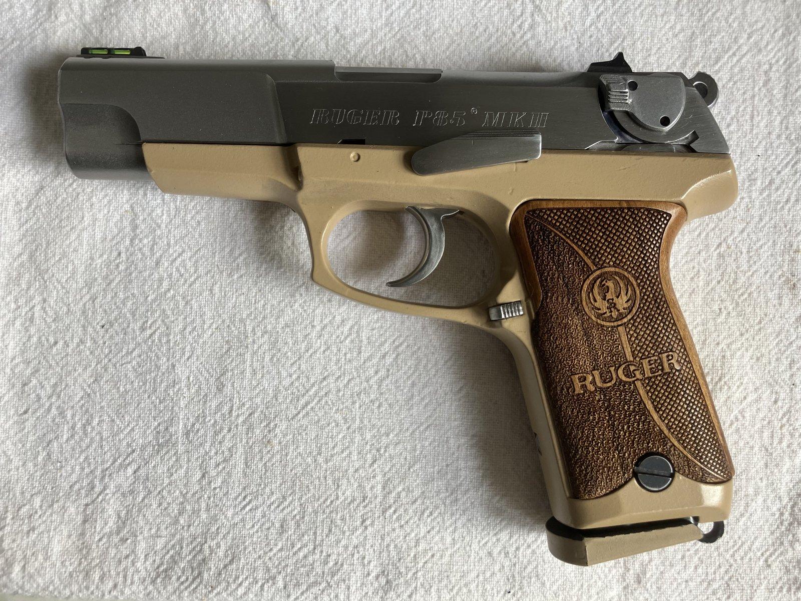

Seems there has been lots of P-series talk of late so I was in my shop today tinkering on something for my girlfriend and thought I would share one of my last projects.
First one to post what tinkering I may have done wins a virtual trip to wherever their dreams take them. (I pretty much gave it away though)
Keep the P-guns alive!!!!!

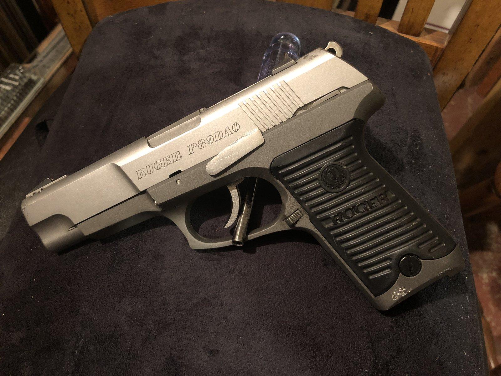

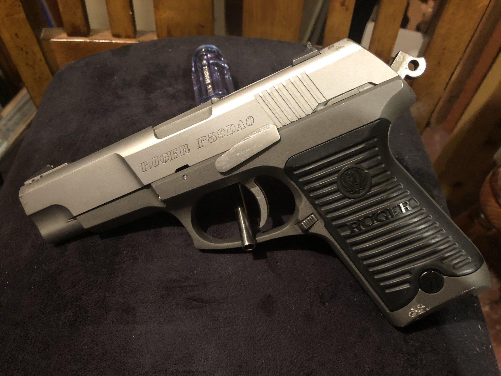

My best guess is that it's not DAO. Hammer can't be cocked on DAO. I suspect the slide might be from a DAO. As this gun has the hammer cocked, there should be a de-cock or de-cock safety lever on the slide.
Oh and there shouldn't be a hammer spur as a DAO.
I was hoping for more conversation I guess. I'm a P-nut for sure but thought other might comment.
Oh well.
Yep, not that hard to figure out.... but I'm not so sure I like the modification.... I really like the de-cock lever on the DA/SA pistols. I suppose it's 'okay' if you know what you got and know how to de-cock it, but for a girl friend? This might just start a conversation......
I ran that together a bit. I was working on something for my girlfriend (no gun related) and this was the last P-gun tinkering I had done a couple years ago.
IIRC, the P93 & P94 slides won't fit on the earlier frames. That's a P95 slide, with the lower front of the slide recontoured to fit the frame (which in this case is a P91DC frame, but it also worked fine on a P85 frame). ONLY a P95 slide with the standard safety will work, because the relief cut for the trigger bar is in the right location (the P95DAO & DC use a different trigger bar design, and their slides have the relief cut in the wrong location for the P85/P89/P91 trigger bars). AND I had to use a shortened P85 barrel & recoil spring guide rod - don't recall exactly why, but a P93 barrel & recoil assembly wouldn't work. BUT if you want a P93 with a safety (something Ruger never made), this modified P95 slide works fine on a P93DC frame, with the standard 93 barrel/recoil assembly.
I'm not sure why, but I really like the compact slide on the earlier style frame! The first P95 slide I modified was blued, but I prefer stainless, so I did this one also (each one was a few hours work, because I did most of the work slowly & carefully, by hand)!

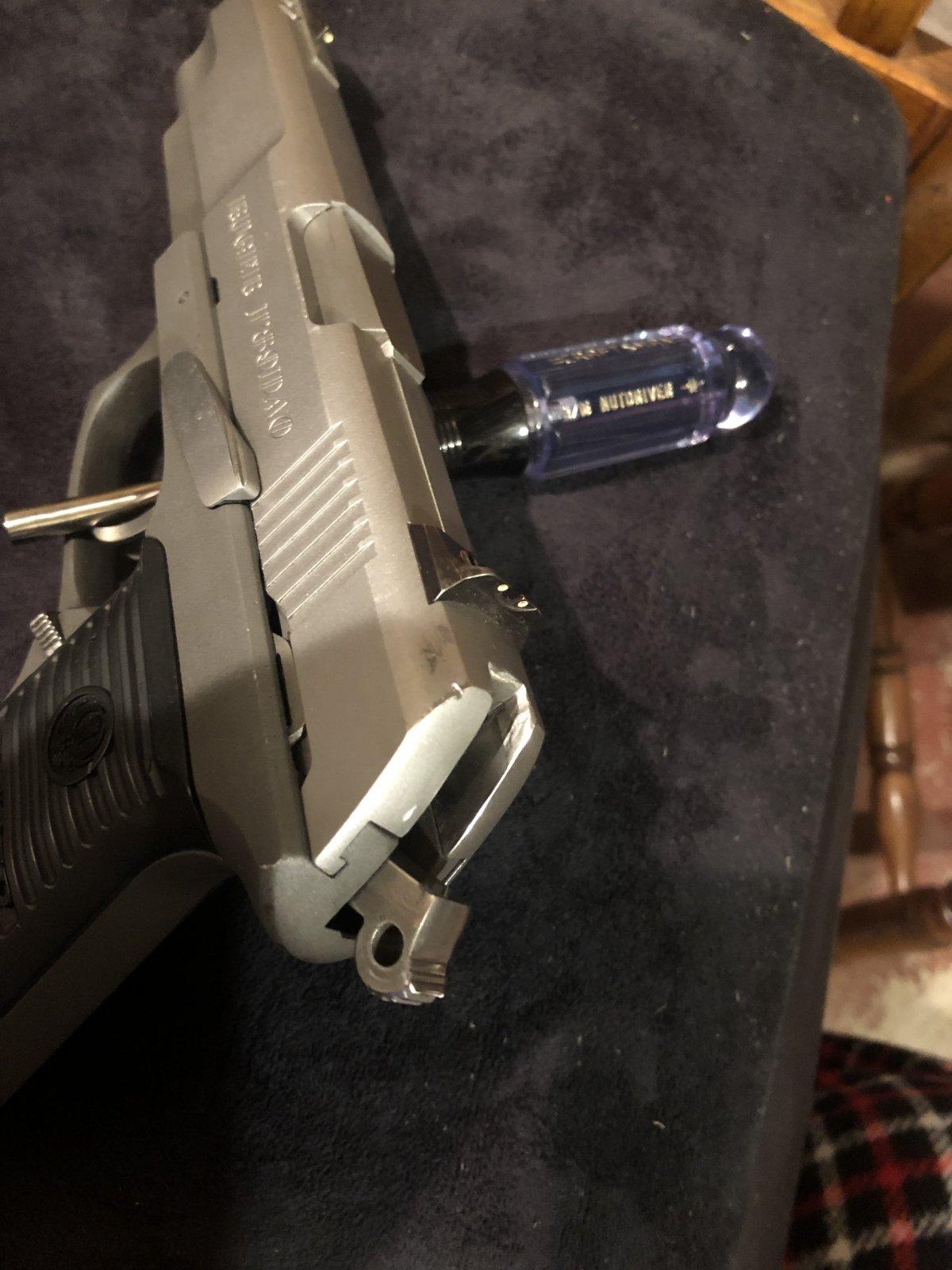

Mine was a simple swap of standard 89 parts with a hammer mod to make it easier to safely uncock the hammer if the need arose. And a slot in the slide for the extra hammer height to fall into. It was fun and I enjoyed myself.

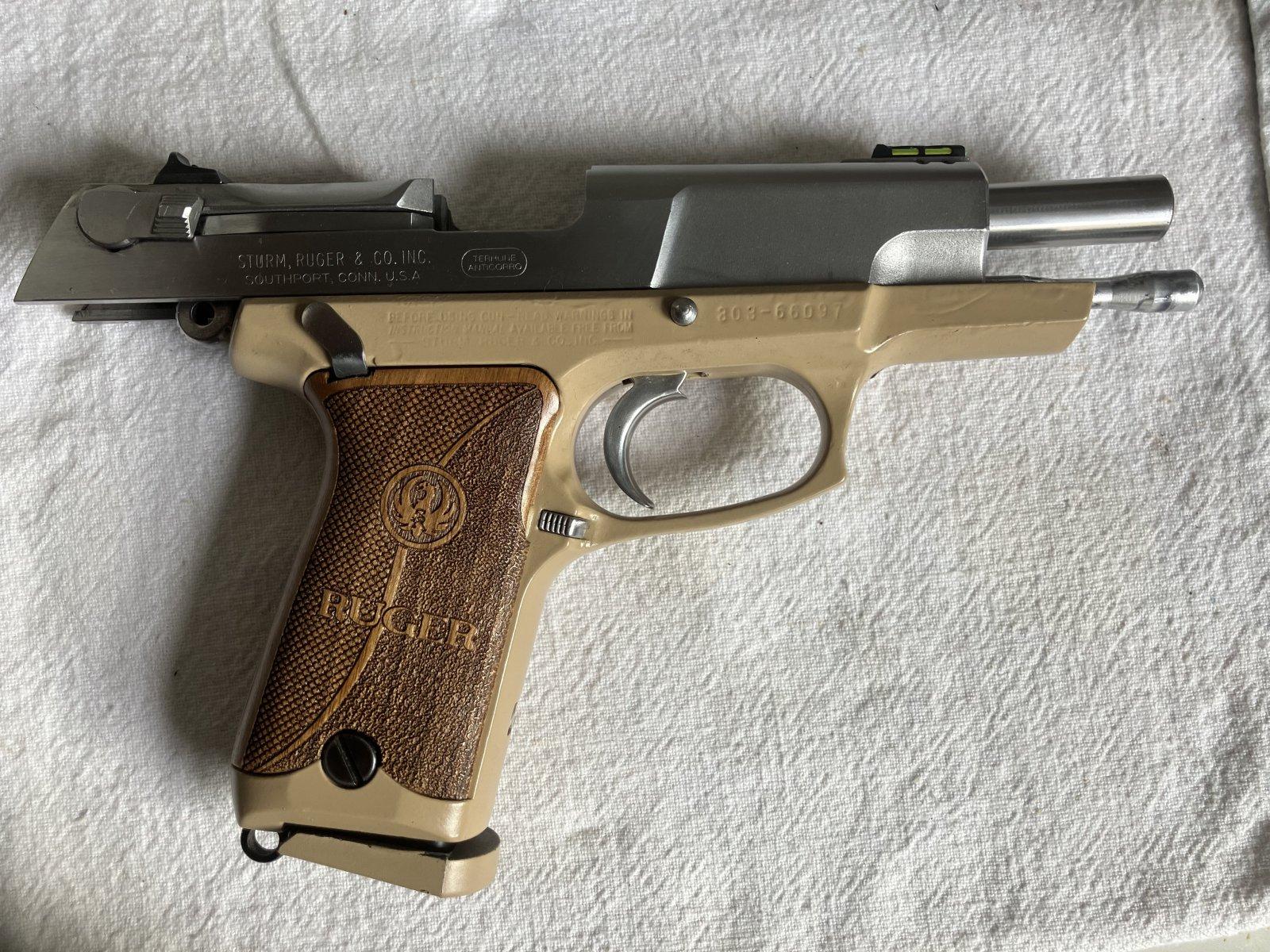

FWIW, the slide is complete with safety, firing pin, etc., and already trimmed/recontoured (photos below; barrel & recoil assembly are to show what worked for me, are not 'spares' and are NOT AVAILABLE). I used it on a P85 frame before I sold that handgun. Don't know how well it shows, but it seems to be getting that purple tint Ruger bluing is known for!
I shortened a P85 barrel (very carefully, by hand, with a hacksaw), and recrowned the muzzle with a tool from Brownell's and a .375 cartridge case inside neck reamer (to get a clean termination on the rifling). I've done that kind of project before (using the tools & methods recommended to me by a professional gunsmith), so it wasn't my 'first rodeo'; I've been happy with the results, but one size never fits all, and obviously YMMV!
I don't think a P89 barrel will work for you, unless (maybe?) it's an early P89 barrel, that looks like the P85 barrel below. I just tried a later P89 barrel in the slide & frame shown, and it wouldn't drop low enough to allow the slide to be racked.
