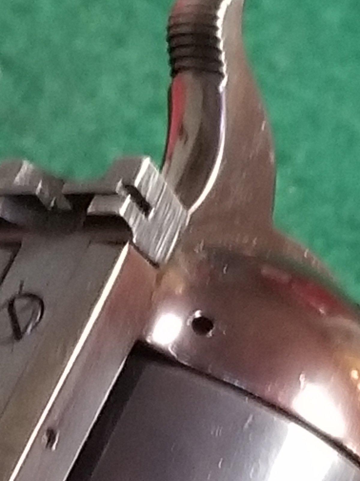

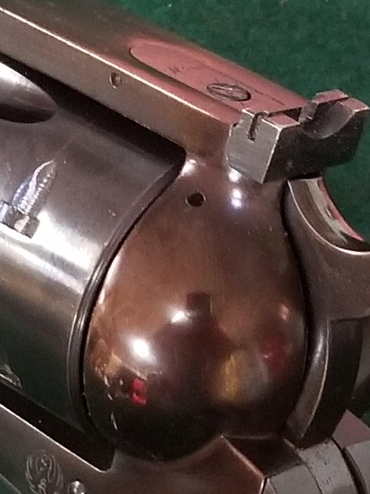

I recently acquired this .44 Blackhawk Flattop and I am looking for thoughts or information on a couple of odd issues with this revolver. The first is that there is a small hole in the left side of the frame right next to the rear sight. It doesn't appear to have been threaded and I'm wondering what it's purpose could be. Has anyone ever seen this before?

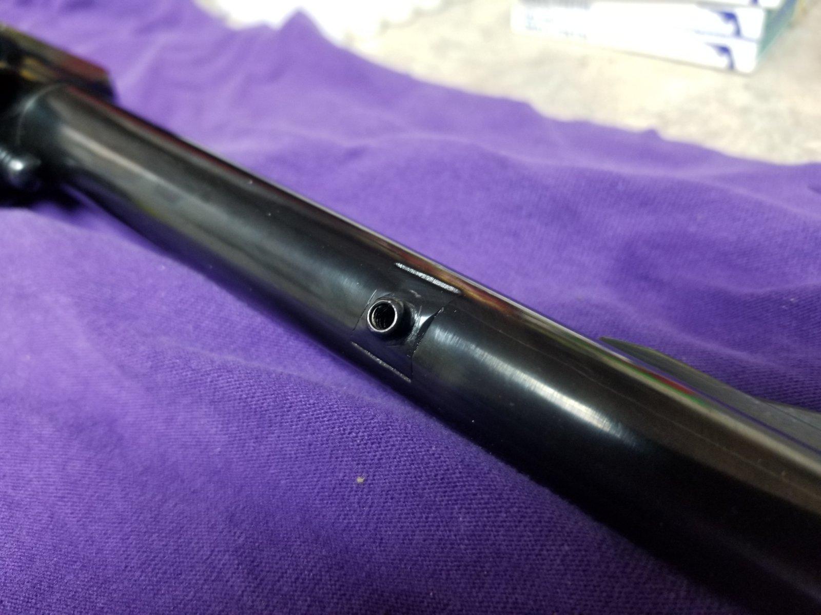

Next is the stud that the ejector rod screws into. I could see a line on the barrel right above the ejector rod housing screw. I didn't think too much of it, but when I removed the ejector rod, I could see all four sides of the dovetail that the stud attaches too. I have two other Flattop .357's, another Old Model .357, an early .41 Magnum Old Model, and a .45 Colt and .30 Carbine Old Model, and I can't see any trace of the dovetail. It makes me wonder if there was some work done to this barrel??? When I first received the revolver and was looking it over, I wondered if the barrel had been re-blued because it seemed some of the lettering on the left side of the barrel wasn't quite as sharp as it should be. Then when I saw the dovetail, it kind of re-affirmed my feelings of work being done and a re-finished barrel. I have since looked it over again a little closer, and am just not sure if that is the case or not. Again, does anyone have one of these where the dovetail is so apparent?

Wow, some interesting things going on here.
First, the hole is where the firing pin retaining pin is pressed in.. The pin is usually flush with the frame an finished along with the contour of the frame. Finished so well that many folks don't realized it's there. This pin seems to be a bit short, & has likely been removed at one time or another. Two reasons for that, a broken firing pin, or the gun has been refinished, the firing pin spring needing to be removed before this process.
The dovetail? About 99% sure is not factory, & a really different approach for a repair of pulled loose or stripped out retaining screw bushing.
And, I would agree that there has been a re-blue.
gunzo is spot on.
The hole is the firing pin retaining pin hole. Take a light & look into the hole to make sure there is a pin in there. If not,, you'll want to get a gunsmith to PROPERLY install one.
Next,, that dovetail is NOT factory. Ruger never dovetailed a ERH stud. Most likely, someone had a sheared off screw, or a stud fell out & a gunsmith dovetailed a piece into the barrel.
Dang, well that's not good news. I don't know that there is any pin in this hole. I'm not home right now, but it looked like the hole is fairly deep. You say to have a gunsmith properly replace it. Is there a trick to it? Is this pin available? Is it also called a 'recoil plate cross pin'? That's the only pin in that area on the parts diagram.
The “Pin“ is on a diagonal, starting where you can see the hole (in your example) and ending in the loading area, if you look hard, under good light on your other guns you can see it.
Most of the time the pin it flush and finished,,, but sometimes it’s a little short or an edge will show.
FWIW; I have never seen one left proud. They can be left short,,, usually in the loading area, quite common.
Recoil plate cross pin is exactly what it does. As for ordering one, I have pulled many, but have always just used the same pin. Sorry no help there.
The dovetailed ERH Screw Hole is an interesting fix, I’m thinking the screw broke off, and extraction didn’t go so well.🙄
TIP: Check your firing pin length and make sure your spring is good, before you go to re-doing, especially where it appears a little bubba kitchen table gun smithing has taken place.

Some Ideas; The dovetail fix just needs a little massage with a TIG weld. Pull the barrel and cut it to 4.6”, and while the barrel is off, carefully flatten out the over buffed lettering etc. Could go back with a dovetail front sight, and then….😁😁

I'm glad to hear the seller is making this right for you. Looks like a solid "shooter" grade now,, so enjoy it. (After you get the firing pin cross pin fixed or are sure it's there. )
Yes, there is a cross pin there, but I believe it is not a correct pin. Looks like it was cut on one end, and it is not blued. I also found the trigger plunger spring and the loading gate spring seem to have had one end cut to make them the right length. The ejector spring was also two separate springs put together to the correct length. Not sure what exactly happened to this revolver in the past, but it seems to have had its share of issues along the way. I have located the cross pin and correct springs online, so I will replace them and have an early 44 Blackhawk shooter until I can find a 4-digit .44 to go in my collection.

Sometimes guns get used as tools with no regard to it's collectability 50 years away. The ejector housing retaining stud repair? Could've been performed with a couple of hand files in a remote cabin.
The springs? same. Heck, I've got decent rifles that include springs from ink pens in lou of the factory ones for reduced trigger pulls.
The re-blue on this one? likely someone trying to cover all the homestead repairs by a flipper.
