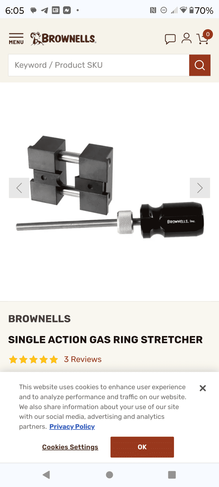

On another forum I heard mention of a Brownells device that will lengthen the nub on the front of a single action cylinder.
Does anyone have FIRST HAND EXPERIENCE with this device,or possibly own one?
Thanks in advance...

I had one at one time. It works. I just didn't need to keep it,, and someone else needed one. But it only moves a small amount of material,, so if you have a large problem,, the gas ring stretcher won't work.

...over the years we would weld it up, put a piece of 1/4 in brass or bronze rod in the center pin hole weld around it, sometimes you could simply "tin" the surrounding flat end with solder. or now days they offer "shims" but the only time we ever used shims we glue them on and recut them, nothing like any small parts falling out at the range or on a double action revolver the shim "splits" and screws itself around the inside of the cylinder , and into ,under, the yoke (upper crane leg)..........seen it happen:cool::cautious:

I have one. Works as advertised. The hard part is fitting the cylinder. Easy to over do ever so slight metal removal on gas ring.

I only need .014",Brownells says max is .040"...
