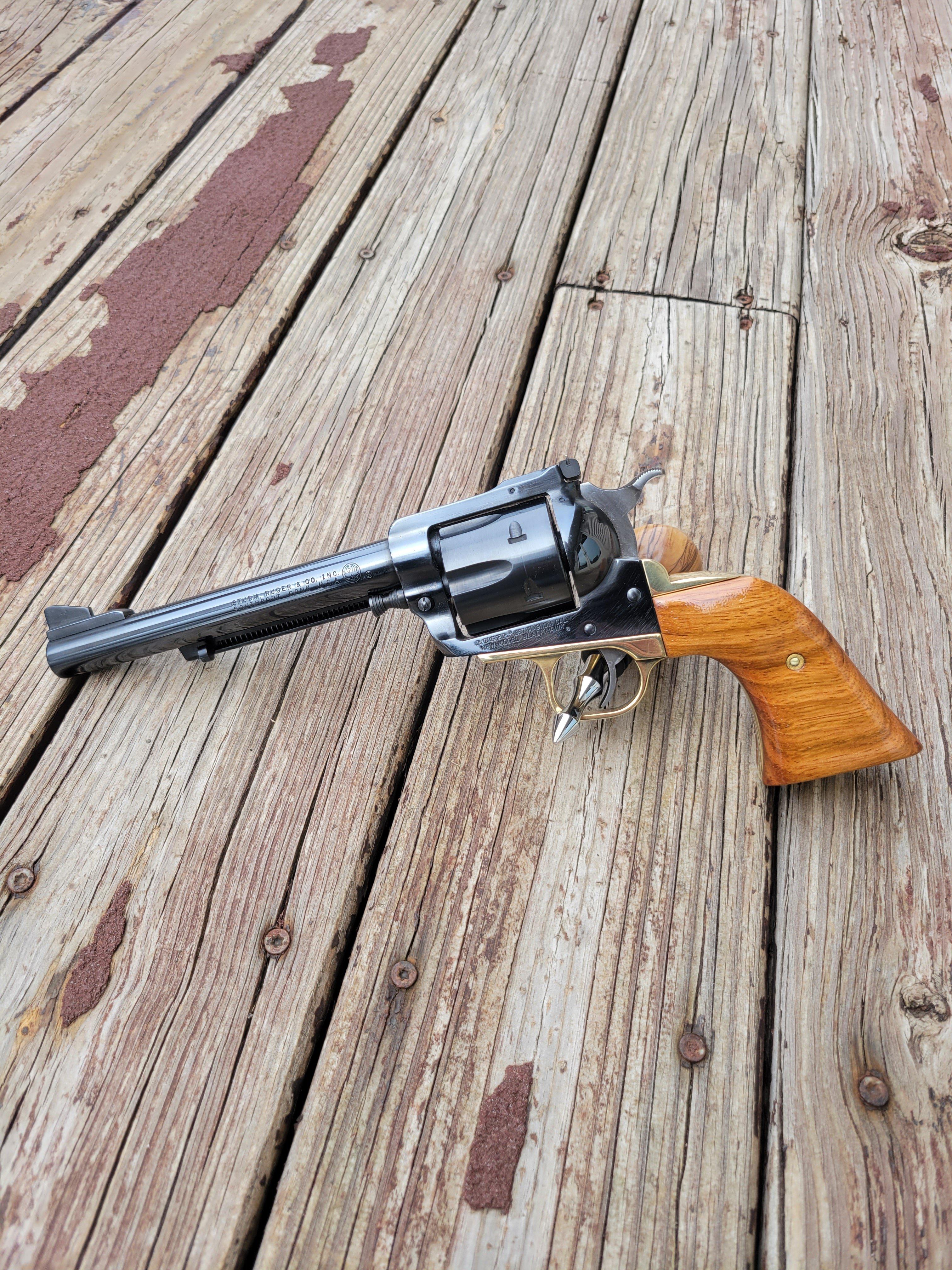

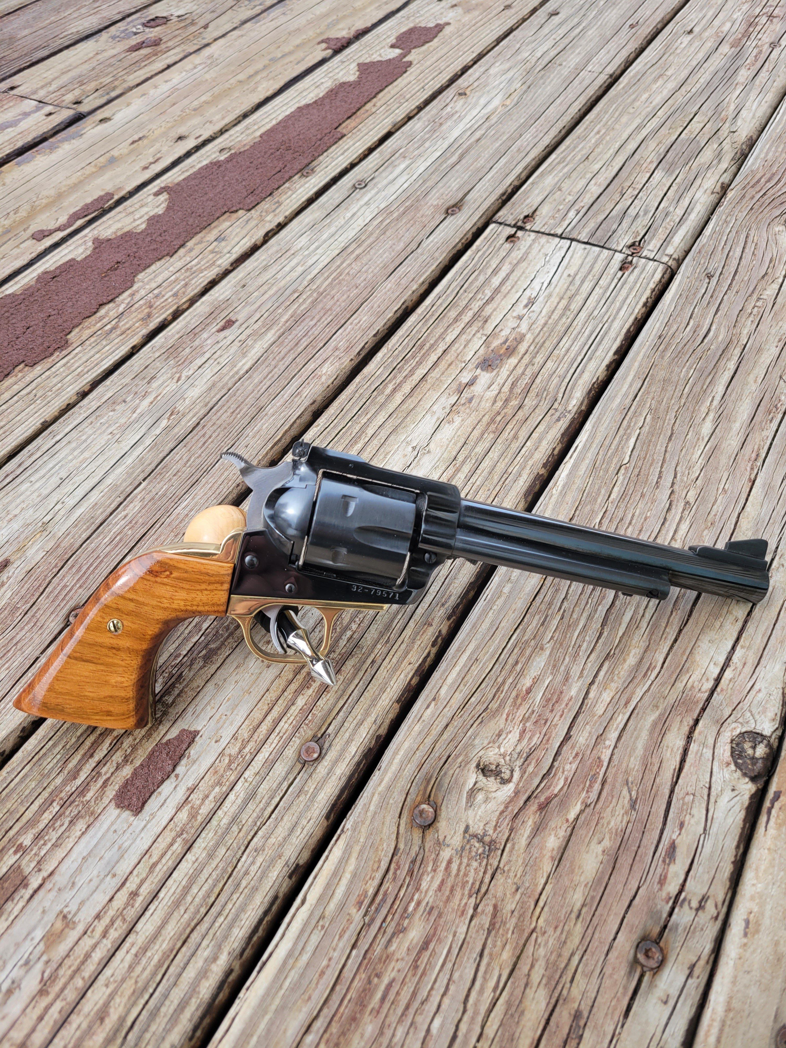

Just finished these panels for my restored 1980 blackhawk 357, the wood is Jatoba, aka, Brazilian cherry, gun was pretty rough when I bought it, I polished and sent out for reblue, I fitted a RWGF brass xr3-red grip frame , blued super blackhawk hammer and trigger, belt mountain base pin, checkered ejector rod, and made the panels to fit, thanks for looking.

Your .357 Ruger Blackhawk looks terrific! I also own a .357 Ruger Blackhawk, only I bought mine in 1965. Mine is a 3-Screw gun (note the 3 screws above the trigger), and I can tell from your pic that yours is not. So, yours has came with the transfer bar, and I had to get mine updated by Ruger to get that installed to make it safe to carry a live round in the chamber. Prior to that mod, it could go off if dropped or the hammer was bumped, and that is why all the Western cowboys back in the day left the active chamber empty.
