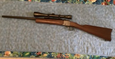

Got struck by a case of the lazy today. Number 3 is in basement and I’m not! This picture shows it with the scope that came on the donor, but if you click on the thumbnail, you should be able to see the octagon barrel. The target shows the last 5 rounds of pistol ammo on the first trip with the Weaver installed. Note the near double and the true double. My only excuse for the flyer is that I was trying to adjust to that post and crosshair reticle; and no, I didn’t call it! 🤪

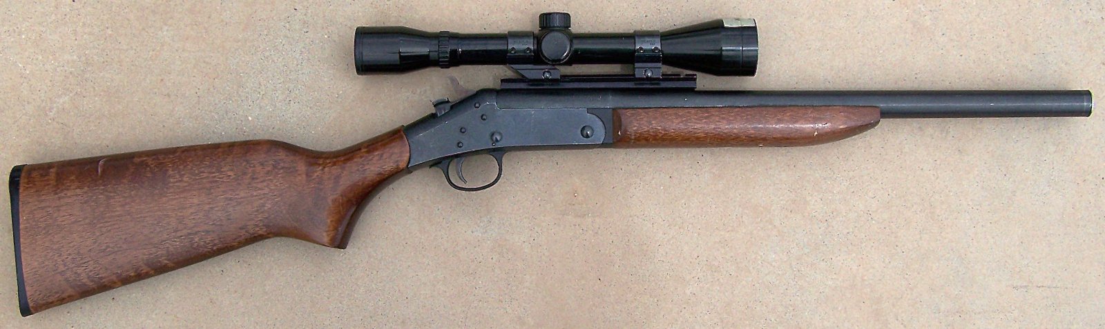

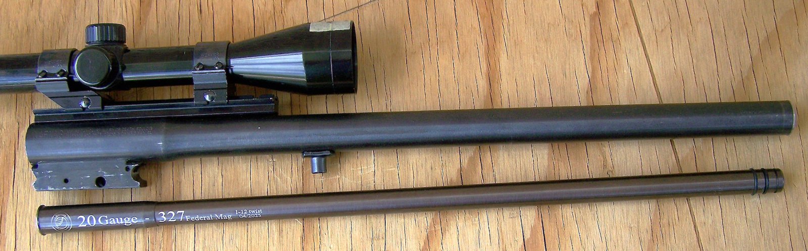

Certainly not in the same league but I too felt the draw of a single shot in 327/32mag.
Been watching these barrel liners for a while and figured it was a fun place to start.
Not a lot of time invested yet and still dialing it in, but.
So far not Camp Perry accuracy but better than expected. Seems to average about 2" at 50 yards. Have not really shot it past that but a bunny would be in trouble.
Chronograph numbers are IMPRESSIVE. With slow powders they easily get gas checked 120 grainers 1800-1900fps and I have not even pushed for the ceiling yet.
And it will easily switch back to 20 ga for birds, etc. that's a great package you have there. Congratulations.
BTW, who made that adaptor barrel? I have an OH shotgun that would work well with one of those!
