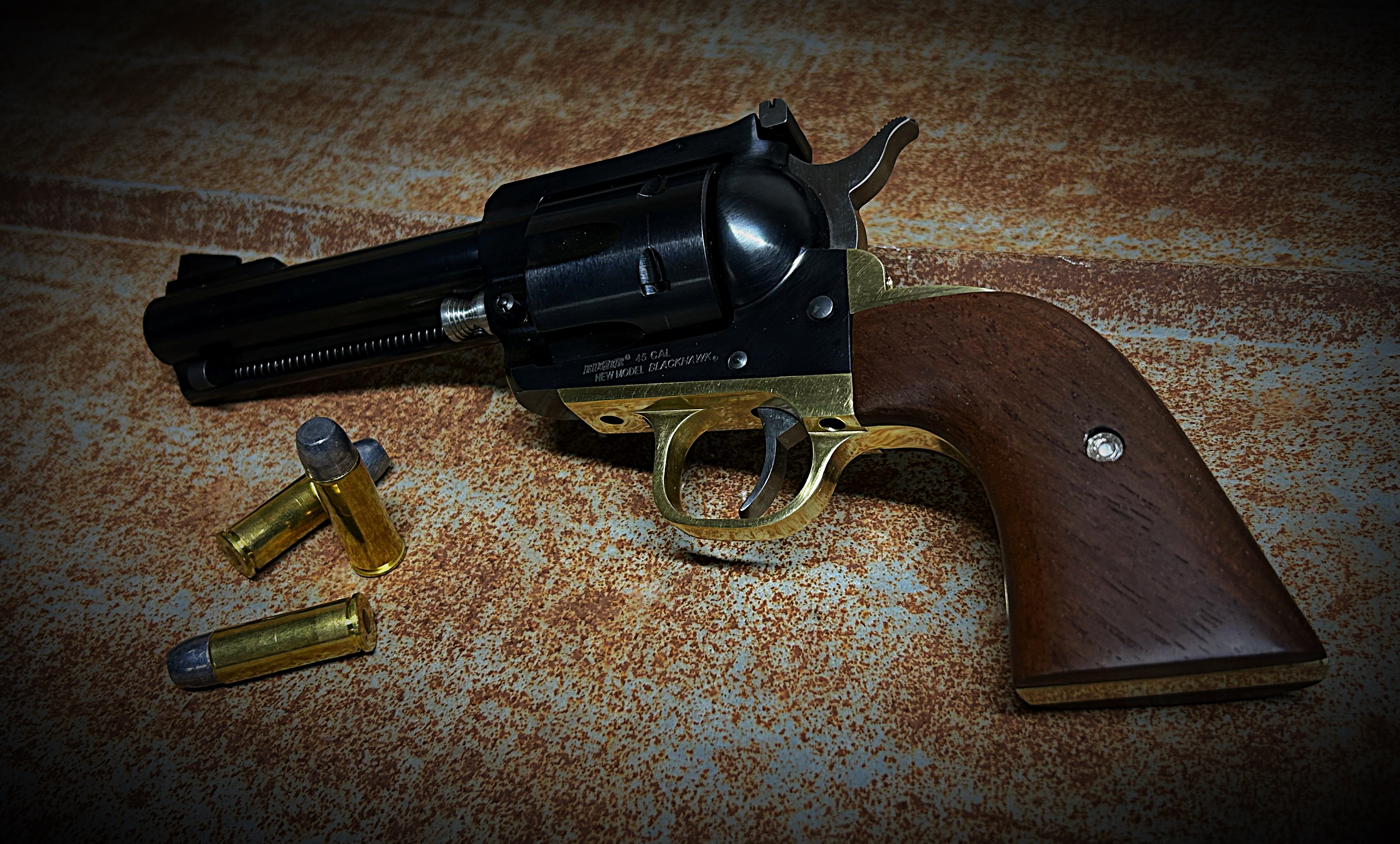

Who did the custom work on that Beauty?
I did the work with the exception of the Ceracoating. I did disassemble and reassemble the revolver for the Ceracoating but a young gunsmith whose name escapes me did the application. He later moved out of state. Swapping the Bowen Rough Country rear sight, the Eagle grips, and the 454 Super Redhawk cylinder was all me.

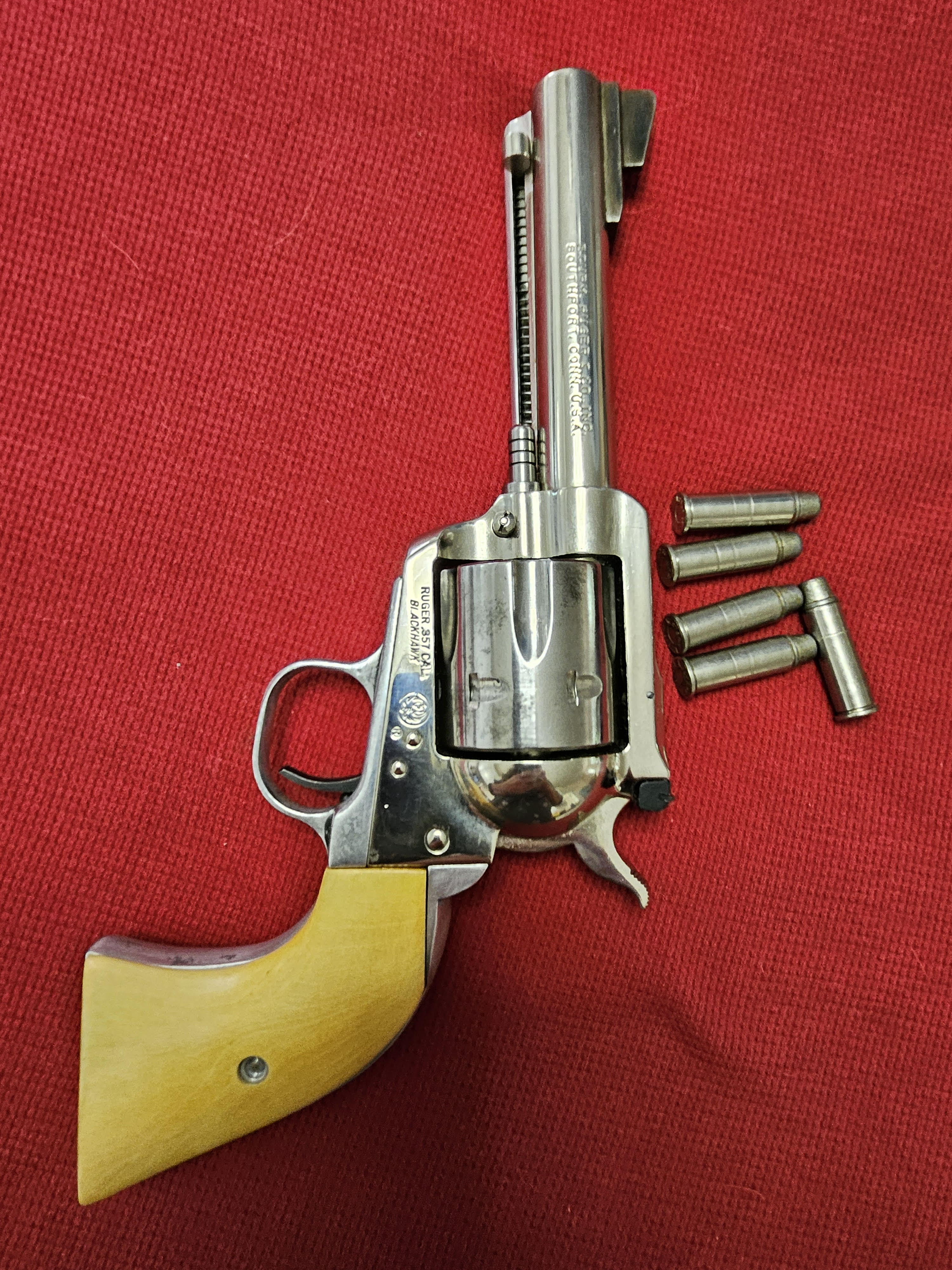

Thank you, if I can't do it, it doesn't get done. It wasn't that difficult. It's actually a friend's gun, he always wanted a ribbed barrel and fluted cylinder on his very 1st 44 Mag from 1961. Carried it every hunting season and back packing over the decades. Had little blue finish left on it.
-Started with a Mod 29 8 3/8" barrel. Cut off the ejector rod housing and contoured the bottom of the barrel to round.
-Turned off the S&W thread which shortened the barrel to about 7 1/4", and cut Ruger threads. When I screwed it into the frame I had to remove a little from the front surface face of the frame so the barrel rib wasn't encroaching into the bevel of the top front corner of the frame.
-Drilled and tapped the hole for the Ruger single action ejector rod housing screw.
- Found the fluted cyl on Gunbroker from the 5 1/2" SBH.
-Polished it to a high gloss all ready for him to send back to Ruger for bluing.
He never did. That was about 8 years ago. He shoots it, cleans it once in awhile and it still looks the same. Never polished it and it never rusted. The frame looks wavy but it's just the bad photography. As well as what looks like the ridges around the cyl pin collar; they don't exist.

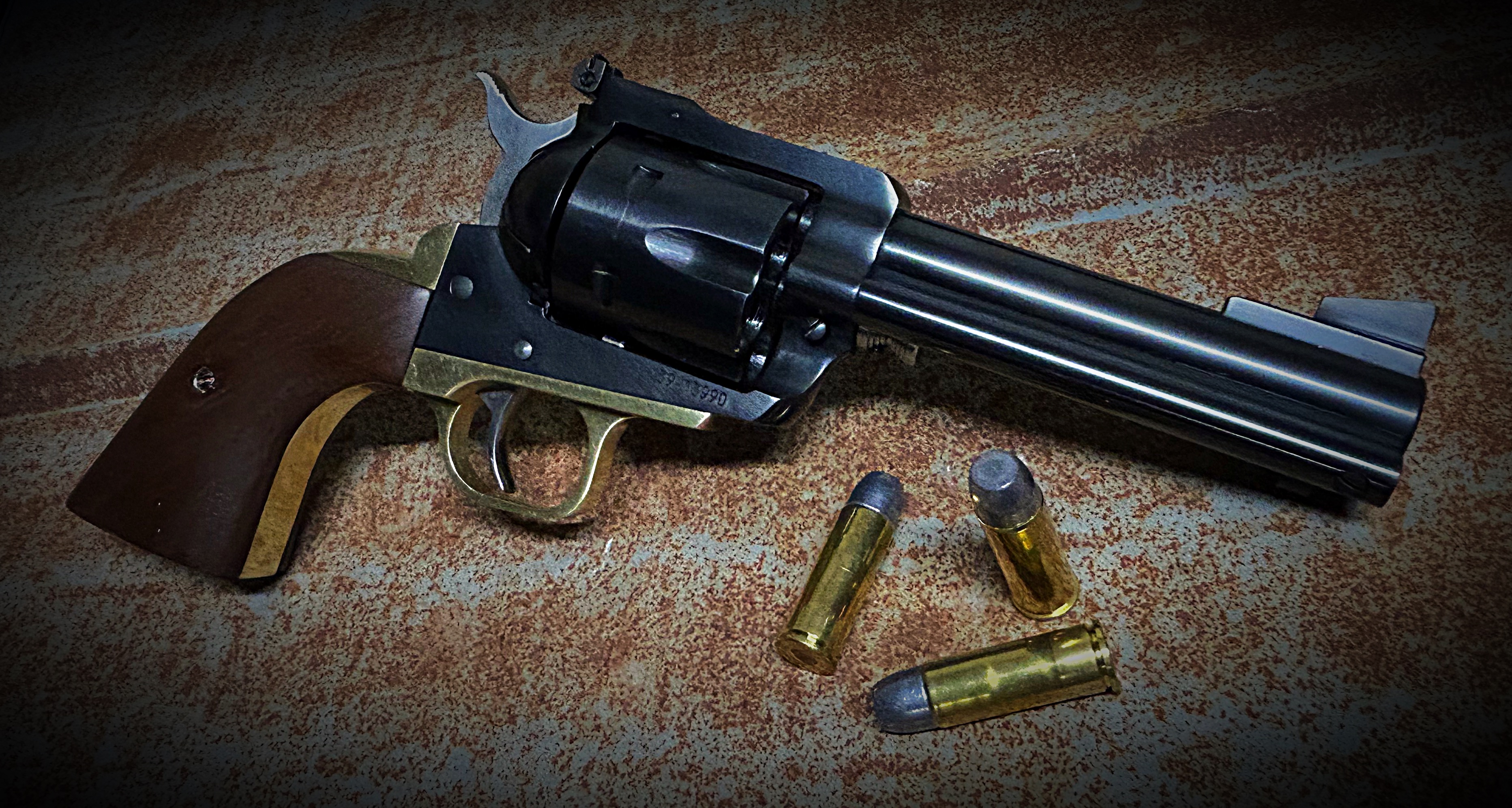

View attachment 97806View attachment 97807View attachment 97808DIY makeover. Reamed the throats, base pin, reshaped and hand fit a brass grip frame, handmade grip panels, action/trigger job.
That is impressive accuracy at 50 yards. What was the accuracy before the trigger job and throating? What made the biggest improvement, if any.

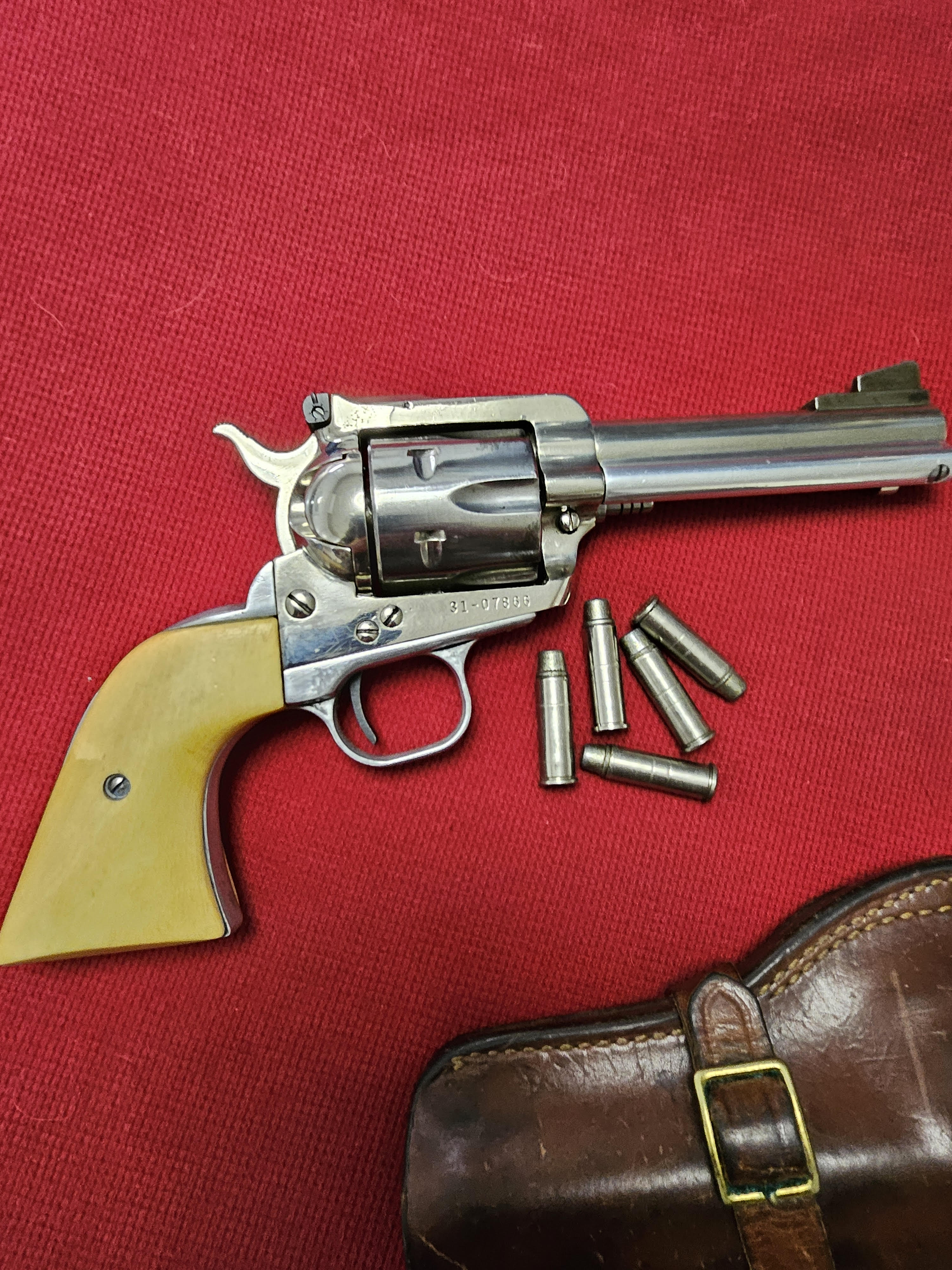

I wouldn't really call this a "custom" myself....but:
This is my old 3-Screw, nickle plated, polished aluminum XR-3 grip frame, high-polished stainless NM ERH, and collared NM base pin. I bought the holly wood grips off of a previous member who doesn't post here any longer....Over the years, this thing has been rebuilt twice. Not a single one of it's original action parts remain. It's last rebuild also required a cylinder bushing be fabricated/installed to correct an excessive end shake condition. That is also when I installed the new (collared) base pin. If you look closely at the photo(s), you can see that it's nickled trigger got replaced with a blued trigger from one of Ruger's infamous "safety conversion" kits which I modified to work with the original-type lock work....All in all, not as nice as others that's been posted....but I like it.

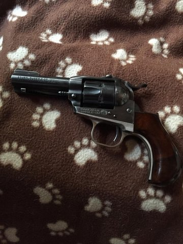

Came to me as a parts pile. No base pin, no grips and damaged barrel and ERH.
Seems that when they stripped the hole where you attach the ejector rod housing they simply attempted to weld the housing to the barrel.
Well , that did not work and the parts were trashed.
As the barrel needed to be replaced anyway, I figured I had nothing to lose,,,,,,,,, Hacksaw snubby time. :eek:
Along the way it got an RW grip frame and a SBH hammer and a Bisley trigger. The dovetailed front sight was supposd to be changed for somthing better looking after I tuned it to the proper height. But it is working so well I never get around to swapping it out.
Not a gun for full house 44 ammo but a "Hoot to Shoot" when downloaded.

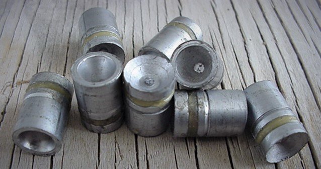

I have been shootin it mostly with these things I picked up somewhere.
Monster hollowpoint + a concave base makes them lighter than they look. About 200gr. if I remember correctly.
Plant that on about 7 gr. of unique. Not real fast but they do fly straight and would probably be devastating

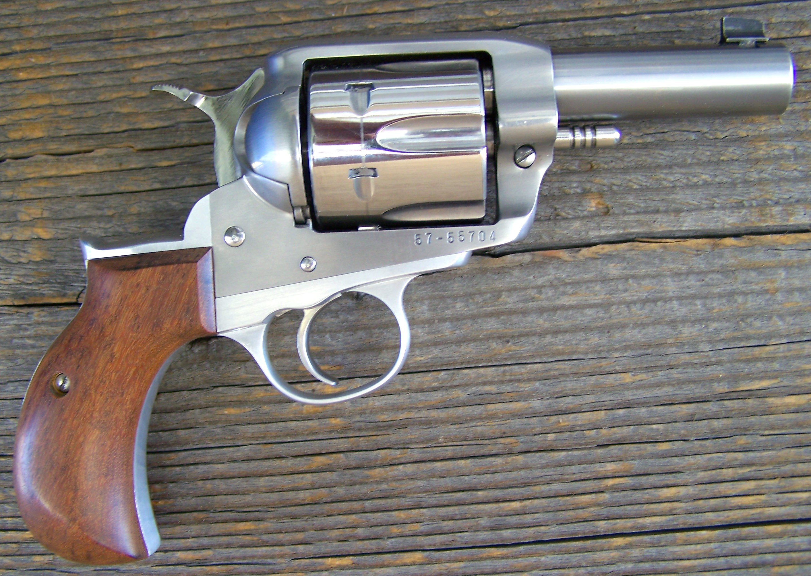

That's unique! Talk about turning a lemon into lemonade! The Colt lightening grip sure beats a birdshead.
Tell us about the finish.

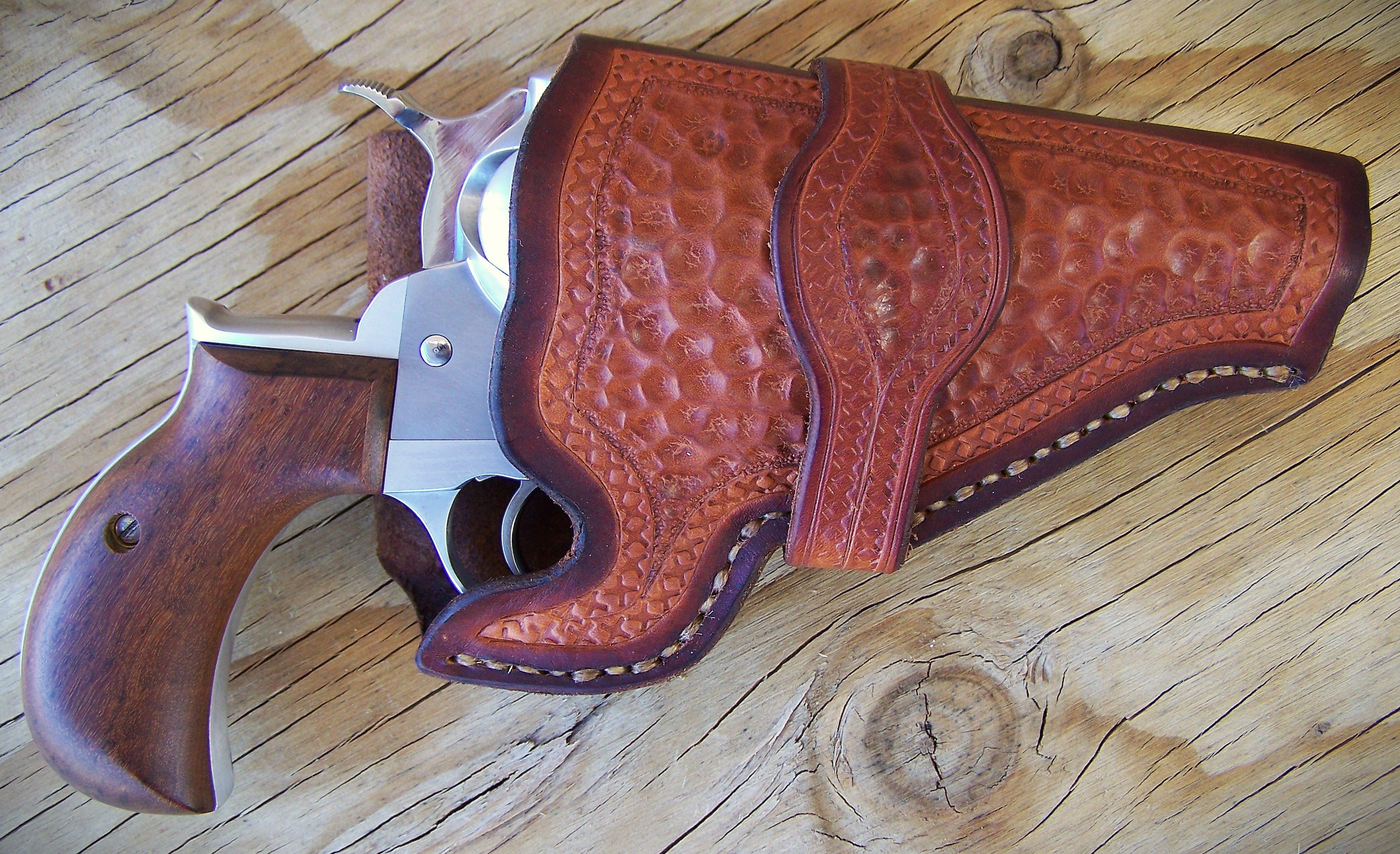

Not as nice as yours but I made something similar for a friend with a single six and the backstrap from a Cimarron copy of the Colt Lightening like yours and Power Custom trigger guard-front strap. This photo is before I made the final grips to fit the Ruger front strap and Colt backstrap:
Nothing fancy going on with the finish. Just Stainless with alternating polish and scuff pad. Grip frame is naked aluminum.
I would do it all again with a .22 like yours as they make such wonderful walk-about guns.
It even got its own little holster just for that.
