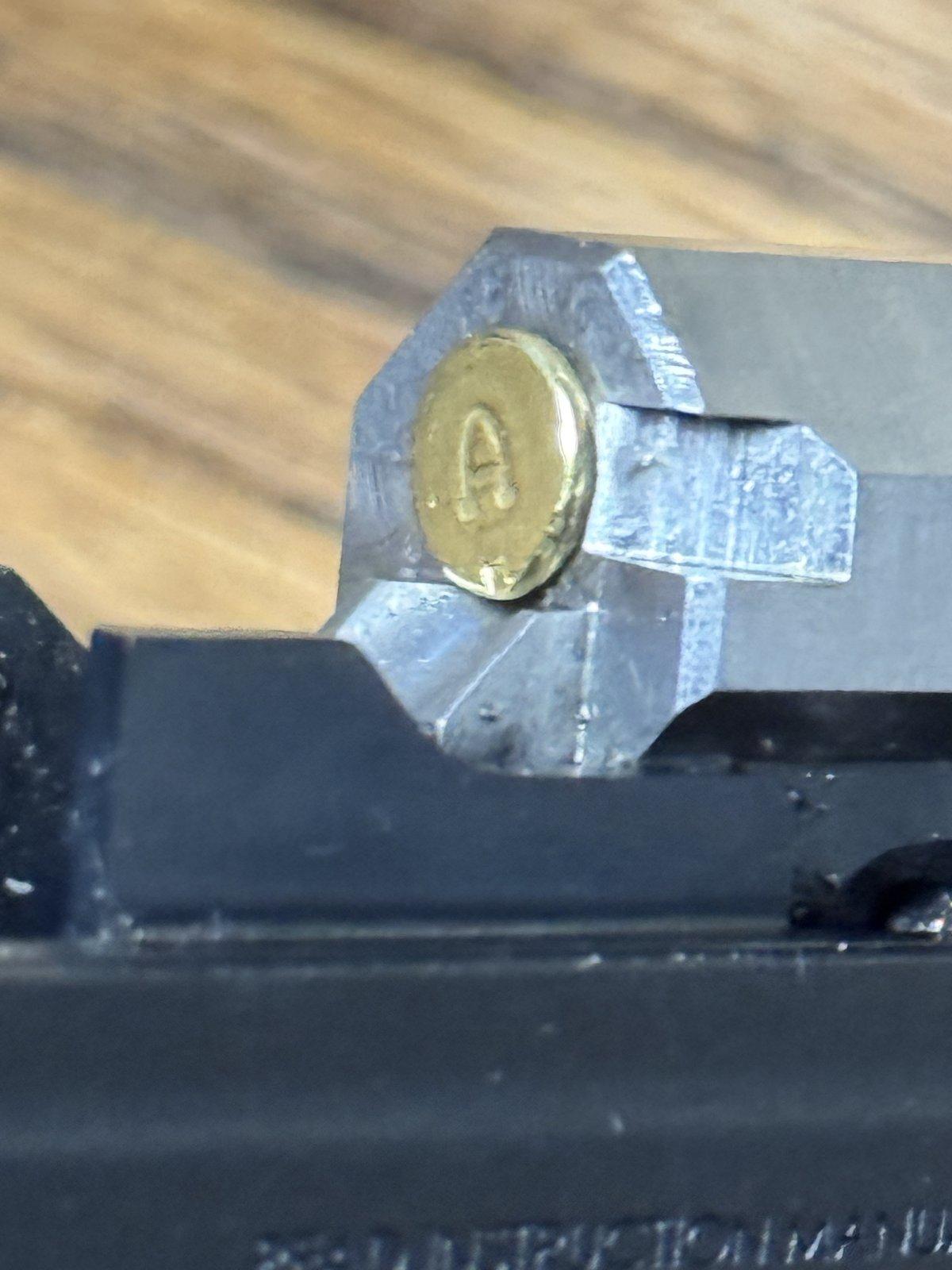

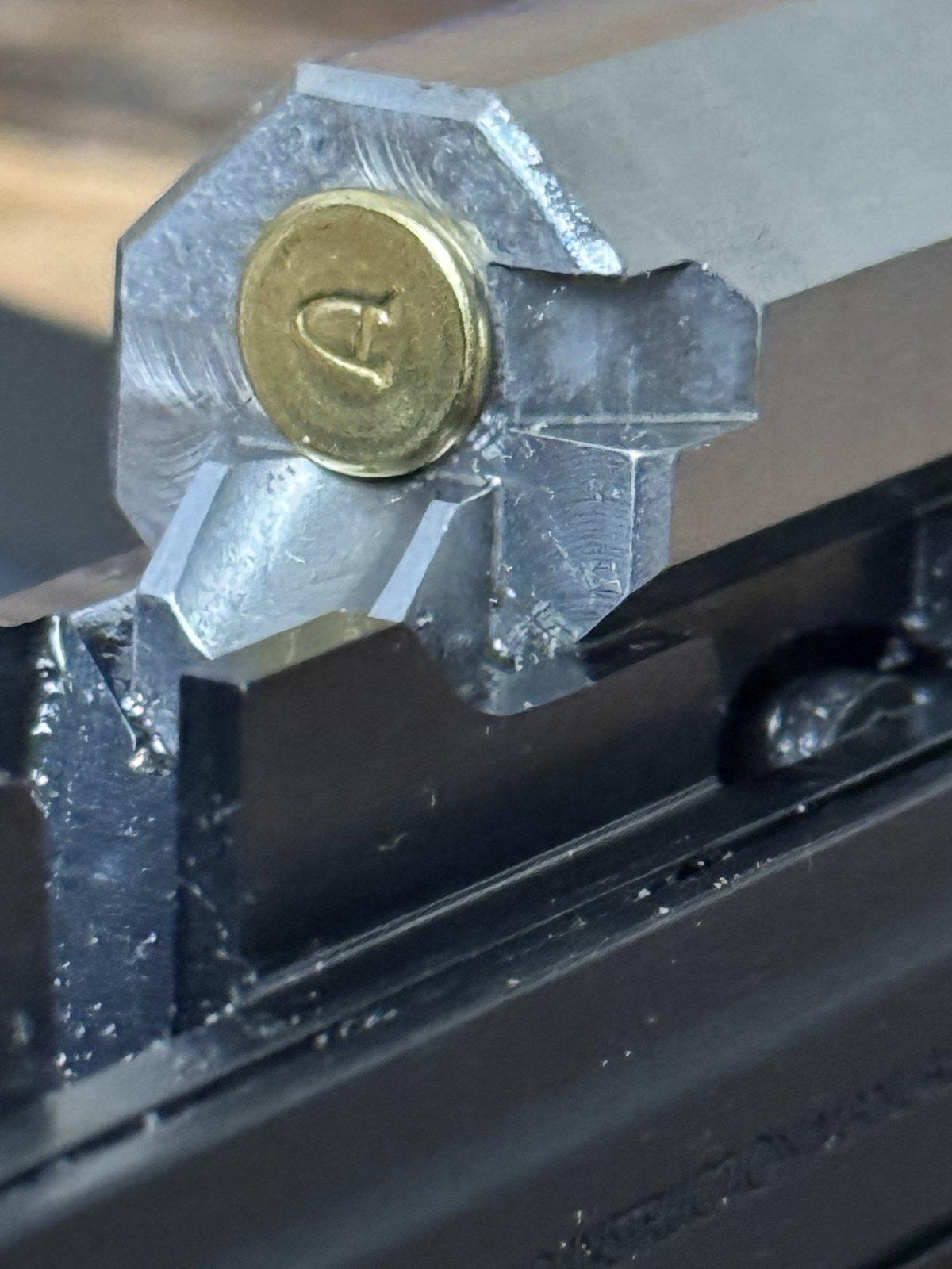

I tried cycling the slide multiple times when the FTE first occurred. That had no effect. However, since posting about the problem here I've found some interesting info on other forums that seem to indicate that is normal behavior for a .22lr in a blowback operated pistol such as the SR22. On such pistols the "extractor" does not engage the case to pull the spent round out of the chamber as it does on larger caliber guns. On blow back operated guns the case "self extracts" as the pressure in the firing chamber pushes out the case which then acts as a piston to move the bolt/slide to the rear while the extractor merely holds the case against the bolt face until it contacts the ejector. At least, this is the way LDBennett describes it on The Firearms Forum. His description also fits my observations and examinations of my SR22. As the photos here show, there is no gap or overlap available for the extractor to engage the case at least until it has already moved to the rear on its own. A couple of other points also should be mentioned: the FTE occurred with the last round from the magazine and the slide did not lock open after the round fired. Since I did not anticipate the failure I cannot say for certain that the slide even cycled fully. It is possible, even likely IMO, that the round was simply under-powered and the slide did not travel back far enough to fully eject the round so it was reseated in the chamber and had to be removed manually.

Regardless of WHY the round wasn't extracted, the complaint originally asked about was the case contacting the magazine follower when forced from the chamber with a dowel. " I noticed it collided with the vertical face of the magazine follower." :unsure:
Sorry, I thought my subsequent post clarified that when I wrote this:
I did do some more examination and discovered that the underside of the breech block actually sits in contact with the magazine follower (or next round) and keeps it slightly depressed during the ejection sequence, enough to prevent the potential for collision I described originally.
