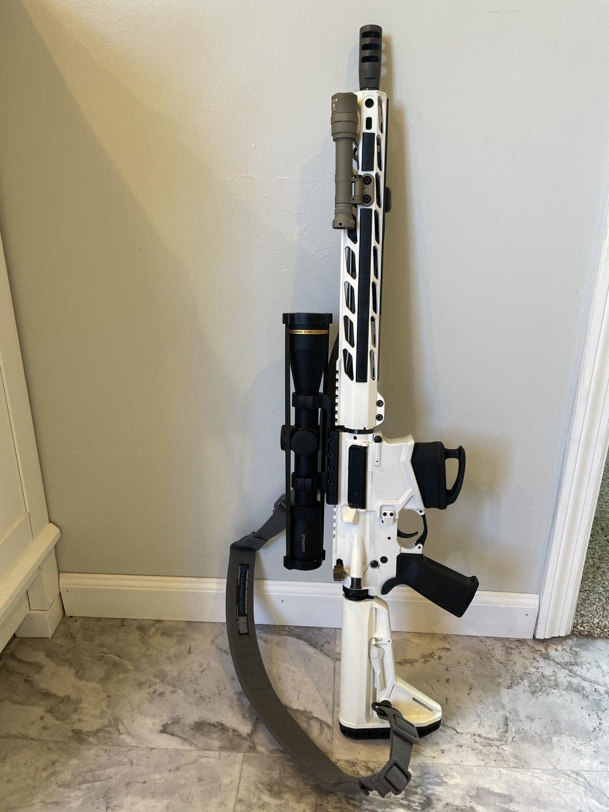

Hey, I see that this post is old but I have the 16 inch version and if you’re interested in trading barrels and associated gas items, I would like to make a musket out of mine. A 20 inch barrel with a 7 inch suppressor would be pretty sweet. I am planning on hunting not room clearing so don’t care about length.
    188.4 KB
Sorry I haven’t been active, I’d actually be willing to make this trade if the offer still stands. I see you’re in Tennessee, how close to Chattanooga are you? Feel free to dm me.
