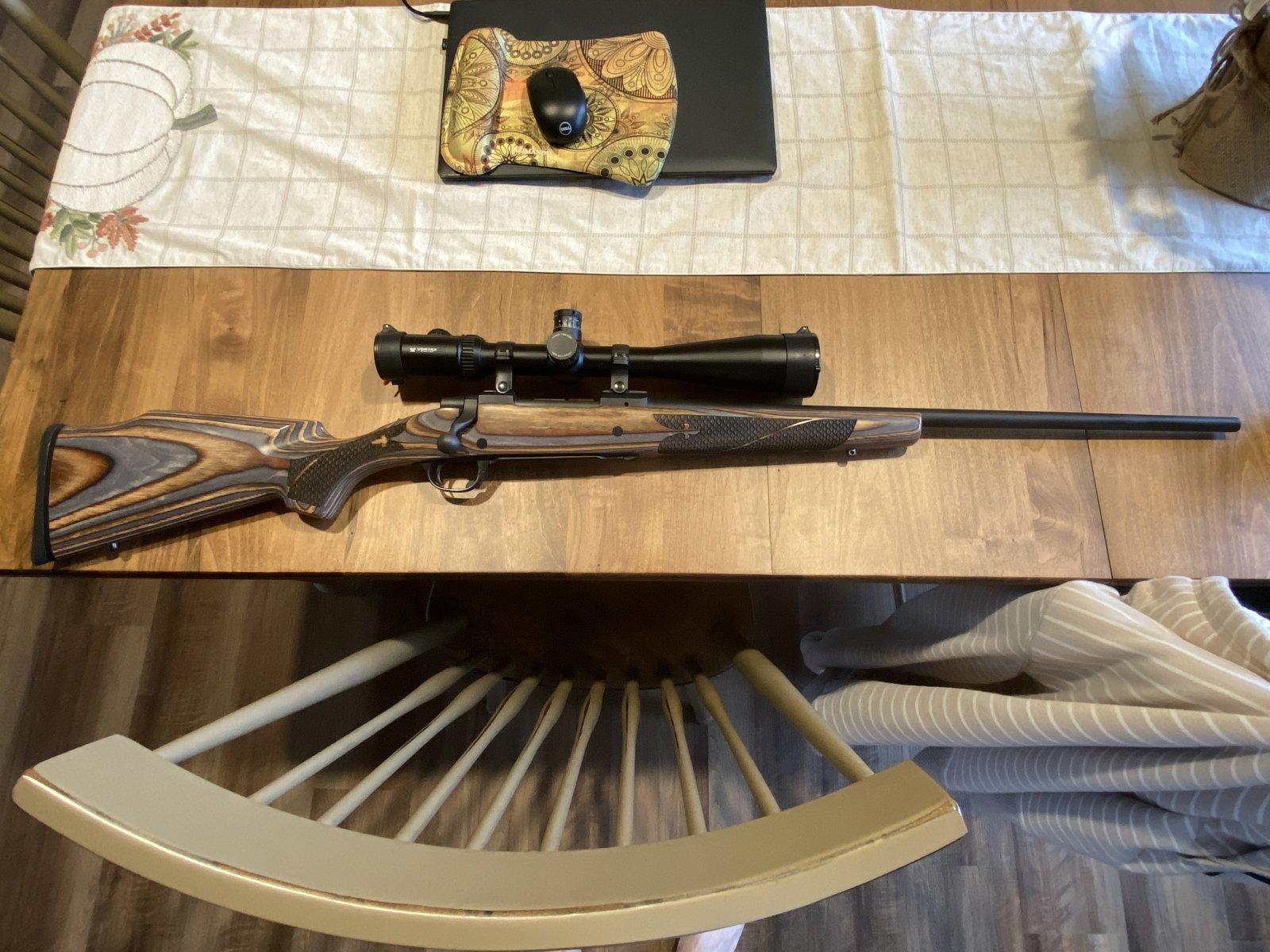

Changed to Boyds stock on the tang safety ruger 77 in 7x57ai. Floorplate barely latches and falls open when fired. Last night, I bedded it in Marine tex gray and moved it back slightly. Easily latches and stays there now. Also replaced the cheesy aluminum trigger guard with a steel unit.

This turned into a bit more than expected. Had to inlet barrel channel as barrel was touching stock when screws were torqued. Had to inlet rear tang to get safety to move. When rear screw was torqued safety was binding against stock. All ready to be zeroed in.

Good work.... always a PIA when we have to modify stuff, but patience and some thought will sometimes work. It did for you...
The free floated barrel should provide some good accuracy.

Completed rifle. Ruger M77 Mk1, Krieger 22", 8.5 twist 5R rifled barrel, Timney trigger @ 2#. Hope to go to range tomorrow to zero it. Running a 101 Hammer Hunter at 3314 fps (not max) over N-540. 3 weeks of deer season left to try it out
