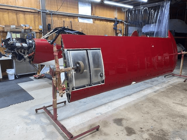

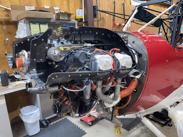

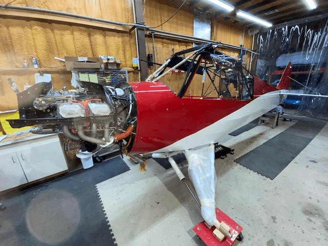

Engine is installed and components are hooked up. The engine cowling has been fitted and painted. Prop and spinner has been installed but removed so The Old Fat Guy doesn't keep running into it.
Instrument panel and wiring is pretty much finished and every thing works:-)
Installed and rigged tail feathers.
I will be going back to Trey's in 10 days for 3 weeks. We will be installing the wings, fitting the windshield and other components that couldn't be done until wings are on.

The fuselage and tail feathers are 4130 chrome moly steel that is welded together along with a few other parts. Unlike my Starduster Too which I bought the raw tubing and welded it myself. All of the welding has already been done for this one.
The wings have 2024-T3 alum. spar, flaps and ailerons. The ribs leading edges and miscellaneous parts are riveted and bolted to the spars
Caryc You mean like this??? Looks good but doesn't fly very well:-)

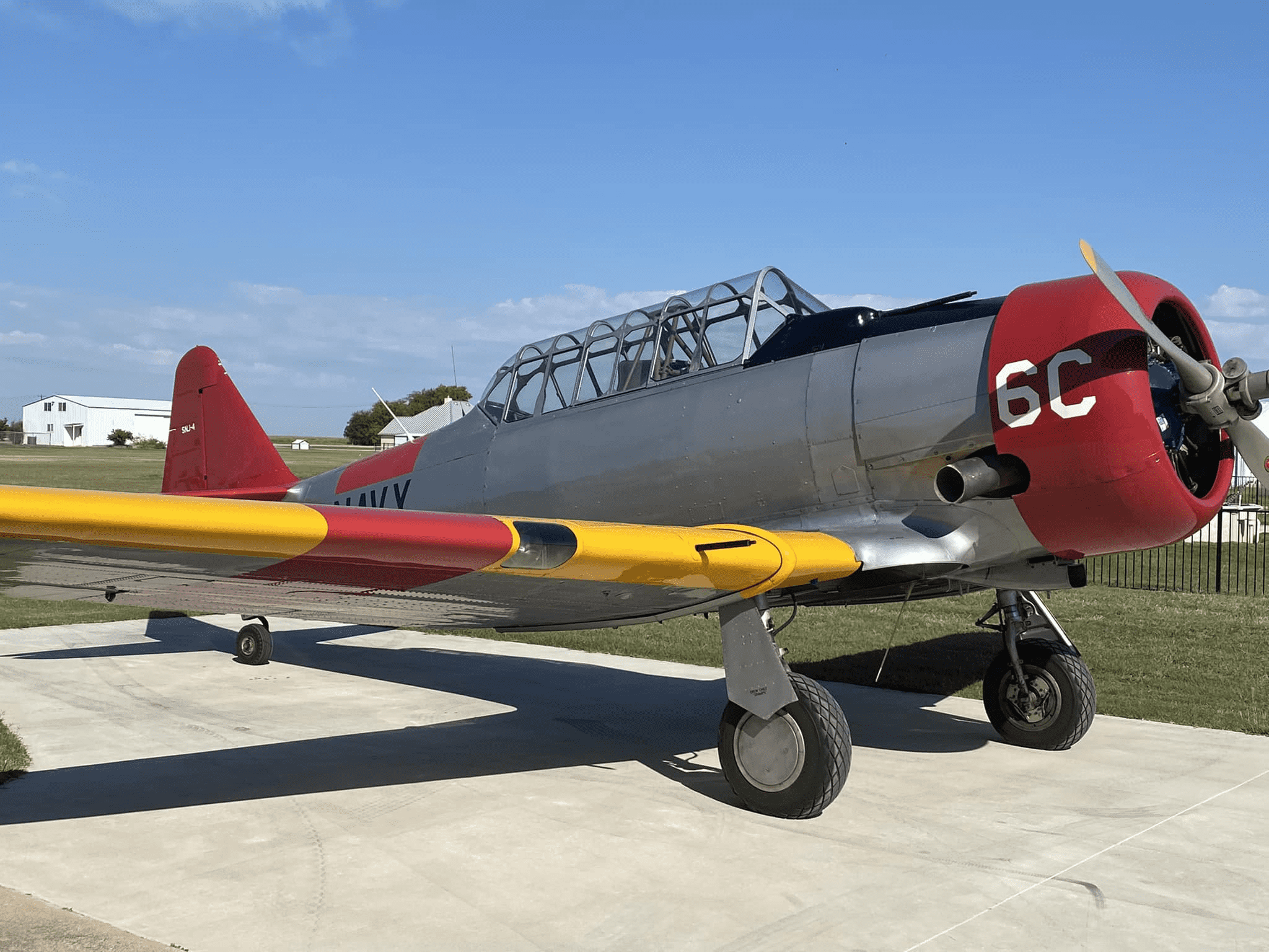

This Ole War Horse still lives their:)
