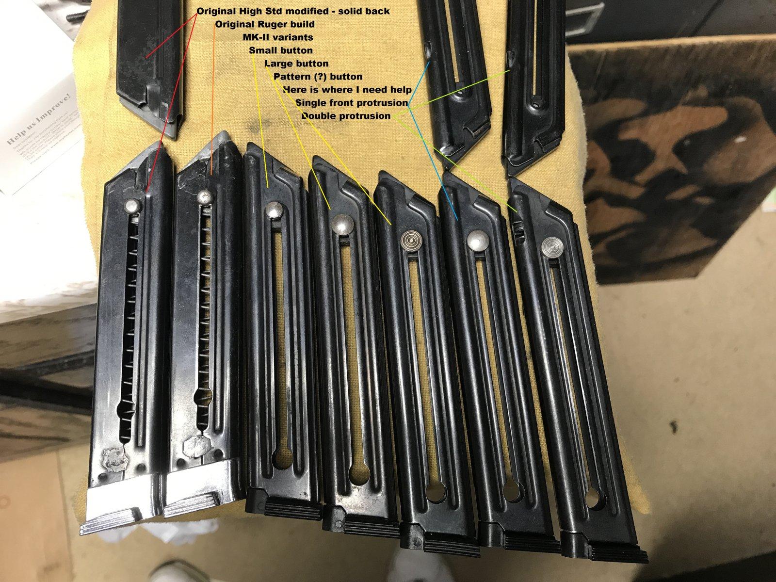

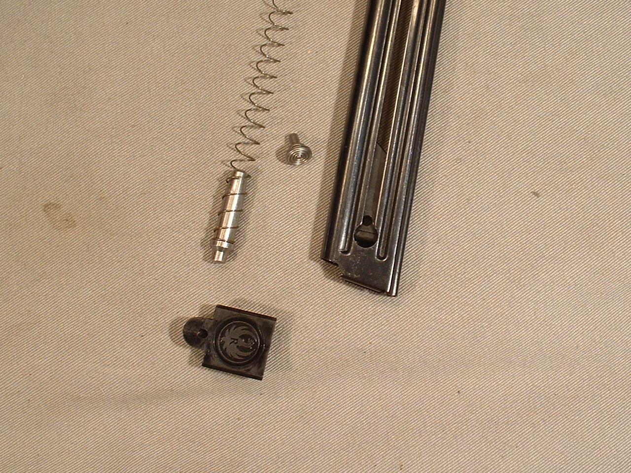

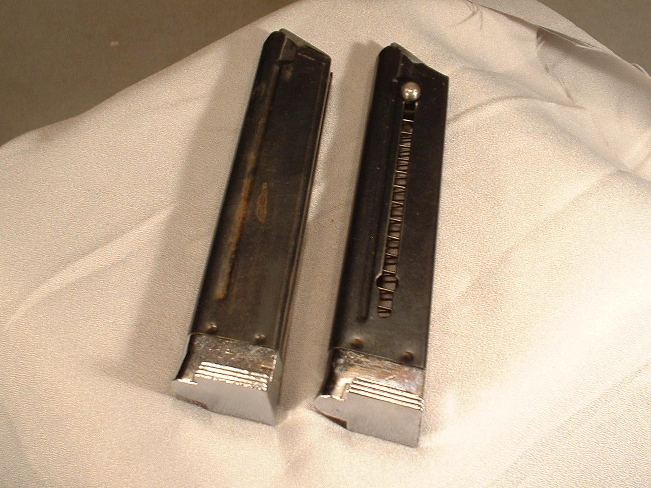

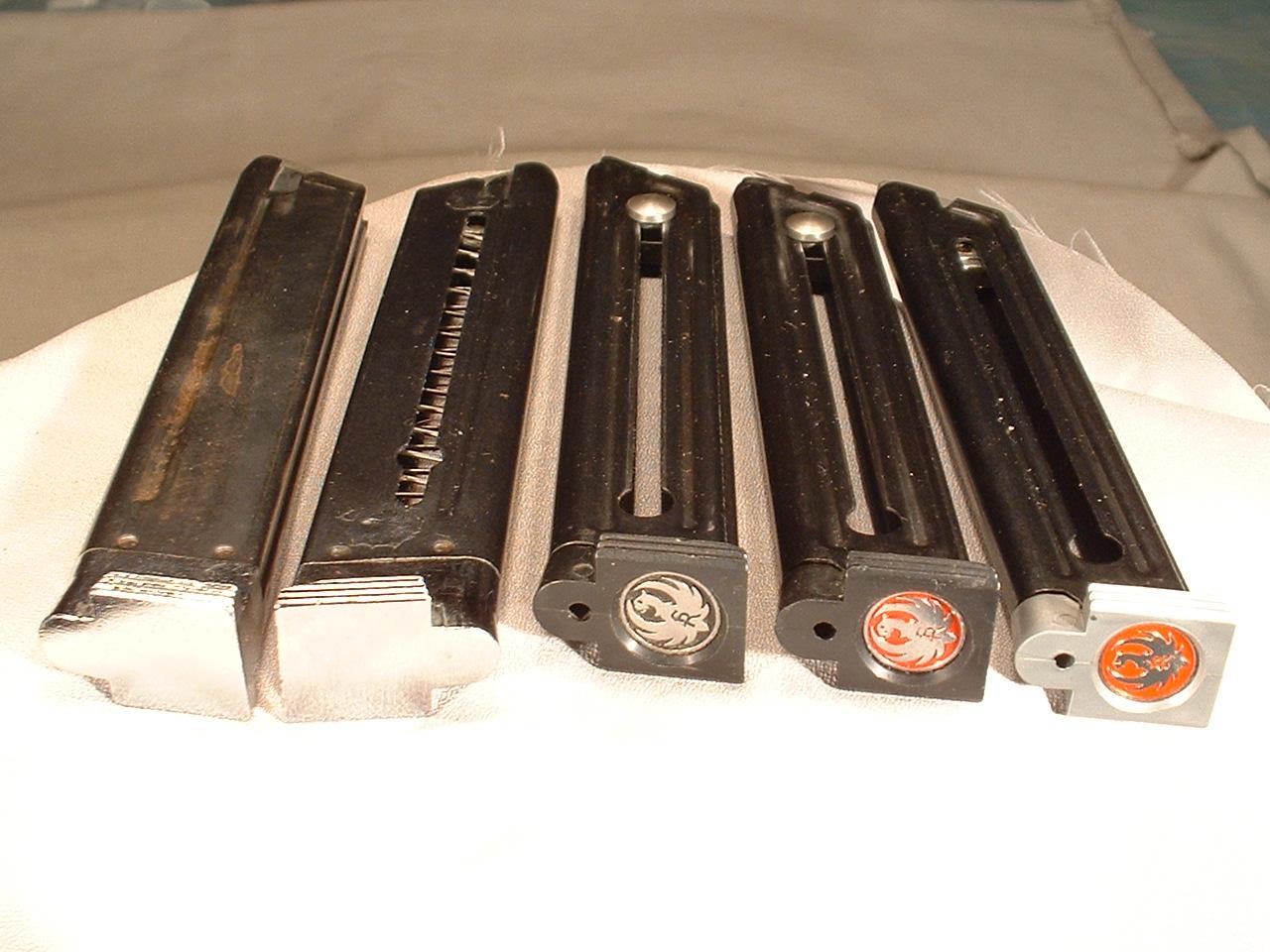

the early A-54 frames ran into the early 70's with the prefix serial numbers, and yes you can use a later double slot magazine ,simple reverse the button to the other side,,,if its a later, like the MK II magazine the button head is much larger in diameter and may drag ,cause hangups on the A-54 slot channel, need to turn it down make is a smaller diameter head on the button....a better cut off date of the exact timing ( serial number range) of the A-100 may be found in a check of the RENE and the types...to get a single slot mag, will be more costly if found at any show or on line, I've gotten $60 or more when I can get them, and seen them as high as $90 at times,,,,,use the newer ones, they hold 10 rounds instead of 9 ......:cool:;)

yes, they were, it appears the gun in question had a replacement done using the early A-54 frame , and yes you can use a later double slot magazine ,simple reverse the button to the other side,,,if its a later, like the MK II magazine the button head is much larger in diameter and may drag ,cause hangups on the A-54 slot channel, need to turn it down make is a smaller diameter head on the button..........
