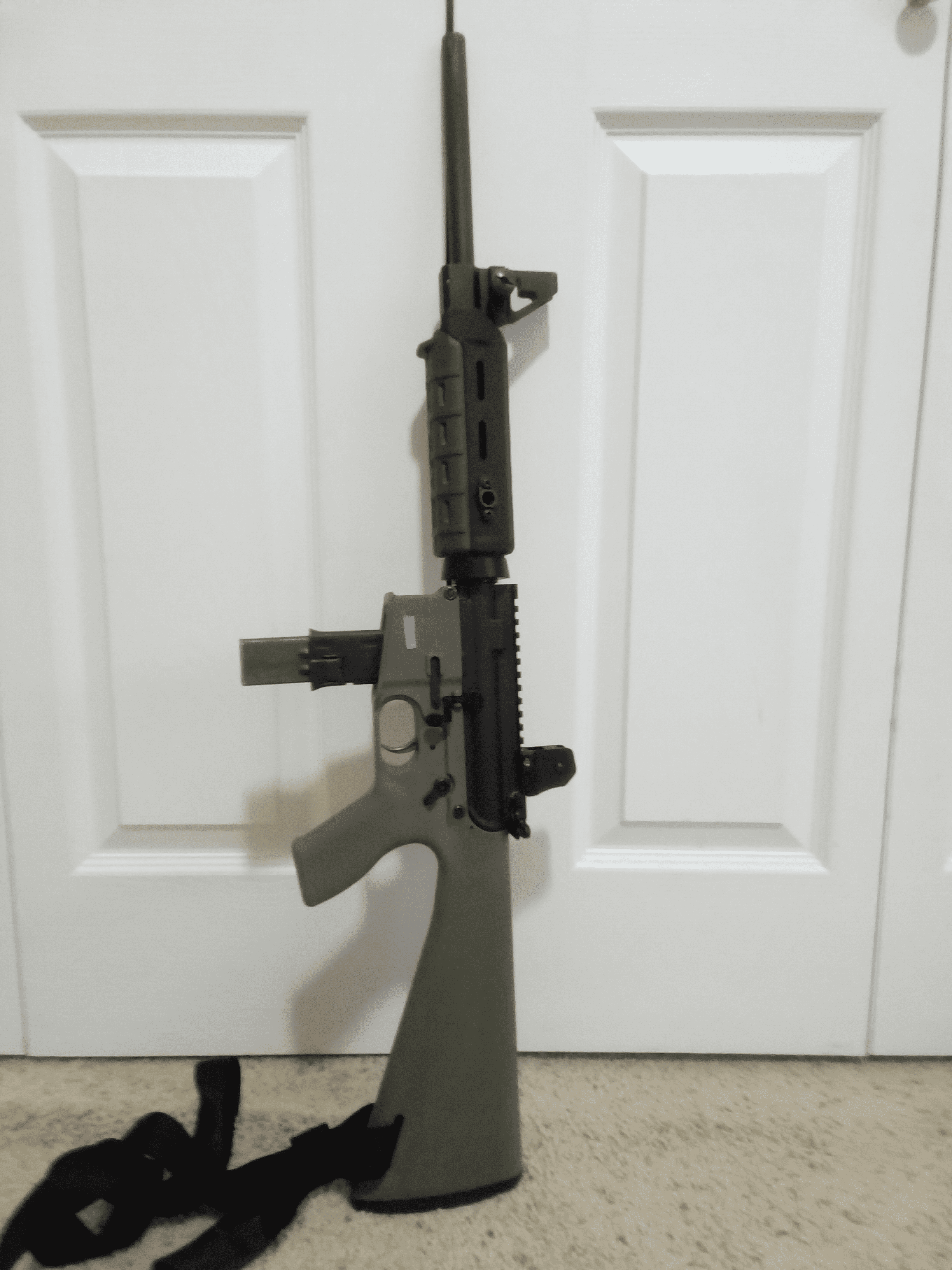

me too... I have what looks like an AR-15 rifle that shoots 9mm as well as .357 Sig with a few modifications... in fact I have both a rifle and a 'pistol" that is soon to become illegal unless some court says different... these both take Glock magazines which is my only complaint about them... but the lower and trigger on them is actually different than the AR.... The only reasons I mention this is we could have shot them this past October.... I can of course the Lord willing bring them this year.
This is just the rife showing what in about a minute you can break it down to. The pistol is the same just with a 10" barrel and non adjustable rear stock... oh, excuse me... that is actually a 'brace'.
