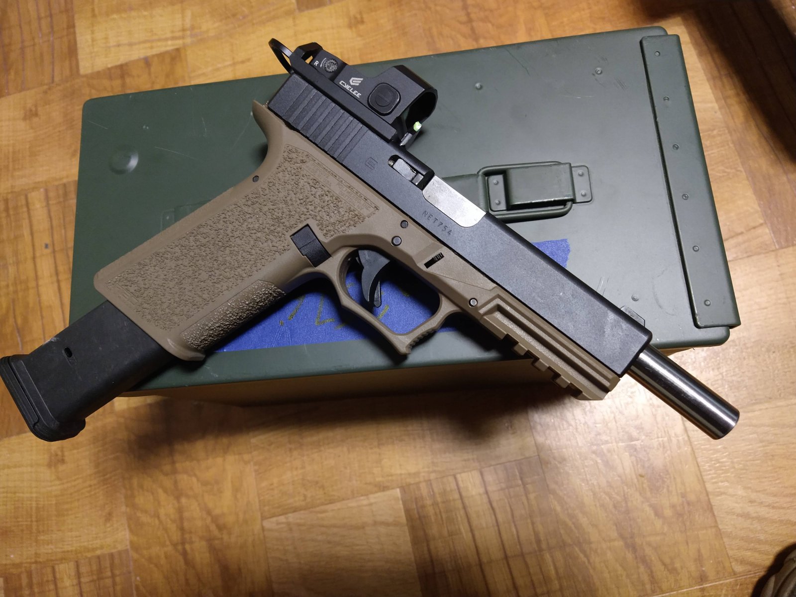

Well this experiment came to an abrupt end yesterday with a case failure.I never even got to any remotely Hot loads. After running some of my various defensive loads for accuracy(which it did lock back on all) I was going to run a few mags of my plinking loads through.
I guess my bad habit finally bit me. When I'm doing plinking loads I pretty much dump whatever range pickups I have in the case feeder and roll with it. Besides being heavily tarnished it looks like there might have been some dirt around the case mouth and possibly in the case as well.
Fortunately it was just a $60 Poly80 frame but replacing it will be more of an issue now with the current laws.
