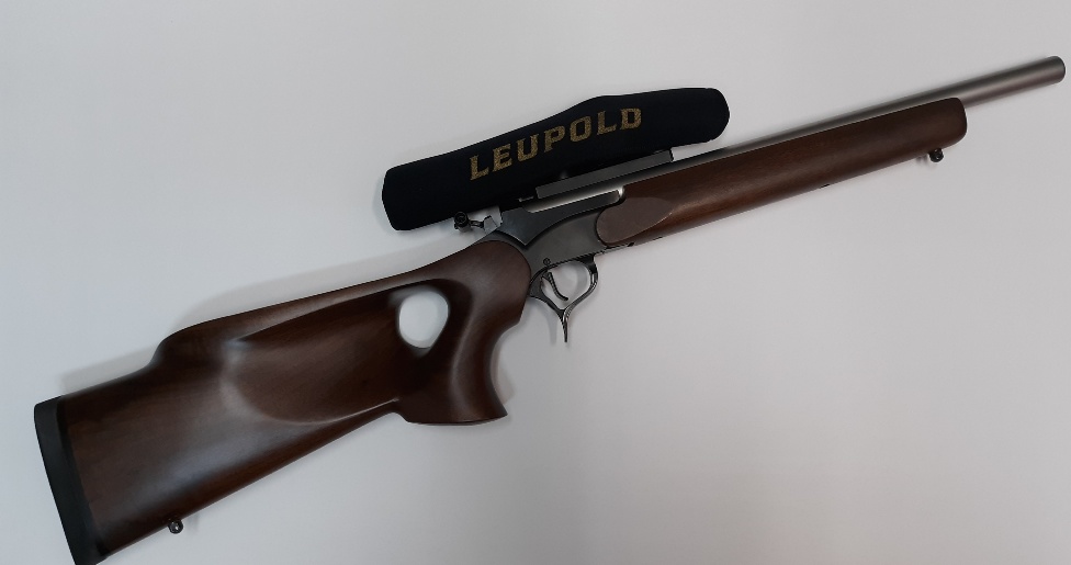

Which rifle? ; I have a Encore 357 20 inch, Rossi 20 inch and Henry 357.

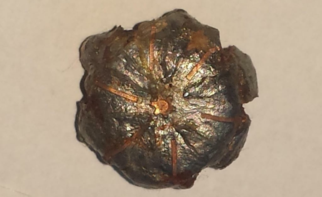

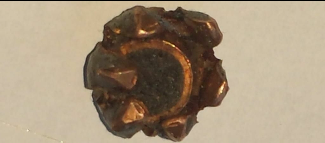

While effective I would not take it past 100 yards. And if you will be using 158gr XTP Make sure you buy the Flat Point XTP they are made for rifle velocity the standard XTP blew up on that deer. Definitely use 158-180gr bullets.
Here is a 158 grain XTP recovered from a 200# whitetail buck from a few years ago
