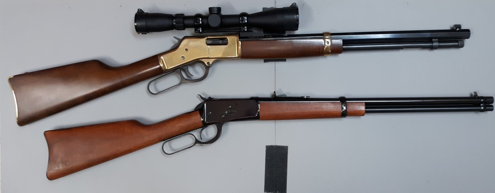

A friend of mine was seriously looking for a .357 lever action. He was waiting to see if Ruger/Marlin would release one at Shot. When that did not happen he was seriously looking at the Marlin all weather. But found a Rossi stainless locally and bought it. I think he made a good decision. Less money and not as heavy as the Henry.

Henry's aren't just heavy, they're not made to the same strength level as an 1892. Rugers are too expensive and likely won't be available in blue for a good while. 1894's are heavier and weaker than the 1892.
