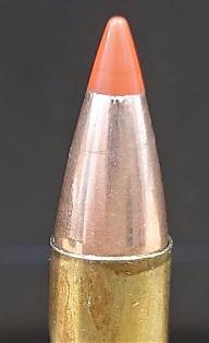

After many years I decided to reload again. I used to crank out lots of loads using straight wall cartridges for Cowboy Action shooting. I now chose a Hornady "Lock n Load" Classic for rifle cartridges.

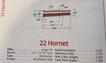

Loading the 22 Hornet for the first time, I am not sure how deep to seat the bullet. The picture shows the Hornady V-Max bullet seated in the cartridge just before the bullet cone starts. It looks a little deep to me, it measures 1.834" COL (including the plastic tip). This is still much too long based on Hornady's published COL of 1.723".
I will shoot these in a Ruger No. 3 and don't think the COL is that critical but assume that there should be some rule as to how far the bullet should be seated into to the cartridge. Can someone give me a good simple answer? Thanks so much.

1st don't shoot me. I do not know what type of action a #3 is.
Magazine fed rifles your max overall length is dictated by what will fit in the magazine.
Single shot - many start with the .010 - .020" off the rifling. An easy way to determine that measurement is to seat a bullet REALLY long in an empty unprimed case. Put it in the action and close the bolt. The bullet will contact the rifling and self seat to max depth. Remove and measure. Then subtract how far you want the bullet off the rifling and load to that depth.

The Ruger #3 is a falling block single shot, where the cartridge is loaded straight into the chamber, so seating depth is rather unimportant, other than the bullet should be seated enough to allow chambering of the cartridge so that there is no drag on the bolt when it is raised. Often seating the bullet way out, so it just contacts the lands of the rifling will give best accuracy. I have a #1, a larger heavier stocked version of the same action and that is the way I load for mine.

The Ruger #1 and discontinued #3 use the same falling block action, they are single shots have no bolt with a camming action so the cartridge must be sized and bullet seated to allow chambering so the block may be raised into firing position.

NikA has likely hit upon the answer.
The poly tips are often longer than their lead tipped counterparts. Go back to your loading manuals,, and study the bullets used. It may show a difference there.
Dan also has posted an excellent piece of advice. However,, SOMETIMES,,a bullet will get stuck in the rifling, and not extract with the case. A (formerly) Stoney Point (now Hornady) tool allows for the checking of OAL of a chambered round & a particular bullet. Cerrosafe casting of a chamber can also tell you where the rifling starts in a chamber,, to allow seating depths to be adjusted.
But you can try a few rounds like shown,, and see how they feed. Then,, seat them out about .010 further out,, and try that. If that's good,, you can continue to seat the bullets out in ten thousands increments, until you get a round that won't allow the correct seating & action closing.
Deeper seating can increase chamber pressures,, while shallower seating can decrease chamber pressures.
Since you are using a single-shot,, I doubt you'll have any issues seating the bullet out a bit,, or "long" according to the charts. I'd just make sure you get a firm hold on the bullet once your crimp is applied.
Also,, a polite call to Hornady may get you some excellent information.

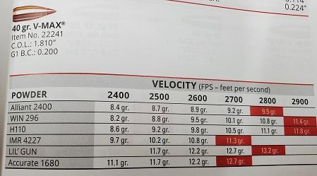

I have an older (9th edition) Hornady manual and it specifies the COL for several different weight V-MAX bullets for the 22 Hornet. Some are 1.810" and some are 1.830". The COL for NON v-max is absolutely different in my manual. It appears that you are referencing the wrong measurement for your V-MAX bullets.

@Johnnu2 You are correct, I only looked at page 144 of the current Hornady manual. I should have looked at Page 145 where my 40 gr V-Max detail is.
Thanks for pointing that out.
It appears that I can stay at or around 1.81" COL and be fine. As I am running a single shot, I assume I can be more flexible with length if I choose. I suppose the first range visit will give me more insight.
