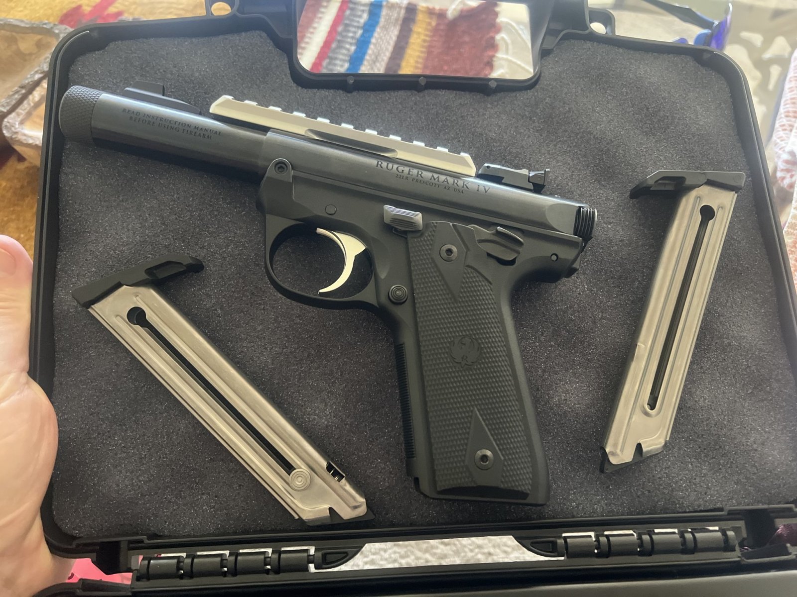

I had a recent jamming issue with the Ruger Mark IV. I had a clean pistol btw.
I had two different types of .22 rounds, Remington and Winchester. I separated them out and realized that the Winchester from the white box was the culprit. I had no jamming w the Remington rounds.
Are there any other Ammo types to steer clear from with the Ruger Mark IV? I hear CCI are very good
Thanks in advance

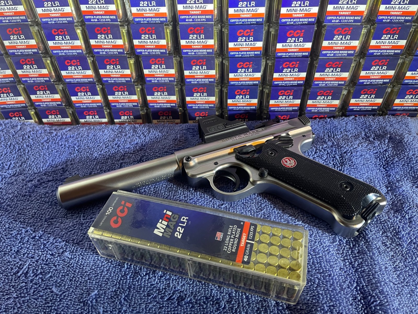

Just finished at the range. Tried three types of cci ammo
Standard velocity 40gr had 5/100 misfires
Mini mag 36 gr 1/100 misfires
Mini mag 40 gr 0/100 misfires
The larger powder charge in the mini-mag seemed to “power” the process more reliably than the lower velocity (1235fps vs 1070fps) in not only unpolished chambers, but also in a “less clean” firearm. Like I said earlier, polishing the chamber solved it all.
For me, the mini-mags function well even in a filthy firearm…at least to a point…lol.
