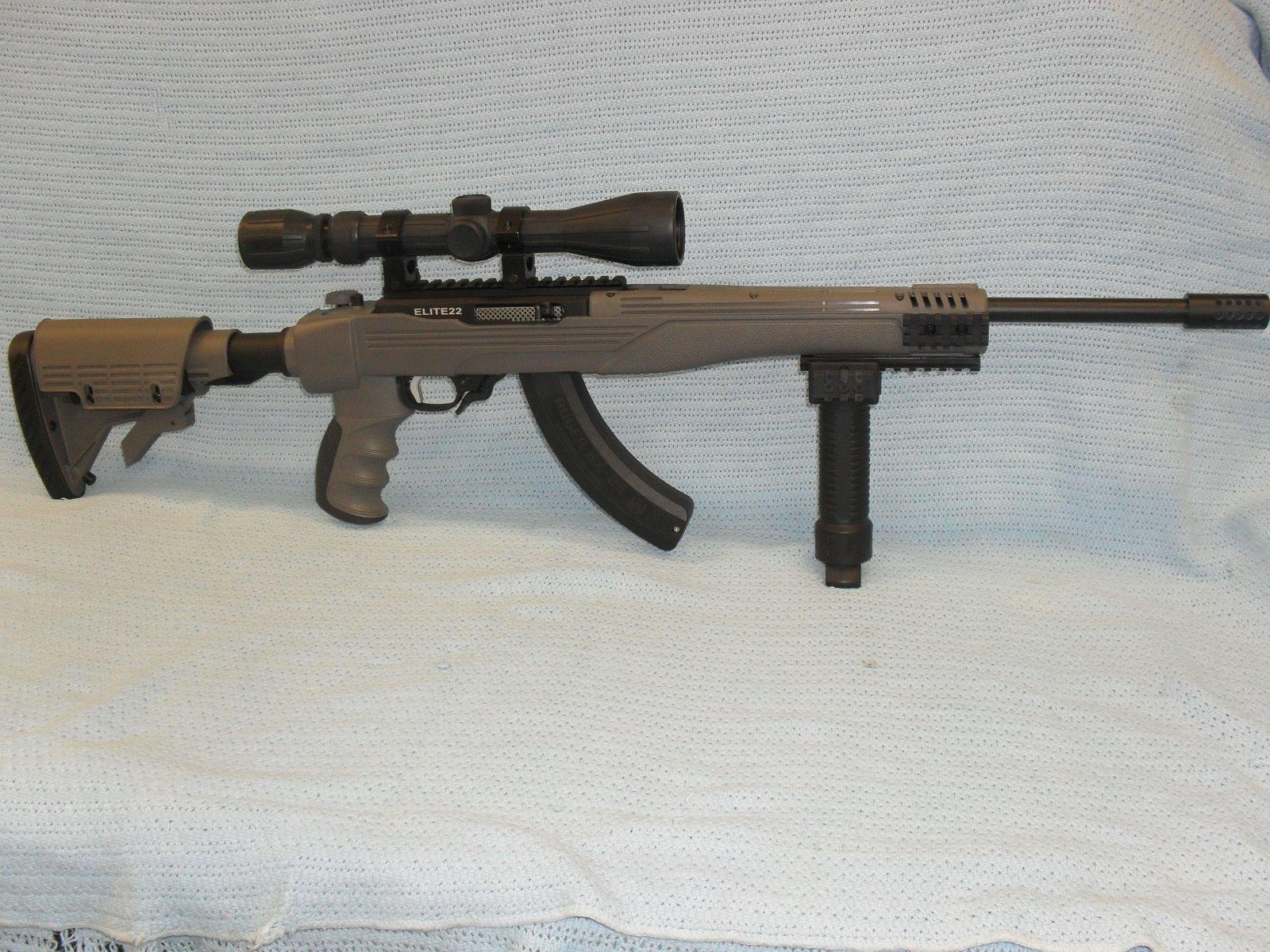

I have Kidd, VQ, and Tactical Innovations, receivers & none of them shoot any better than an original Ruger one.
BUT, they sure look cool!!! :cool:
Cheers,
JAYDAWG
    359.3 KB
