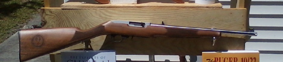

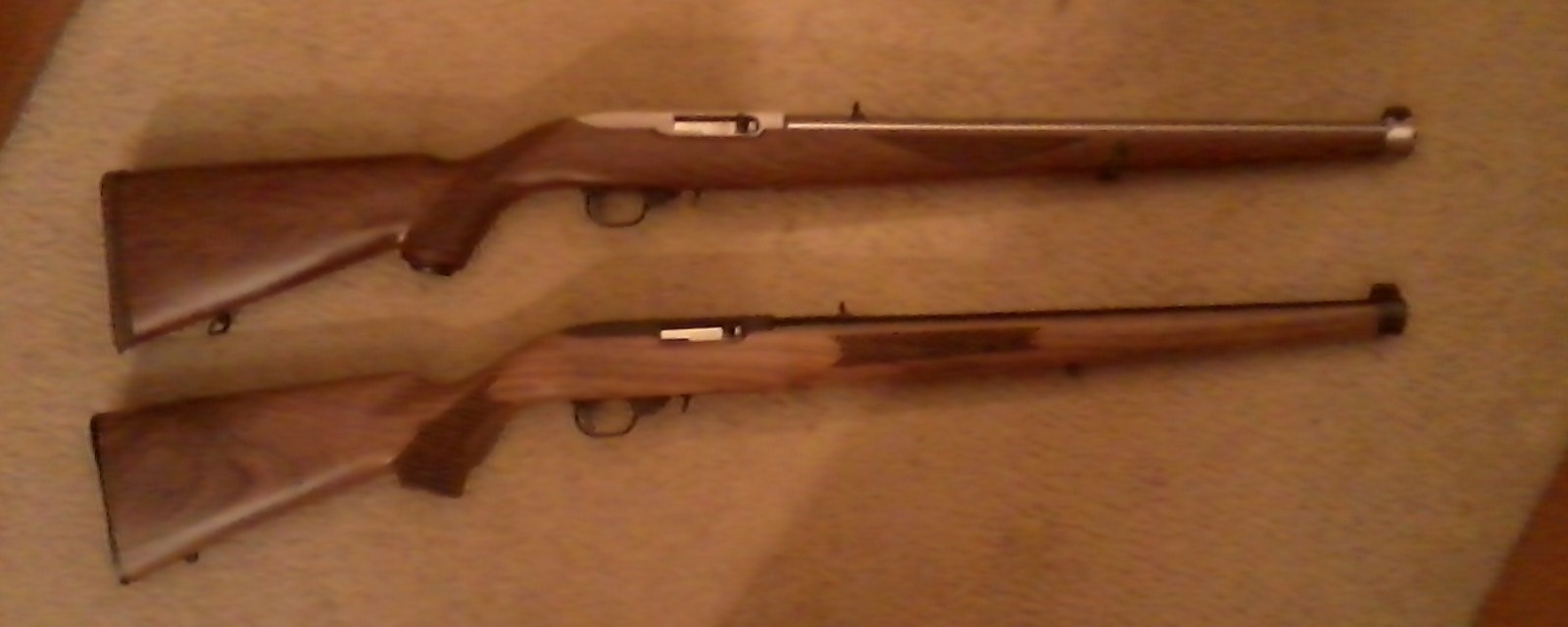

I have used BX triggers on several of my 10-22's with great results. I have 2 International pattern rifles and 2 short 16" barrel straight grip stock carbines that I have built. All 4 are fantastic firearms and are a pleasure to shoot.
The short carbines are a special favorite of mine. They shoulder perfectly and line up fast with the TruGlo sights on them.
The Internationals have a feeling that makes them comfortable to carry and use.
Both styles are best used with the original 10 round rotary magazine. The BX25 makes them look awkward and ungainly.
