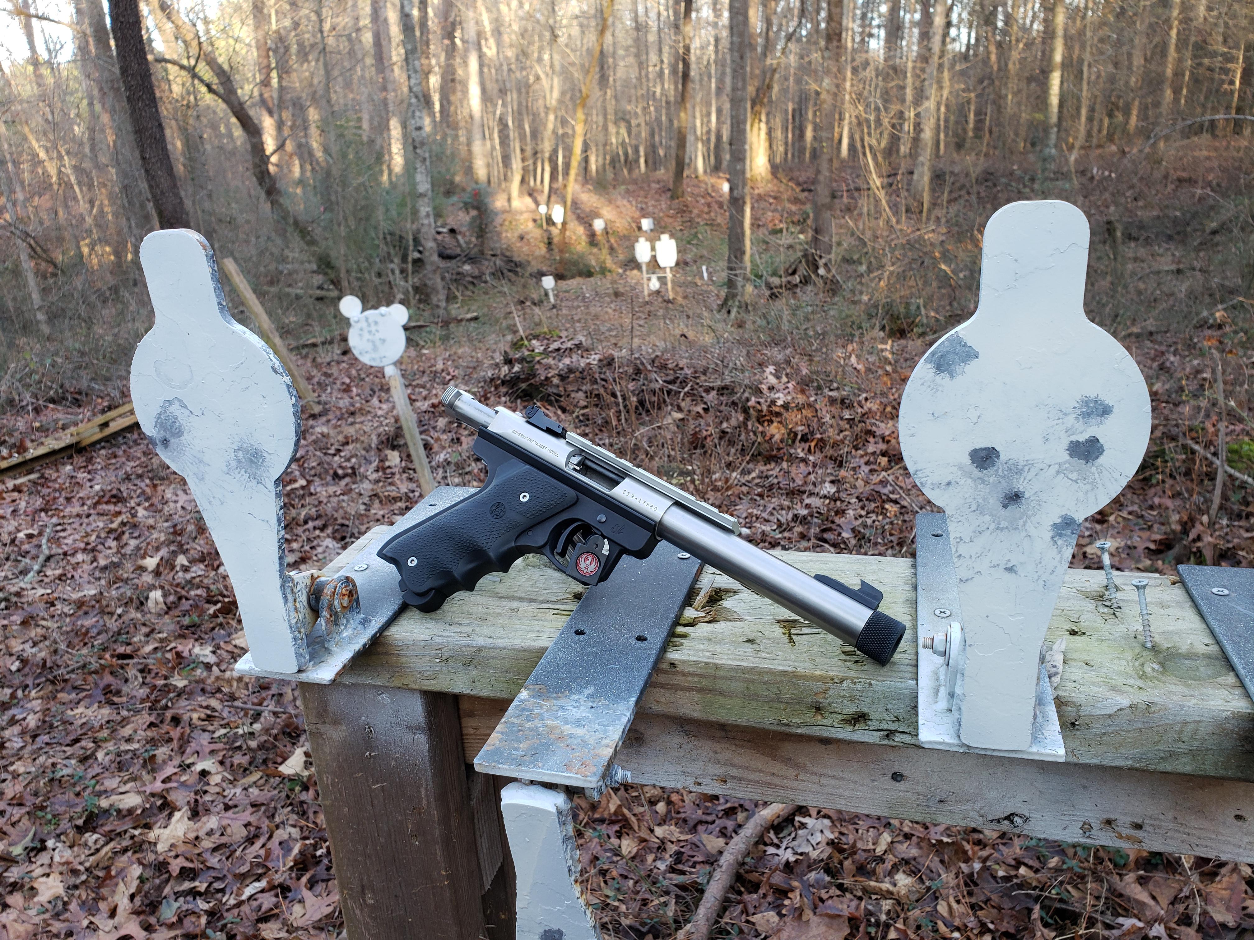

You asked about changes. Depends on what you need to accomplish your shooting goals. This started out as just a KMK678G. I did a lot of shooting at a local range at a plate rack with small animal silhouettes at 50 yards. The smallest one was about 2 or 3 inches. I added a VQ lightweight lower. Had a friend of mine who owns a gun shop cut and thread the barrel. There's usually a comp on it. Added a scope rail for when I finally can't see my irons well. Luckily at 65 with my contacts I still shoot irons. Will a two hand hold I could hit the smaller target 7 or 8 times out of a mag. The VQ lower took weight off of the gun and the light trigger allowes less movement of the barrel when shooting. None of it was cheap. Probably have $1000 to $1200 in the gun. But it does everything I need a pistol to do. Off a bag at 35 yds it'll put 10 shots you can cover with a nickel. I have VQ and Clark guns but this is my go to gun. Luckily I live in the woods. Pic is range in my back yard. So I practice a lot. My go to ammo is Blazer .22lr.

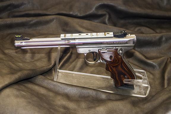

    57.3 KB
