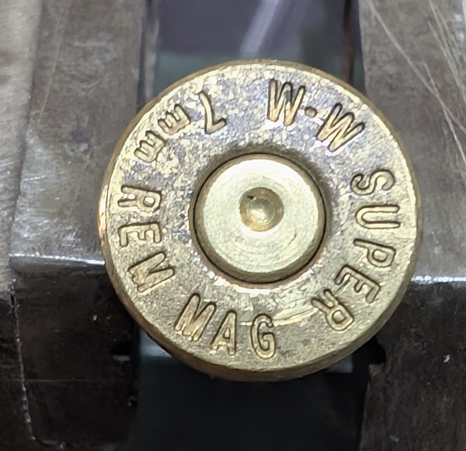

Need to see base of fired round especially the primer. Look for striations on body of fired brass.

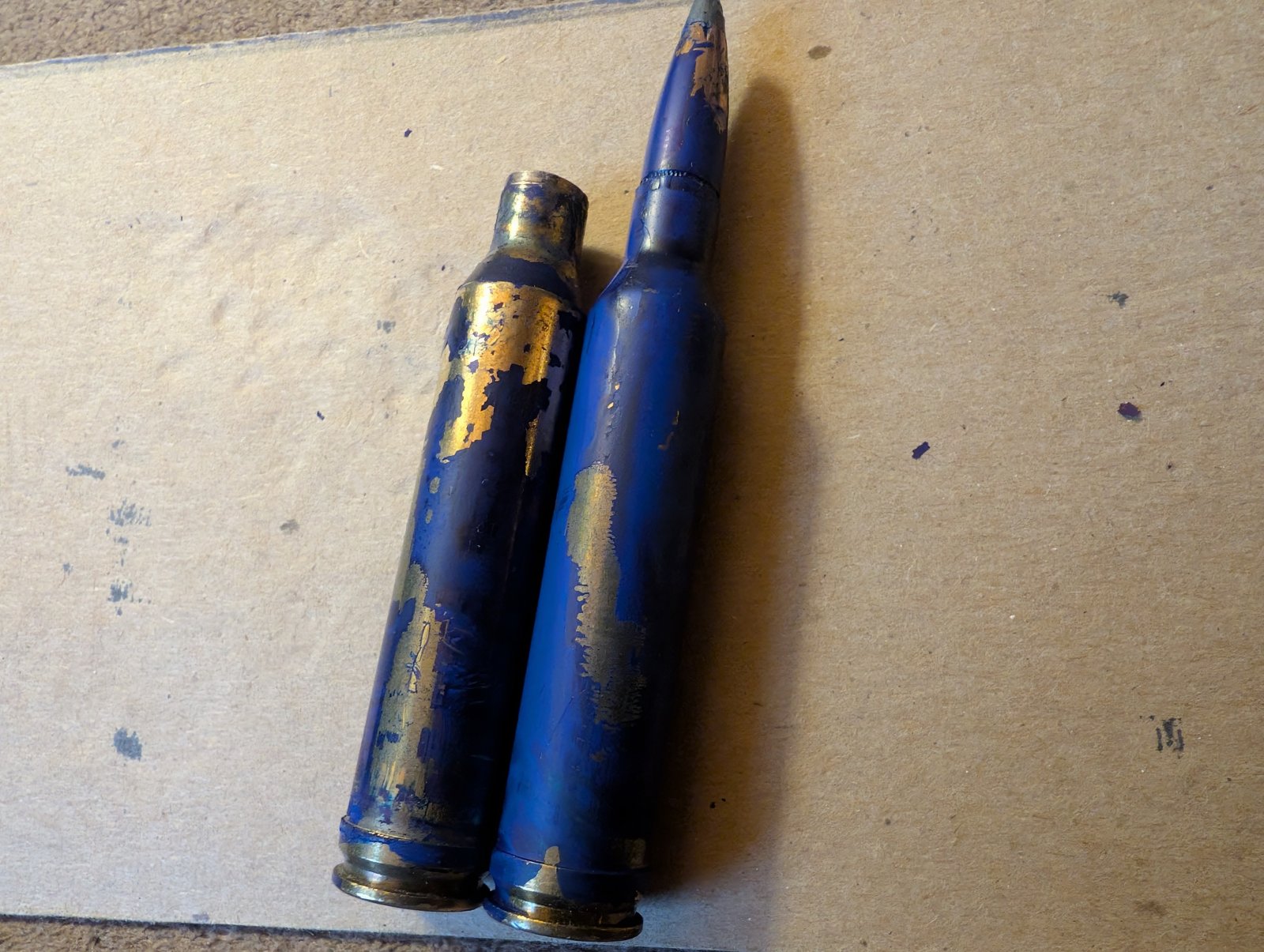

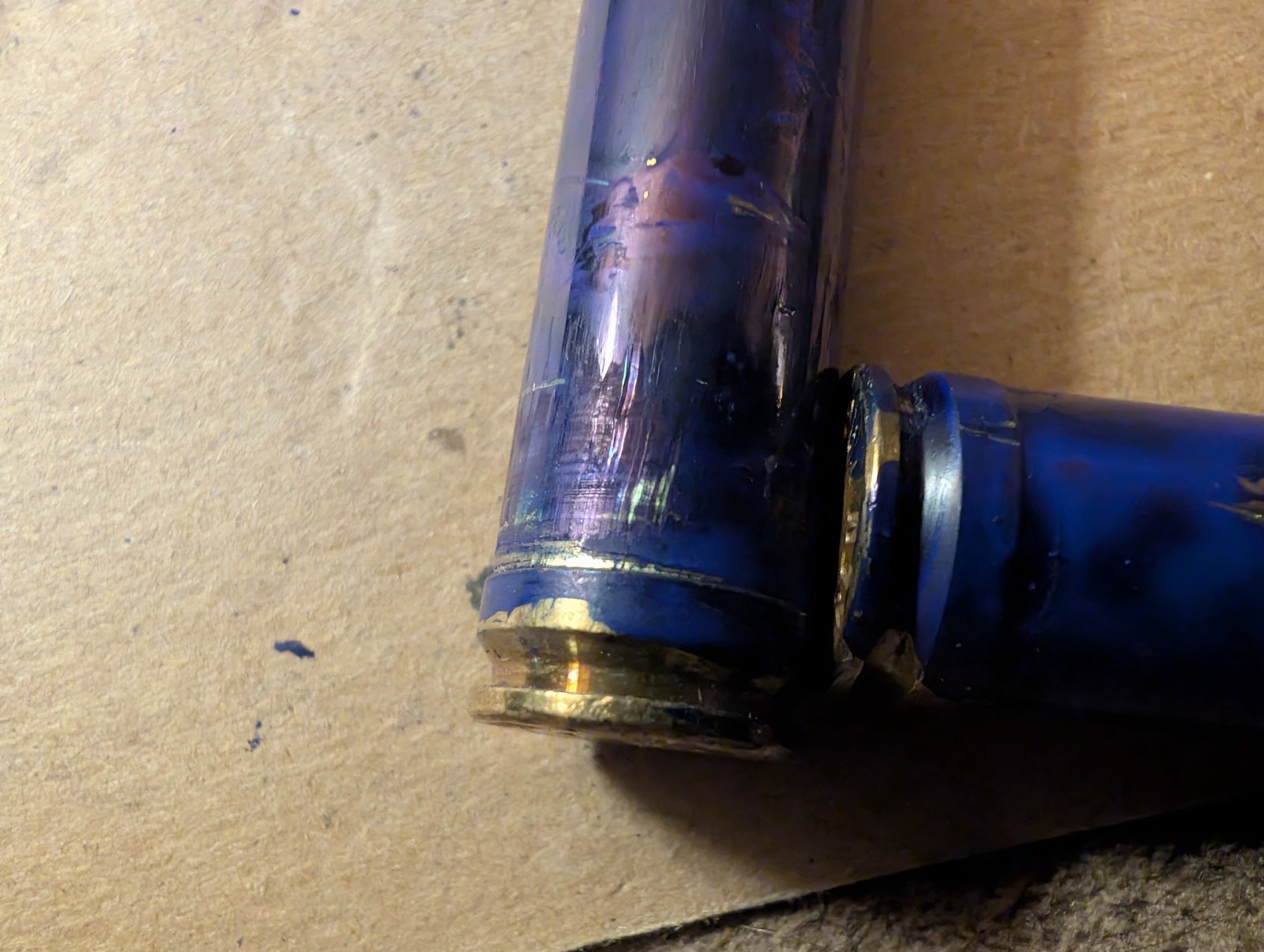

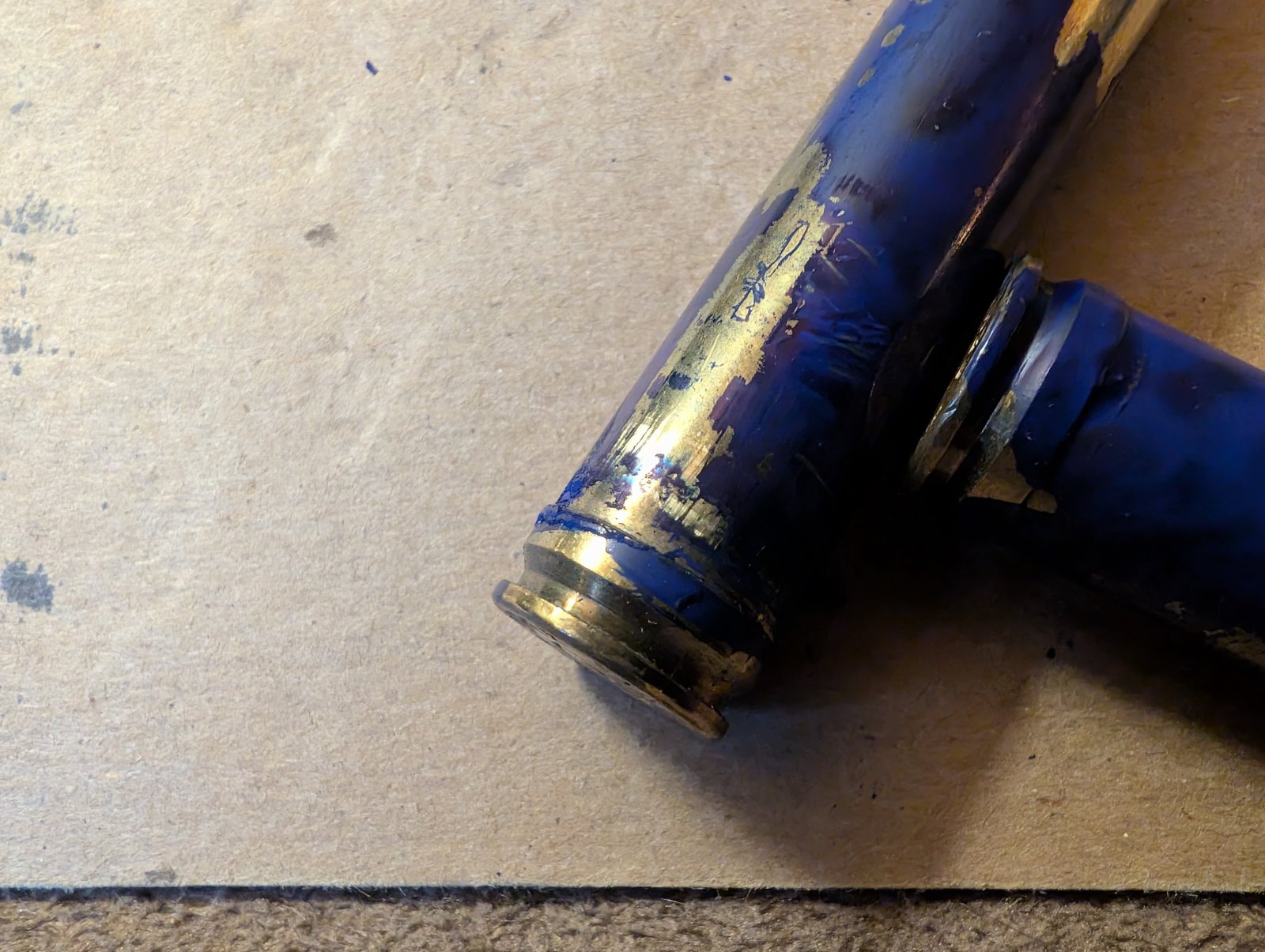

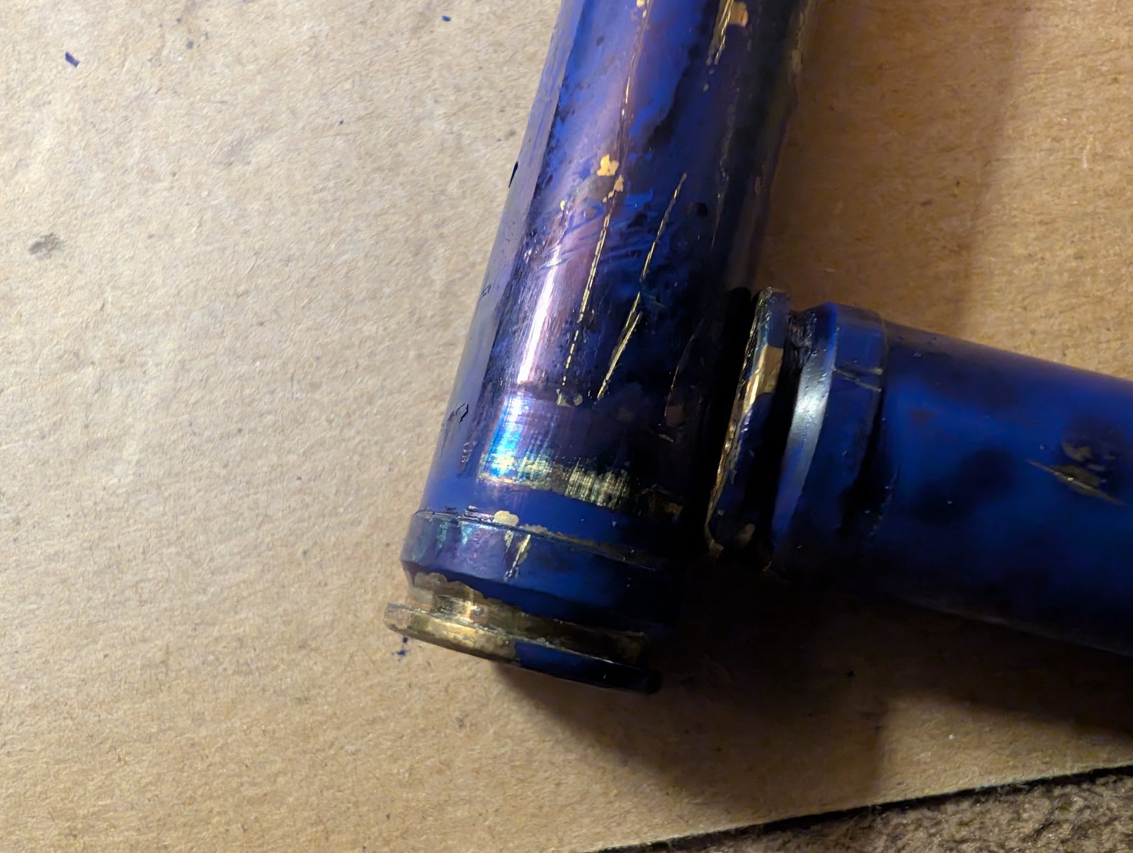

Here are the pictures of the unfired case & a fired case with layout dye. There were some scratches from feeding out of the hinged plate mag of course. Also you can see some places where the dye rubbed off. The worst looking areas I saw were forward of the belt of the fired case.
It is a 7mm Rem mag & correct ammo. The fired case extracted with the bolt by tapping the handle with a rubber mallet. It would not open by hand. I cleaned the bore and chamber very well & could see no marred places in the chamber, just smooth and shiny.
The case measurements are listed (unfired / fired)
Belt - .5275 / .5285
Fwd of belt - .5070 / .5095
Body just before shoulder - .4835 / .4915
Neck below the crimp .3065 / .3145
Primer was normal, no signs of overpressure.

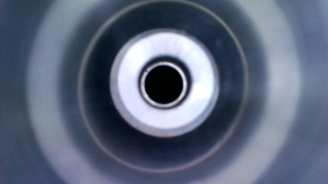

Borescope is needed. 1 is chamber to rifling photo. The other was a nice shinny clean bore until the scope looked. Will look up from better chamber photos I have stored somewhere.

The 'layout dye' could have affected the opening of the bolt by sort of 'gluing' the case to the chamber but you did confirm that the extractor will pull the case from the chamber. This is different than the comments from the owner that NONE of the fired cases were extracted and ALL required knocking out with a rod.
You might try fitting a round into the bolt face and gently feeding it into the chamber. This would reduce the scraping/scarring resulting from feeding from the magazine.

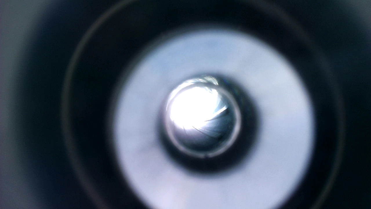

None, I confirmed in an earlier post that it is a 7mm Rem Mag & using correct ammo. I don't have a true bore scope, it's an inspection camera. I will post some shots of the chamber shortly.

Here are the shots I got, they're not great but they are the best I could get. The last 2 look odd because I had a bore light at the muzzle. It looks like you can see the rifling around the outer edge of the end of the chamber.

Likely a rough chamber just ahead of the belt. But, the rifle could have a tight bore that's raising pressure.

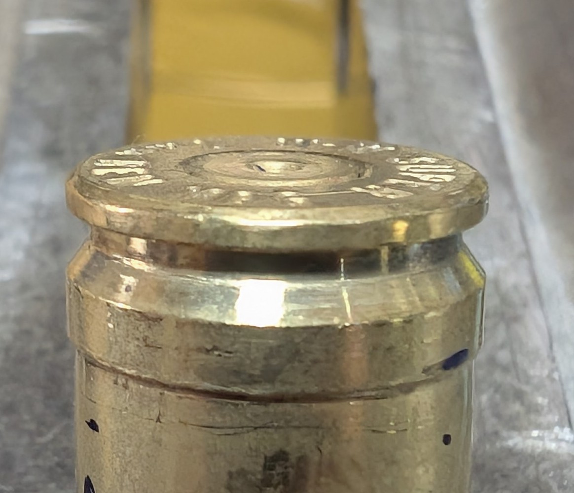

A peek at the primer that's still in a fired case might be a clue.
Primer looks fine, no indicators of too hi pressure, so that kills the tight bore theory.
Judging from the fired case it looks like the chamber has a rough spot just in front of the belt.
