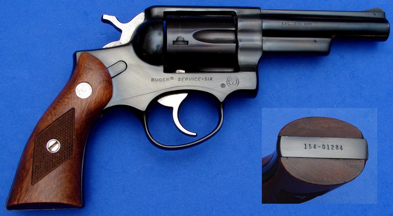

My non "police" Service Six is in .380 Rim. Some question at this point if it was really a Bolivian contract or for some other agency. Some newly uncovered Ruger records are pointing to the Bolivian guns being in .357 Mag. The plot thickens. Skeeter could have helped with the Bolivian contract and then been gifted a special model from an overrun of another, different contract.

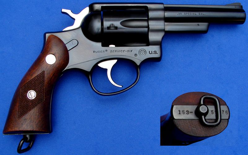

Hey Terry, I just stumbled onto this old post as a "similar thread" to a newer one I was looking at.
In addition to Vogel's "Service Six" marked .380 Rim, I also have a U.S. marked SDA84L "Service Six" .38 Special that was also from Vogel's collection.
Here are both of those guns:
That may have been a prototype that was rejected in favor of marking them SDA84L as most U.S. marked models were
Note there is no lanyard ring on that one, same as Terry T's gun. Possibly more rejected prototypes since most of the .380 Rim guns have the ring. Or at least the later guns in the 16x prefix did, but those were for India.
I suspect Steve hung onto those two because they were pretty unique.
