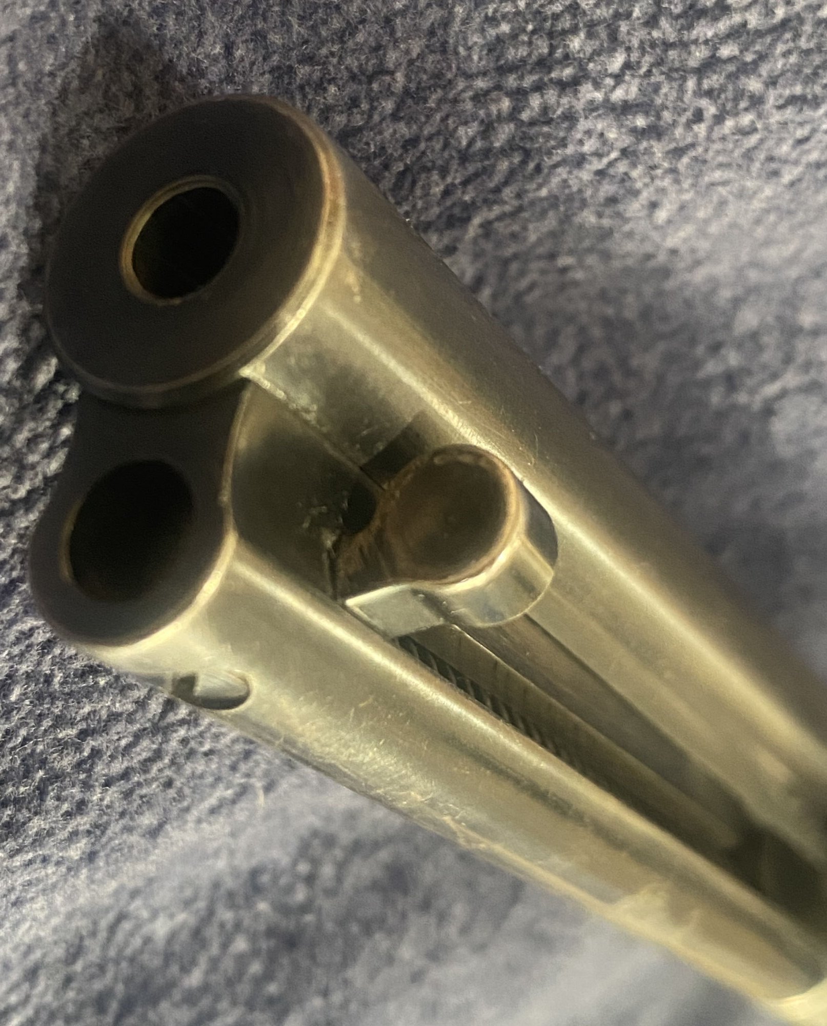

Hello All,
(This is my first post, so be patient....;-)

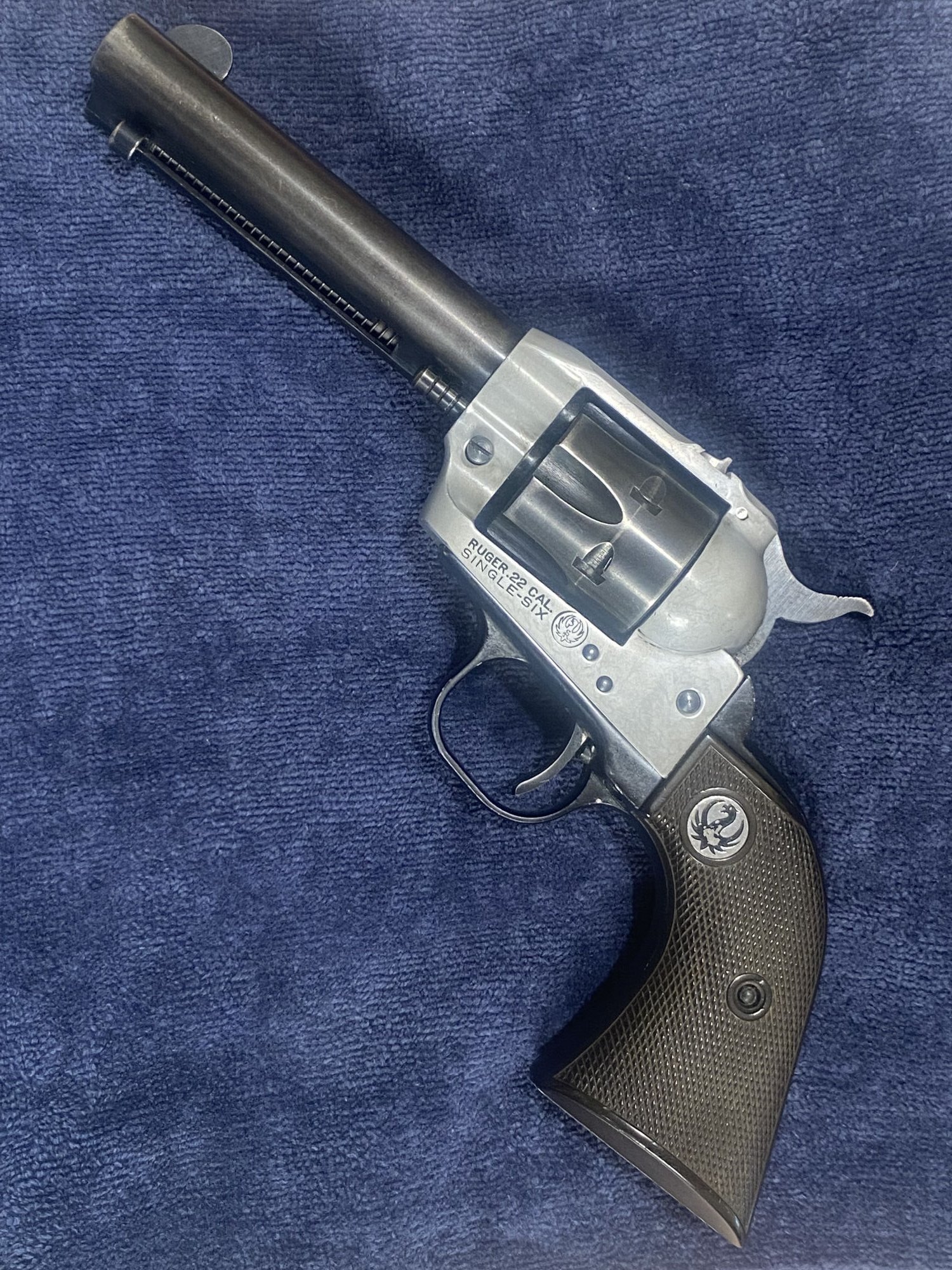

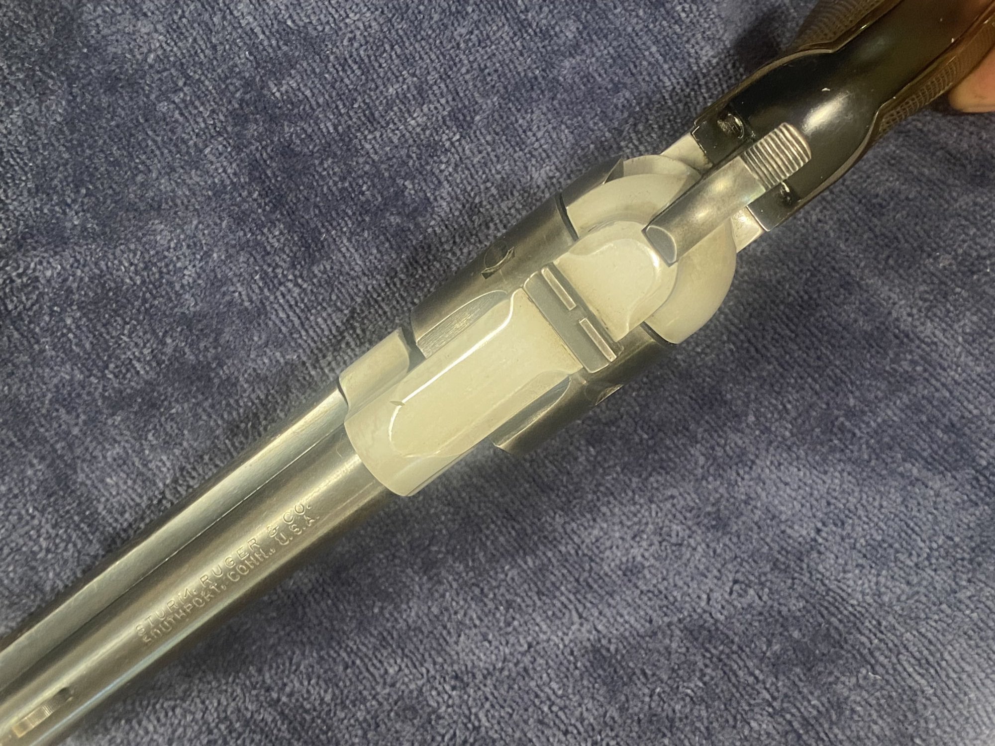

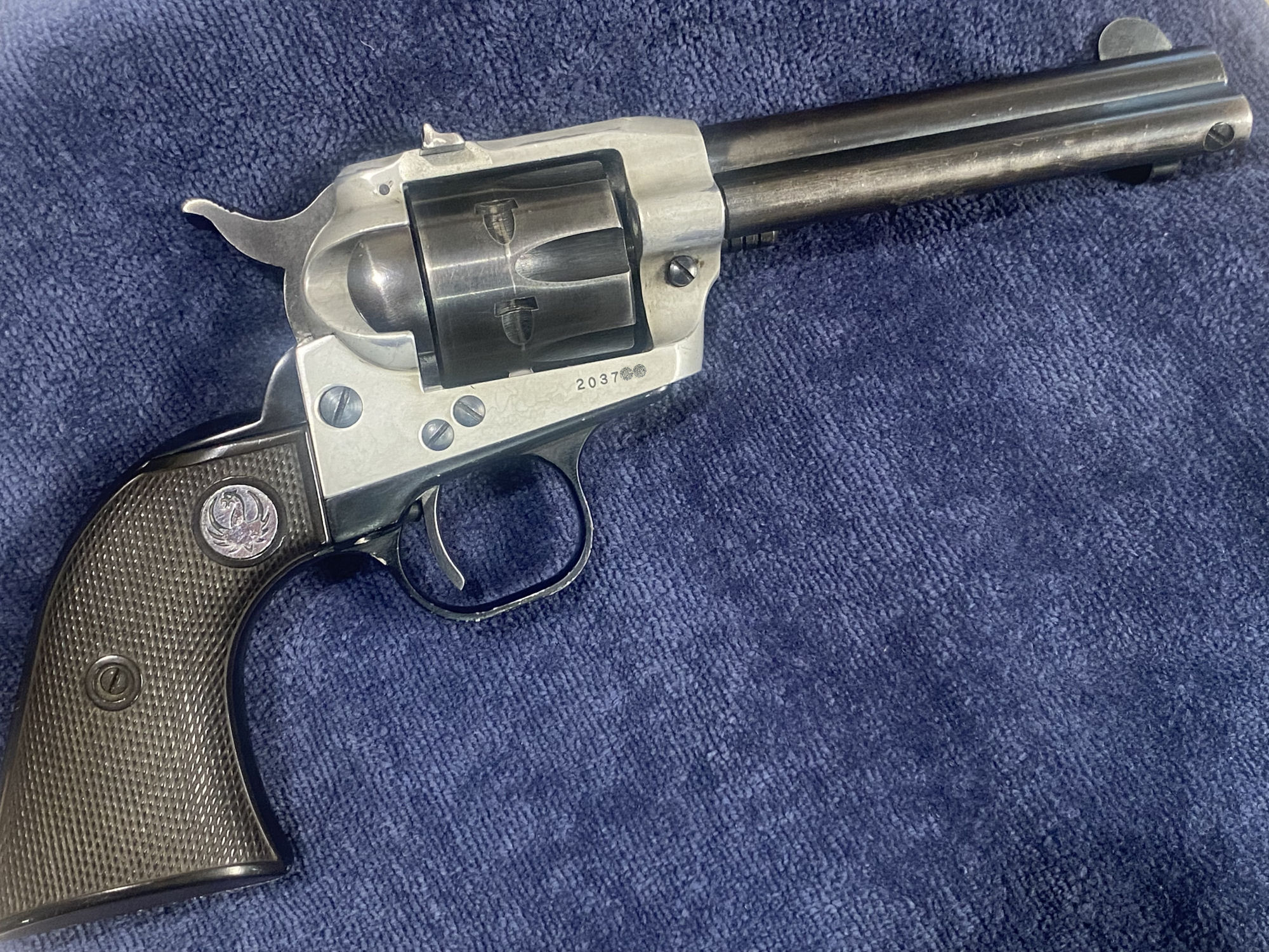

I have just purchased this lovely little Tri-color Lightweight Model revolver and it is in very nice condition; pretty much unmarked.
It doesn't seem to fit into any particular variation of the LWAC or LWSC's, so I was hoping to learn more about it.
Some details:
Serial is 2037xx, which I think puts it into the Variation 1 range.
Weight is 27oz and the cylinder looks to be steel, which I understood are normally in the fifth variation (LWSC)
(Obviously another cylinder could have been fitted at some stage.)
Contoured loading gate, very dark chocolate XR3 grips, anodised black trigger guard, round dimpled rod thumb piece.
Apart from serial number and scrolling on the top of barrel, there are no other marks.
(Not stamped anywhere with an 'S').
Any thoughts?

I believe that you are correct that someone has replaced the cylinder and loading gate, possibly other parts as well. Hang tight someone else more knowledgeable will be along shortly and sort out any other issues and recommendations for getting it back to original.
Welcome to the Forum!
Depending upon the last 2 digits of the serial number, that gun is either very late 1956 or very early 1957. In 1956,, the numbers ended in 203786 & in 1957 they started with 203787.
You are correct in that it should have an alloy cylinder, a small serrated ER button, and a flat loading gate.
HOWEVER,, there were some of them that WERE shipped with the concave ER button,, but still having a flat loading gate. The earliest known variation like that has a serial number of 203597. We call this the "parts bin" assy. As an assembler got low on parts,, they would get a bunch more,, and often, older ones would be on the bottom of the bin, and not used up immediately. This variation went to # 205250.
I would venture a guess that either someone wanted an all steel cylinder & a contoured gate & very possibly a round button at some point & swapped out the parts. Due to the values of a Lightweight,, I'd doubt someone would salvage parts off it to make another gun into something else.
Getting the original parts for the loading gate & the ER,, are much easier than finding an alloy cylinder. Those are VERY hard to find.
The grip frame on your gun appears correct.

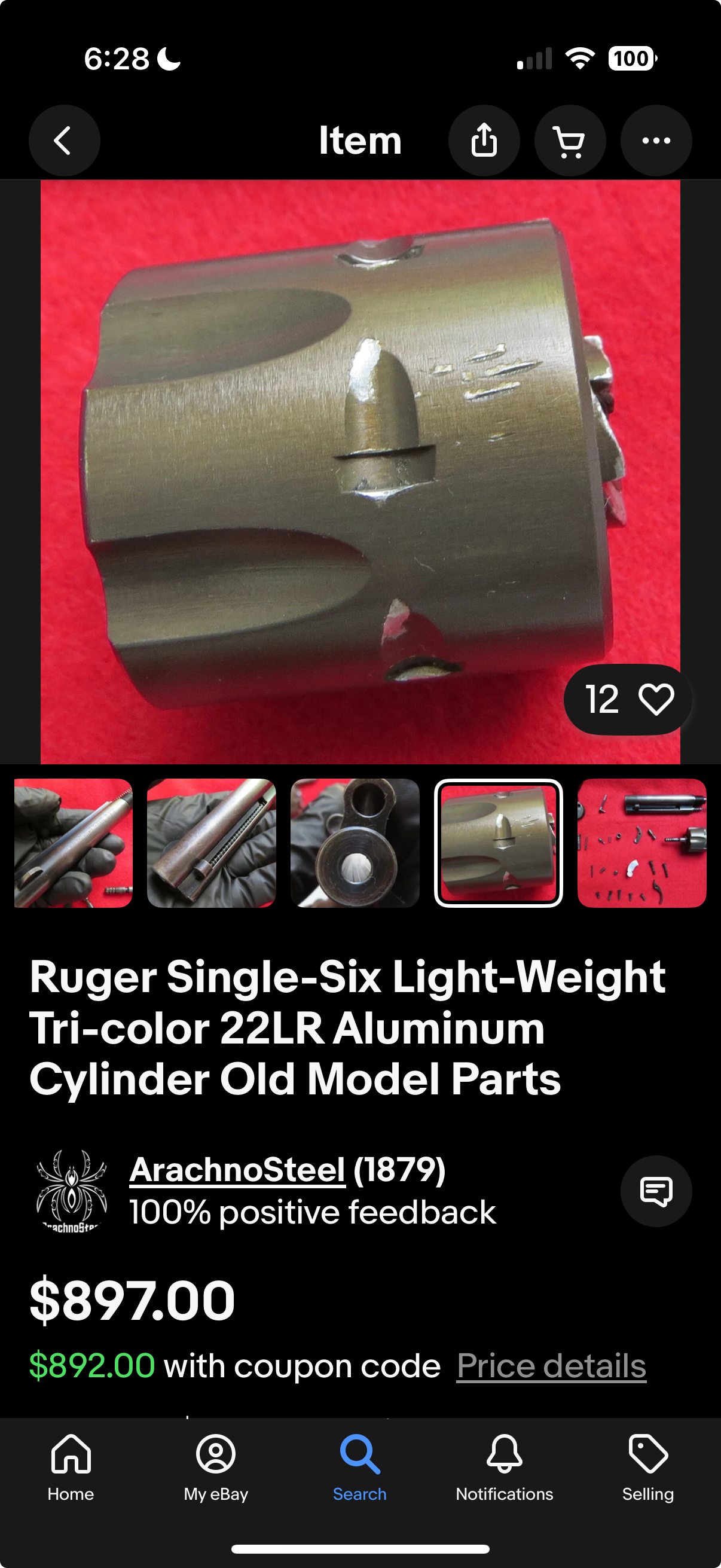

Well, you may not know where the gun was when the parts were swapped out. I'm SURE you'll have a hard time over there finding the correct parts.
But,, there is always places like "sleezbay!" You never know!
Yeah,, but look at the price he wants. However,, it does have the complete ejector parts he needs as well, INCLUDING the flat loading gate. The other parts,, could be possibly resold.
If I had a Lightweight that needed all those parts,, I'd consider contacting the seller & seeing if I could work out a deal.

Well from the standpoint of it being a shooter, not a collectible, it's got all the good parts; full loading gate, the decent size ejector button, the shorter (front to back) early style XR3 grip frame, and the steel cylinder. The only improvement for a lightweight, and to compensate a little for the heavier steel cylinder would be to replace the steel ejector rod housing with the later alum alloy housing.
