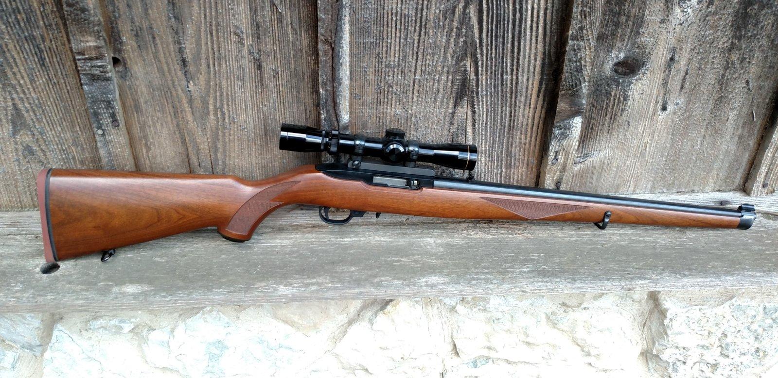

I had a similar setup many years ago. I used to be into custom 10/22’s. The huge scope was amazing on a built 10/22. Aspirin tablets at 50 yards, penny’s at 100, and golf balls at way further than that. Here’s a pic from the way-back machine- I think this was the early 90’s.

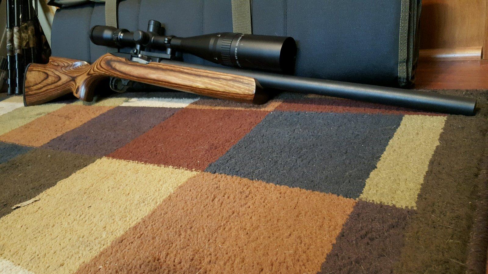

This is a 6.5-20, & the gun might wind up with a 36X on it, but it's only shot off a bi-pod. My sporter weight 10/22AW has a 2-7 compact on it & I was hesitant that it might screw up the handling. But it's good to go.

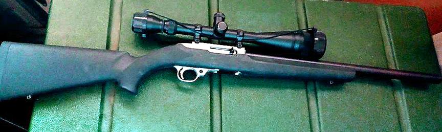

Buy it. Ruger 10-22s are surprisingly accurate. This group was only shot at 25 yards but only balanced on the front rest. Wish I had a rear bag with me to see what it could really do.
Scope is a Simmons 8 X 34 AO. Not the best glass but it sure makes this gun rock.
