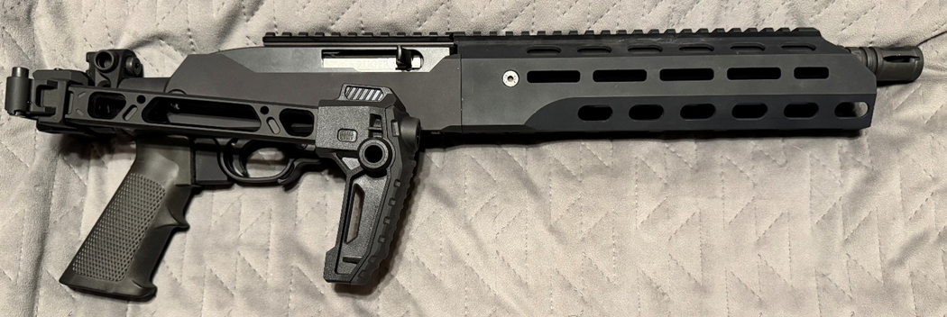

From my been there done that file.... I picked up a new Ruger Charger 22 five years back and have been tinkering with it and enjoying it thoroughly. In stock form I was lucky to get +-1.25" groups at 50 yards. Doing my research I followed the advice of the Forum Guru's and upgraded my trigger. Installing the Kidd Trigger Job Kit and Springs made a huge difference in mitigating my input errors on the trigger. The groups immediately shrunk to .75". Seeing this improvement encouraged me to try better ammo, finding some improvements there as well +-.5"... Recently I decided to seek the next step by upgrading the barrel ( 10" Feddersen Tapered) after all, in the interest of science can it get better? I'll be installing it soon and going to the range to test it out. I'll do my best to report back on the results.
